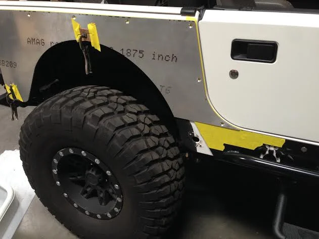

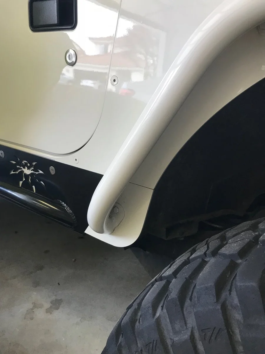

Just to through something else to consider before buying sliders. IF you are considering flat fenders in the future look to make sure everything works together. I went with Poison Spyder sliders which I really like, but they go from plastic flare to flare which was fine until I installed my rear fenders. They fit fine with my Genright Alum front fenders, but when I added the rears there was a space I had to fill in. The Genright rear corners are made to fit up against there sliders which are WWxWW, and the PS are not. It is not like you can not make it work just another step I had to go through. The small black and white area just behind the slider is the area I am talking about
That's a good point!
I don't plan on ever needing full corner/side armor. maybe the short corner guards on the back corners. Personally, I'm looking for ww2ww coverage in a slider, but I didn't even think about how it would play out for someone with other armor already, or went with different brands.
