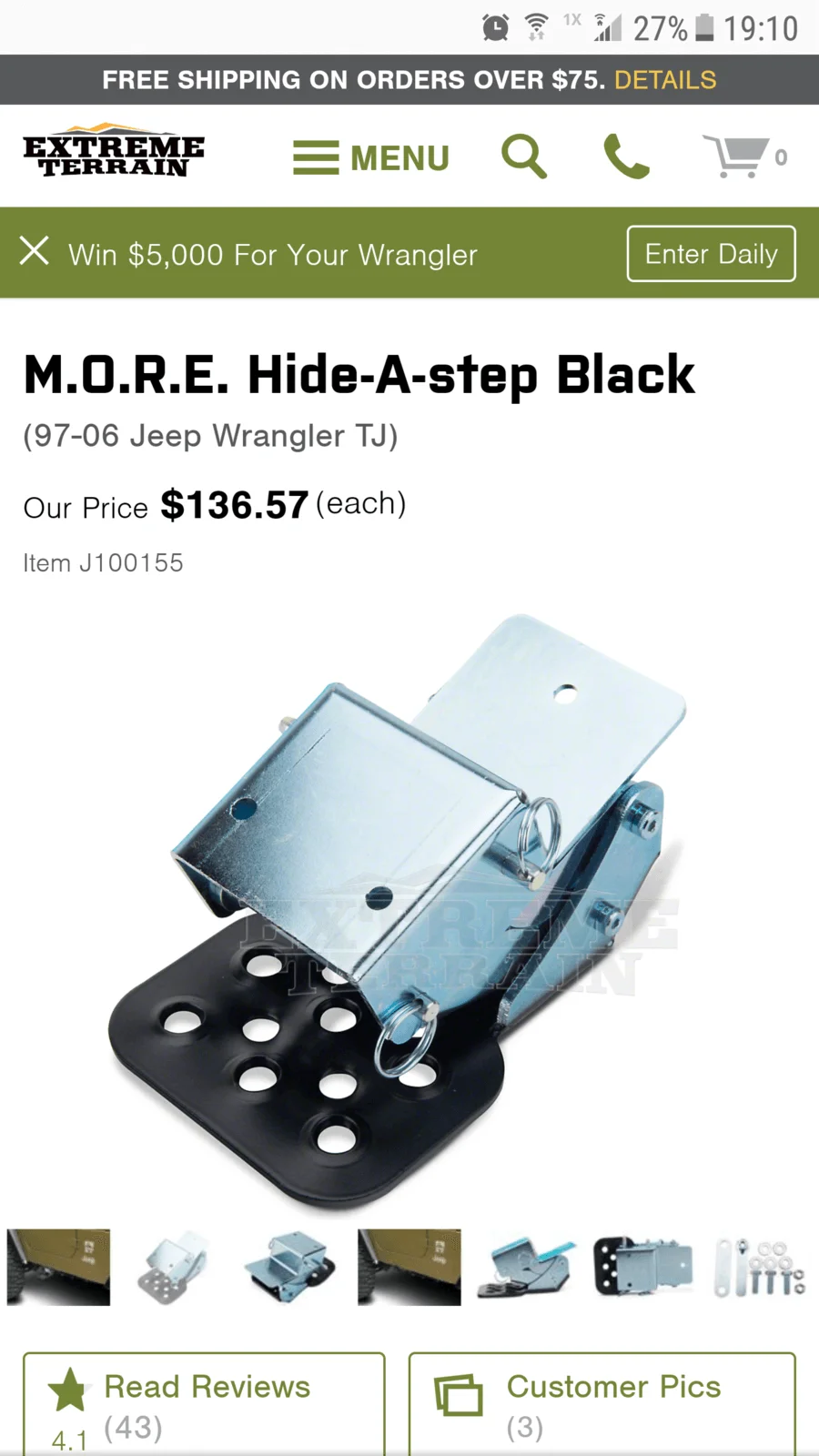

My only addition to this post/ suggestion is to consider steps into the purchase of the sliders. I wanted to put these one so my wife can get in, but cant not cuz of the type of slider i got... i could take them off, modify them... which i may do over this coming winter. Ugh! Lessons learned.

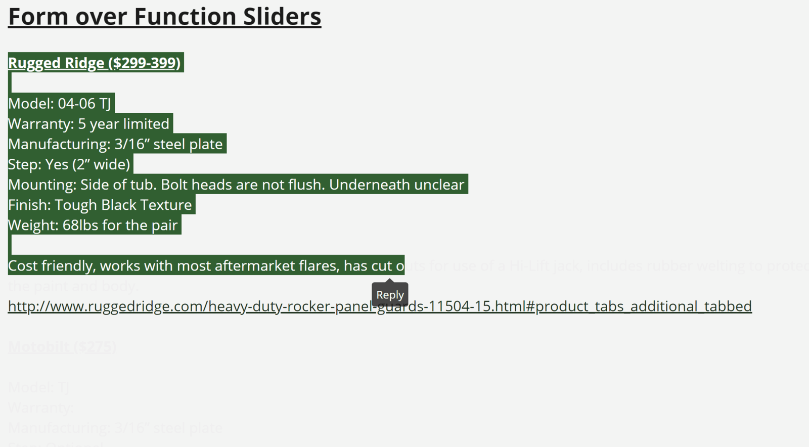

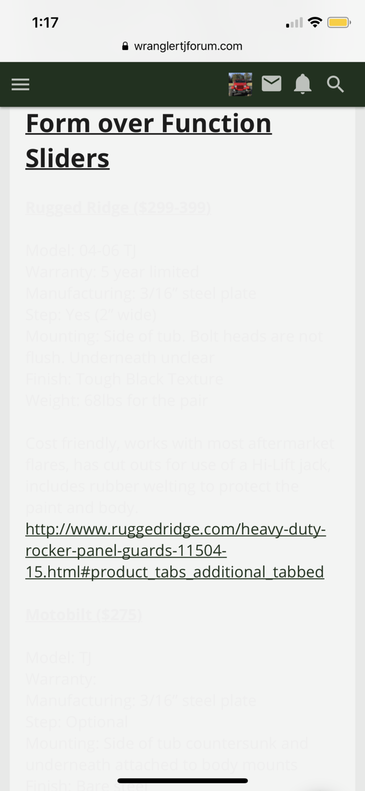

Am I the only one seeing most of the text of this post colored white??
What text is white? The text in the original post, or all the text in the thread?
It's the text in the original post, but only the text under each rocker category. Attached is a screen shot. It's just a little weird, because the text is obviously there because I can copy it (seen in green), but if you take close look it's really faded. No biggie, just a little weird...
Reactions: KennedyLJ
Try it now.
Reactions: JMT and KennedyLJ
Fixed! What did you change? Just curious...techy stuff interests me
@JMT used a really light font color. I'm not sure if this was intentional, or if perhaps in a forum software upgrade something just got wonky.
Either way, all I had to do was change the text color to black, fortunately.
