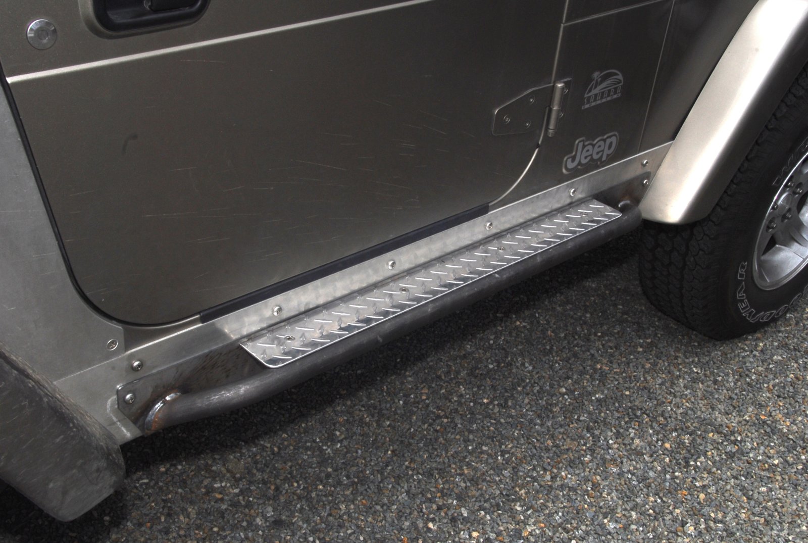

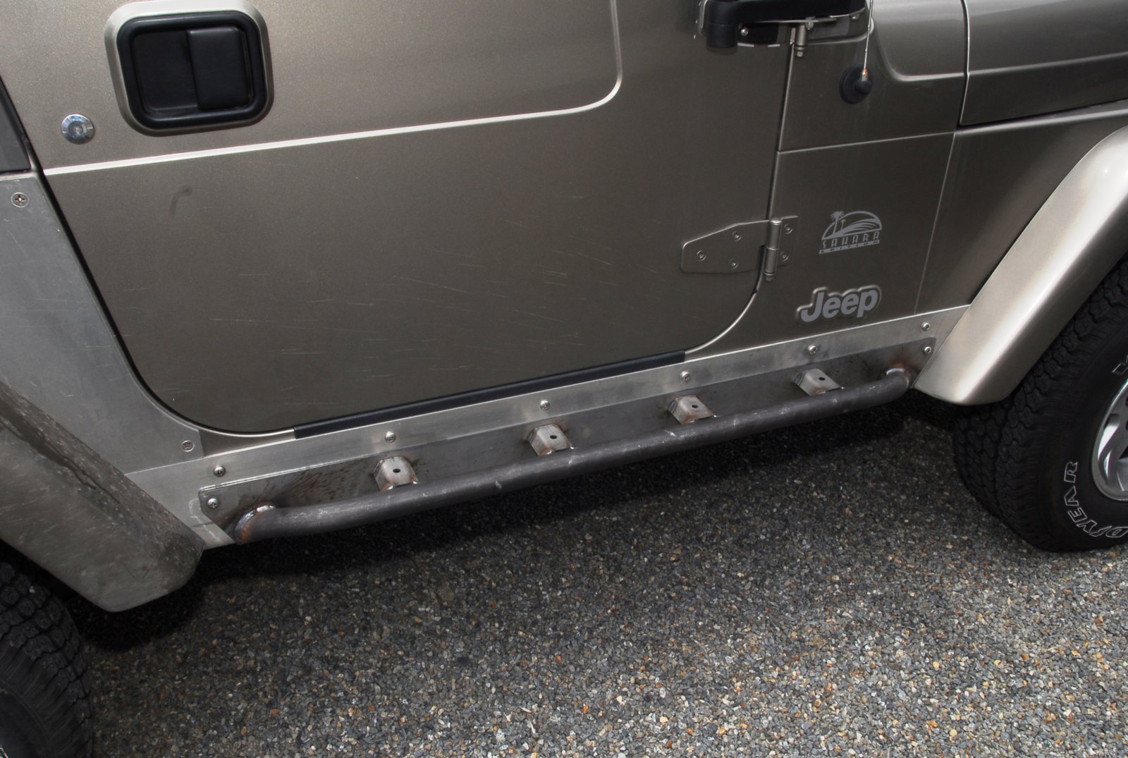

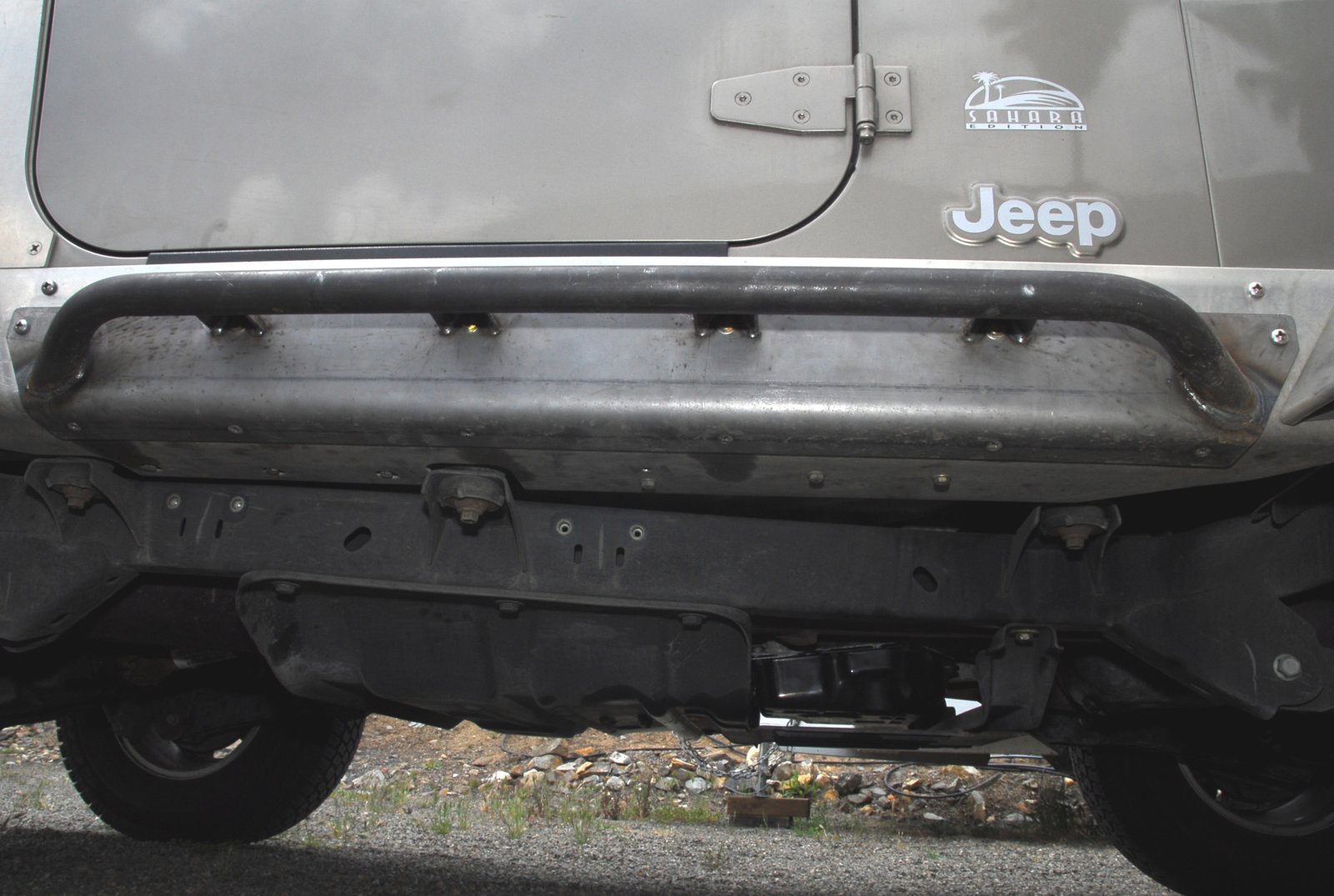

I went through 600+ post waiting to see the two step versions but never did. Regardless if they came into production or not I would like to see what you came up with if you wouldn’t mind. On the website it is called a “step slider” but as you’re aware time is not wasted on pictures. Is the original design still being sold or it one of the designs with a step?
When the Savvy sliders were introduced and how well they worked was being discussed, there was post after post of folks saying "that's awesome but I have to have some sort of a step so they look and work like the rest of the shit out there". No amount of explaining or examples to the contrary would quiet down the insistence on a step. Gerald finally said to build a step with a tube. No problem. I designed a couple, one with a removeable step section so options could be made for different types of steps. There was another and small test runs of each were built. None of them sold. They were all finally given away as promotional items and discontinued.

I've never had any to send out. Sorry about that and I know some exist, I just don't know where to find them. View attachment 83916View attachment 83917View attachment 83918

In that thread it was post after post on a step version so I was just curious. I don’t need a step but the wife might disagree. Thanks for digging up the old pictures.

Thanks for your time and the pictures! Maybe Gerald still has a SS around I’ll ask.
