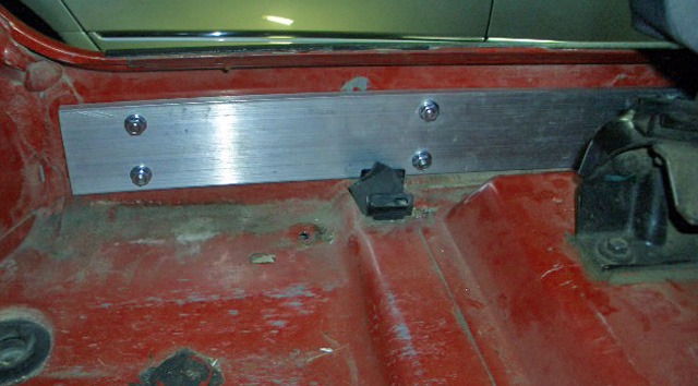

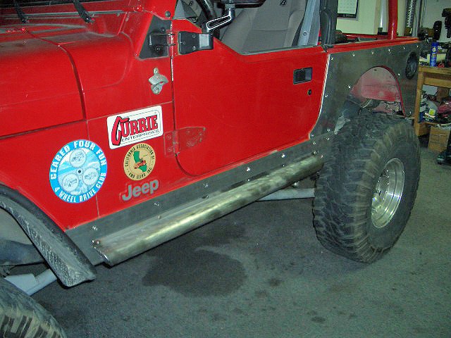

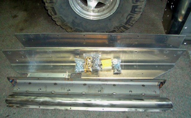

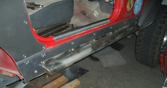

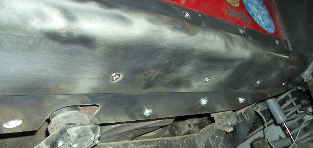

Here are some photos from my previous TJ's install of Savvy's 2-piece (plus an internal brace) slider as designed by mrblaine. It replaced my bent up 3/16" slider from 4XDoctor. Rounded radius on the bottom to make it easier to slide on rocks, 2-piece exterior to allow a damaged rub rail to be replaced independent of the main body, nothing to hang up on the bottom, and braced internally which significantly strengthens it. Aluminum where it can be, steel where it needs to be. No compromise design. Not cheap but if you want the best...
View attachment 30797 View attachment 30798 View attachment 30799 View attachment 30800 View attachment 30801 View attachment 30802 View attachment 30803
I see a lot of pictures of the Savvy sliders bare metal, is the steel slider actually stainless steel?

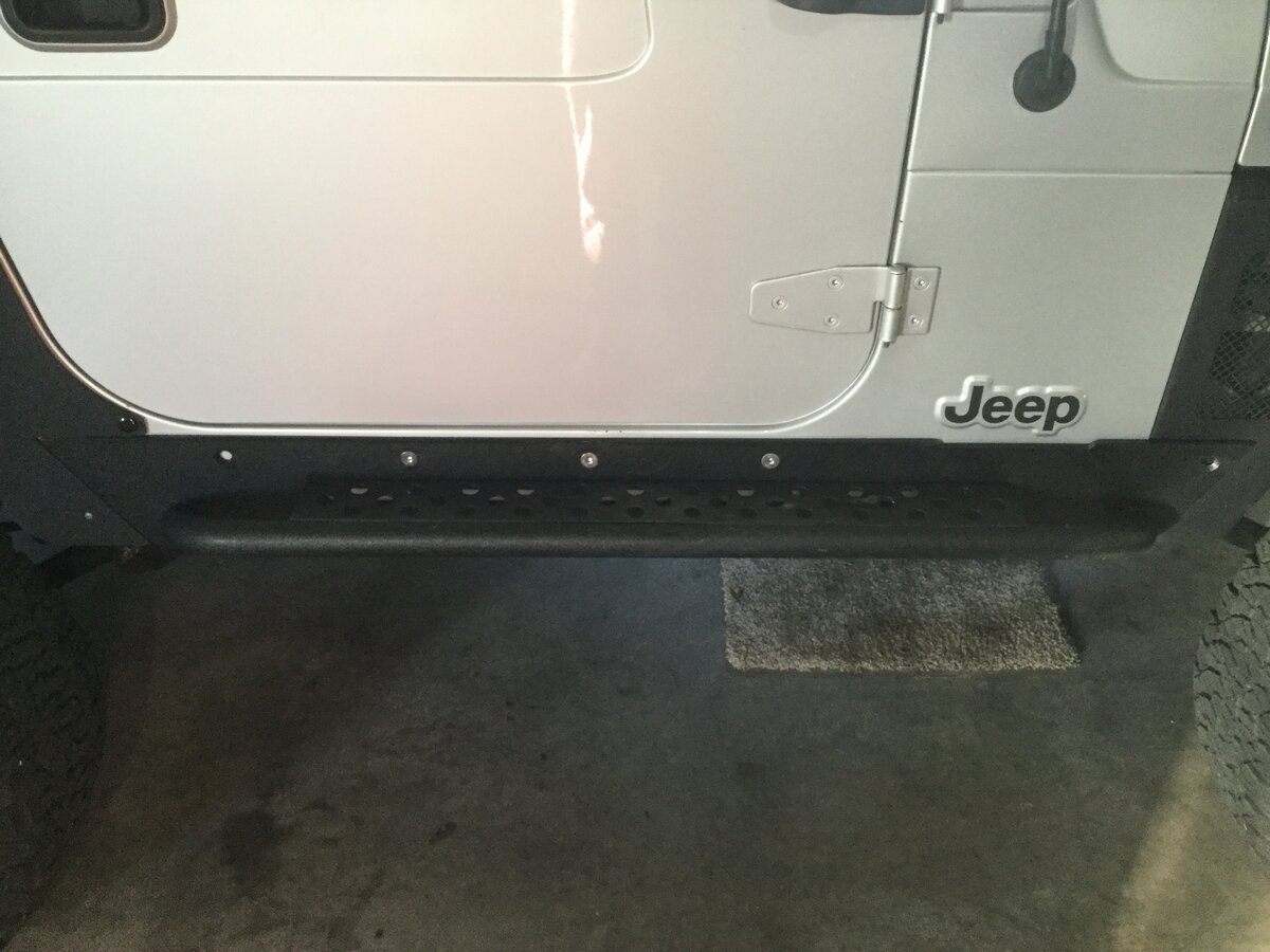

The GR would be much better if they had left them like I designed them and kept that goofy tube step off of them. It makes zero sense to build a high clearance solution for rock rails and then ruin that with a step. So while good, they are not the very best they can be unless you modify them like I did these.

Exactly, I believe we've had this conversation before. The step removed is the best solution. But consumer demand was heard. Too bad because I rarely if ever use the step on mine.

A tube welded to the slider doesnt always equate to it being a step. I’m with you, but a tube welded on the slider can put your tube closer to the rock and away from the body panel.

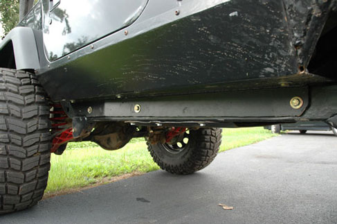

How are the rock rails at fault when it was a bumper hit? Because they tie the frame directly into the body and bypass the rubber mounts?
Because the rock rail mounting system fucks up the relationship between the tub and the frame with uneven loading. The frame and tub are a unitized structure when the body mounts are bolted up. If you can to test that, set the front and rear frame on jack stands, unbolt the frame and watch the middle of the frame sag about 1/2" or so.
Bumper hit causes the body to move. How much it moves is determined by how it is supported.
