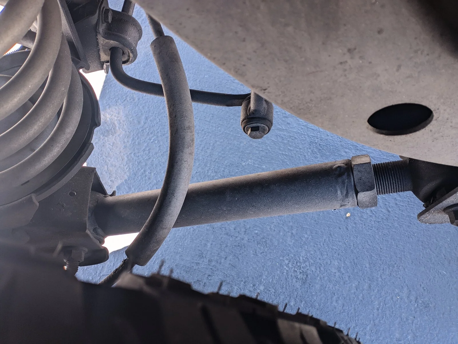

I have a rough country 4 inch adjustable lift. I believe there are 2 kits. The one I have is adjustable on one side of the control arms. There is a lot of adjustment available. This is my first time posting. I am very grateful to everyone on this forum for all the valuable information I have gained here.
I'm 95% sure mine looks like this.
