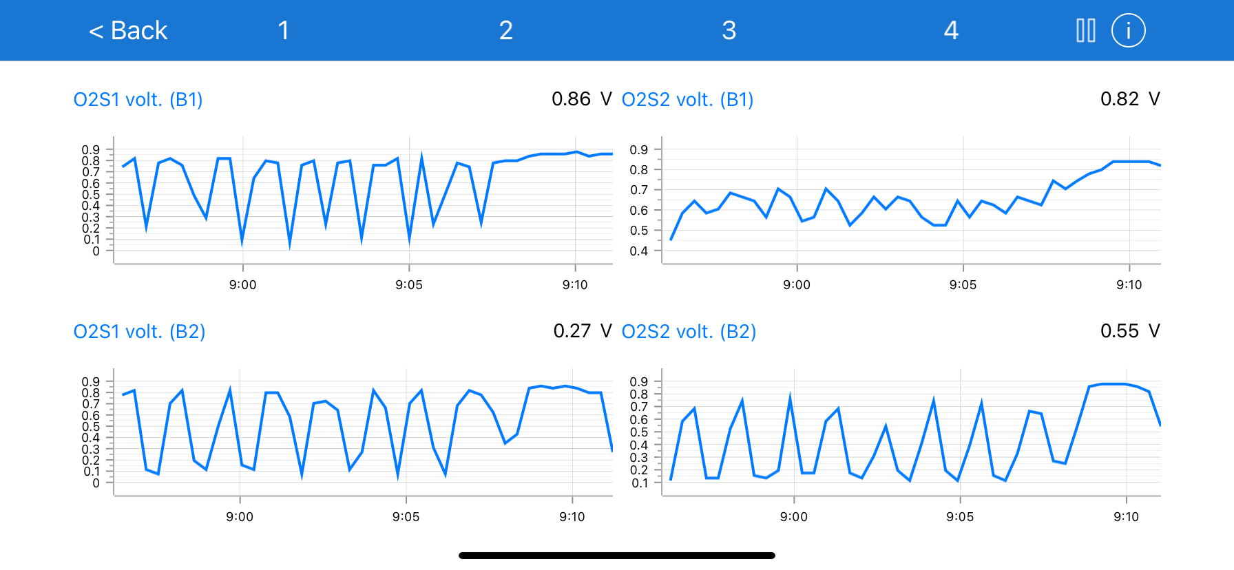

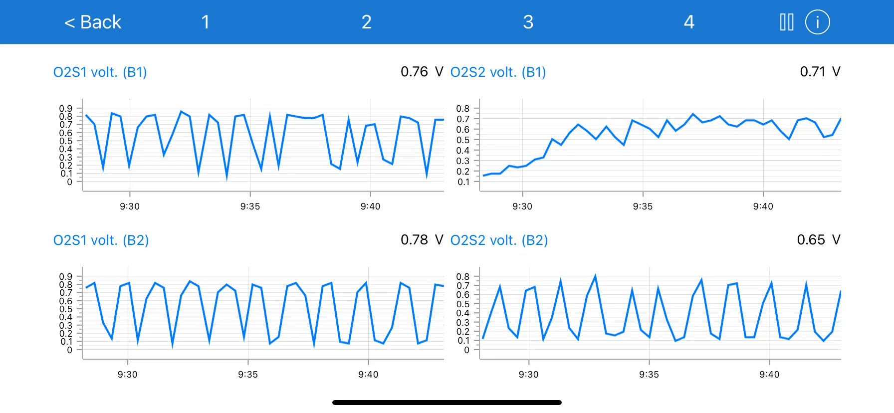

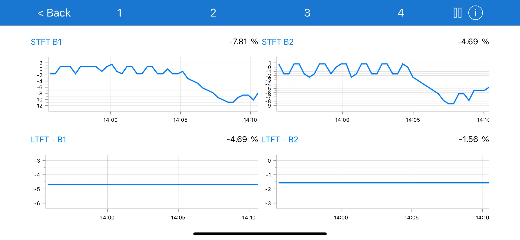

Okay thank you everyone. Here are some videos and pictures of my fuel trims and O2 sensor voltage testing live data. I think my Long Term Fuel Trim is a little low, but not sure what it need to be. Also my bank 1 O2 sensor voltage seems to not oscillate like the others are. Can y'all take a look and let me know your thoughts?
Here are the fuel trims at idle and then I rev up to 3000 RPM and then let off.
Here are the O2 sensor voltage readings idle and then I rev up to 3000 RPM and then let off just like the other test.
Here are a few screenshots from the O2 Senors Voltage scan:

Here is a screenshot from the fuel trim scan:
