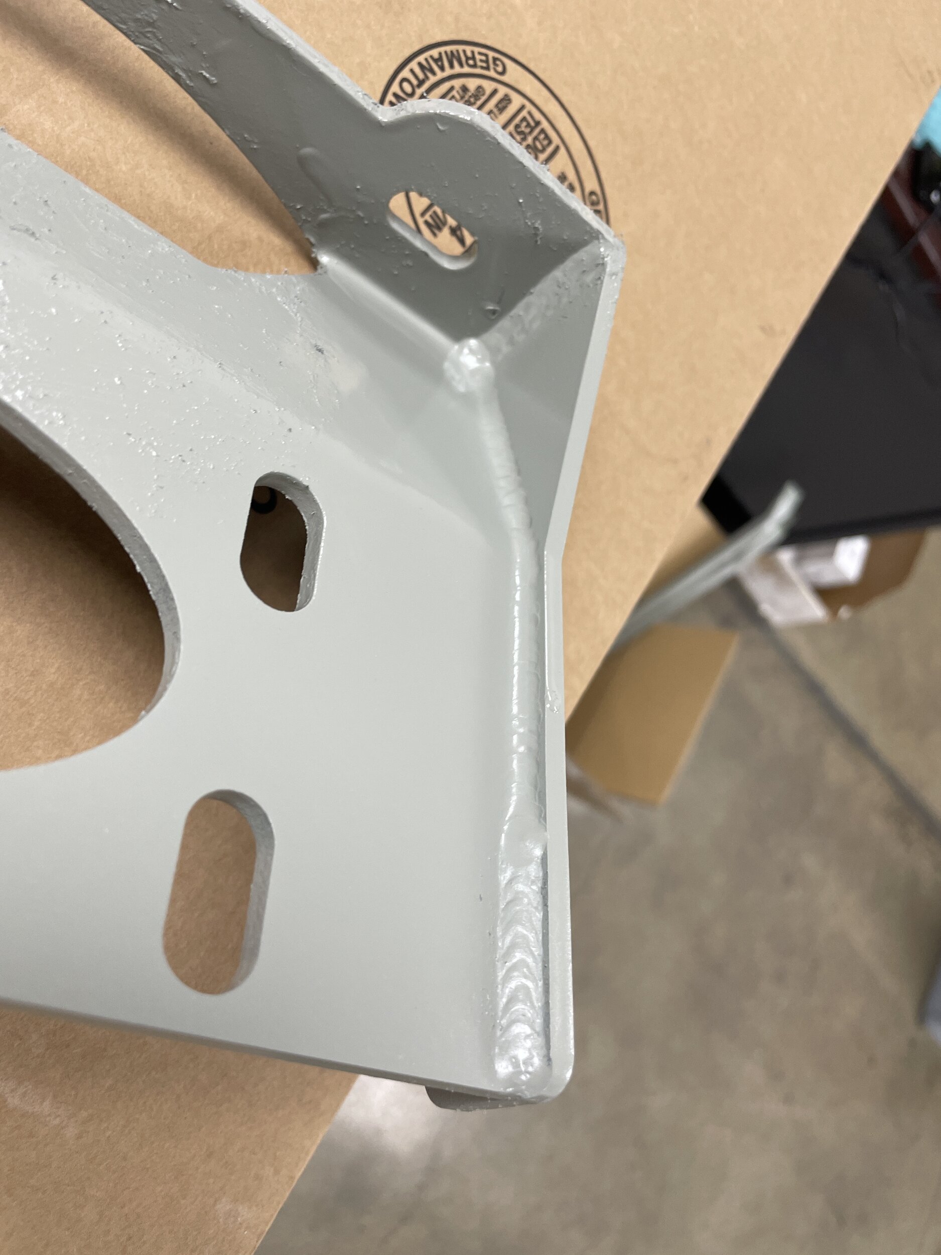

This post has photos of the weld for those of us that grew up looking for books with more photos than words
Post in thread 'Anyone Else Have Contact Between Savvy Skid and Rubicon Transfer Case?' https://wranglertjforum.com/threads...-and-rubicon-transfer-case.66365/post-1231550

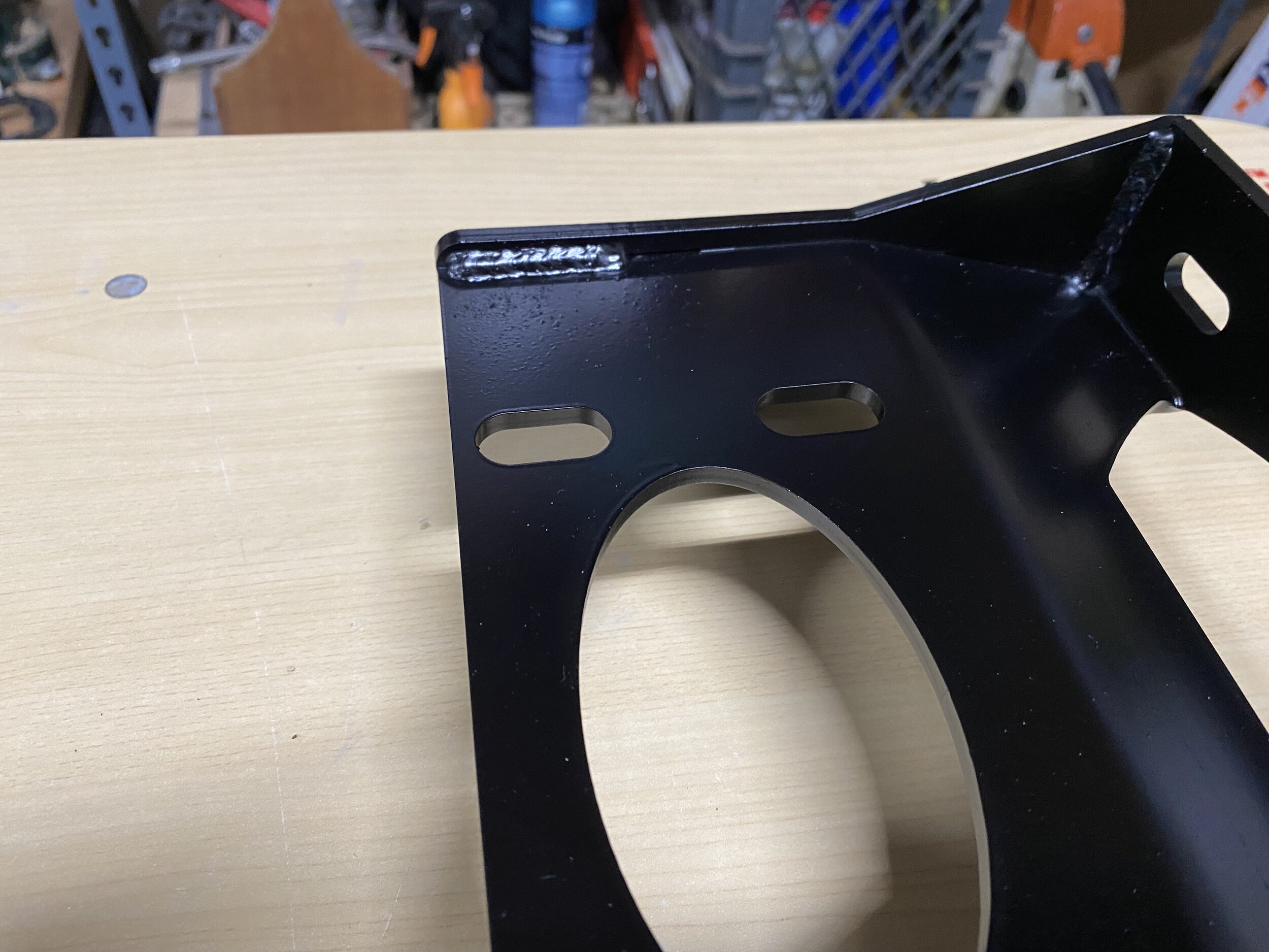

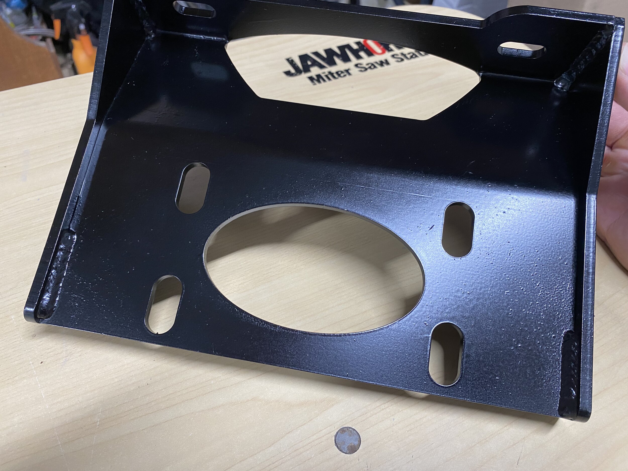

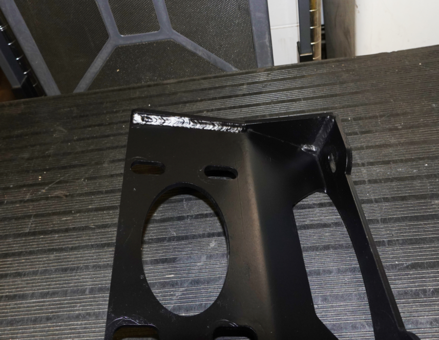

Here’s a few pictures of how mine came from savvy. Minus the paint of course.From Savvy, there’s a weld bead at each end of that seam. I asked a welder at work to connect them.
That's new then because mine from earlier this year doesn't have it.
That’s what I was thinking. I ordered in November but it had already been in stock. Think manufacturing tweaks based on feedback from the field? That would be nice.

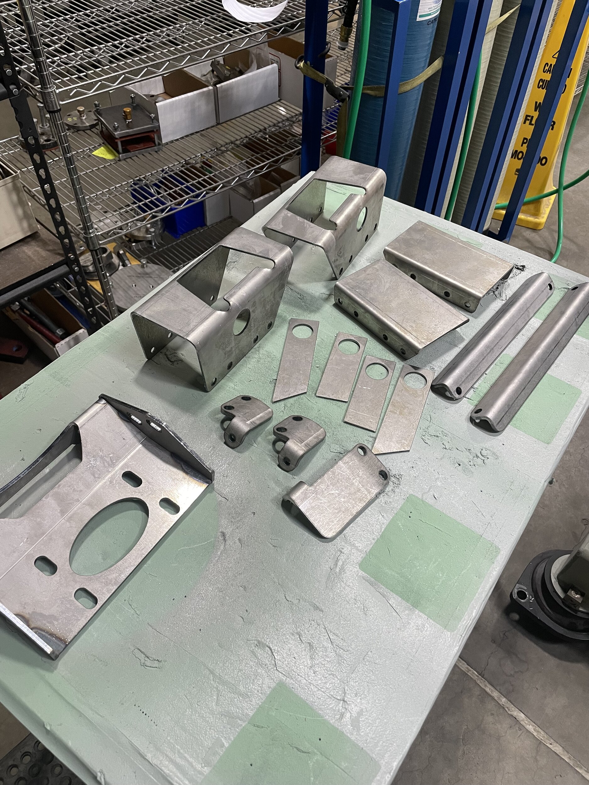

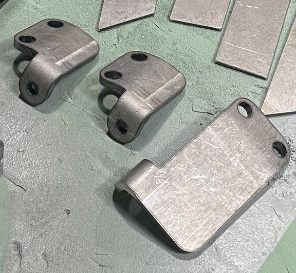

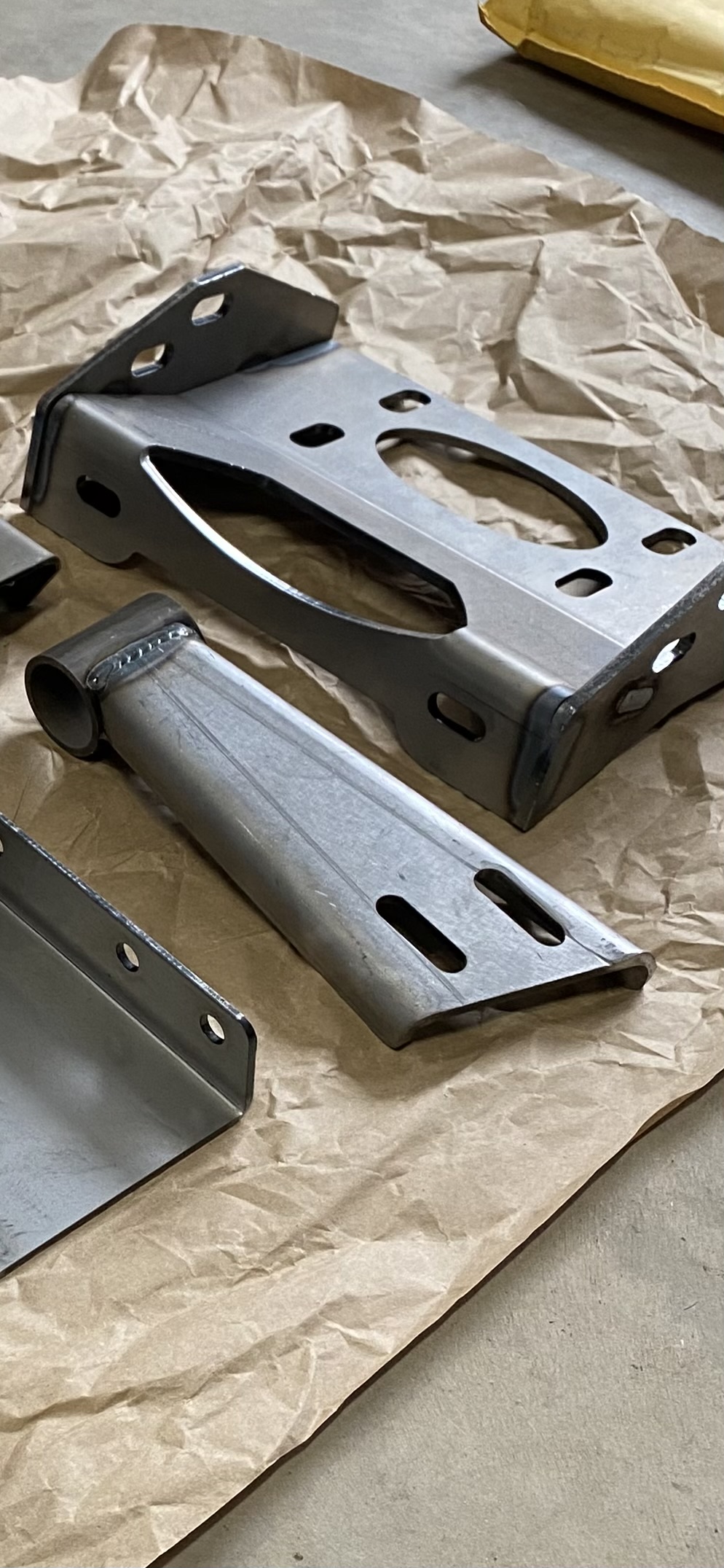

Here is a picture of the hanger. What are those smaller pieces in the middle and the longer angles to the right?
Yes, bolts to the side of it. The combination of slots 90 degrees to each other allows it to be adjusted to a wide range of positions.
.... Is the piece on the right needed for the left engine mount to clear the savvy mid arm upper link?
Correct
