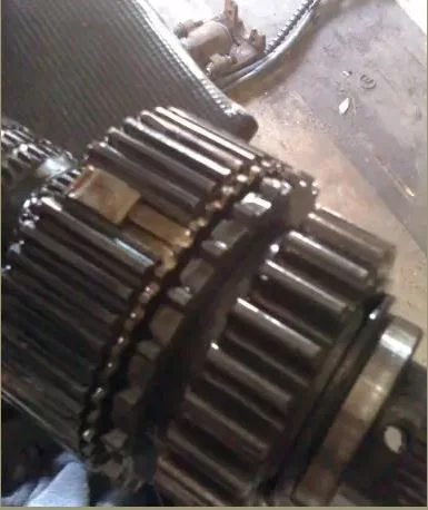

See the brass colored ring located behind the 231's main gear? Well this is called a syncro (short for synchronizer) ring. That ring is made of a softer metal than the actual gear itself, so when your main shift collar is shifted to engage 4WD this "ring" aligns the teeth while everything is moving.
It does also depend on the front driveshaft being in 'synch' with the rear but there are several synchronizers within the 231. I know if my front hubs are unlocked my transfer case will grind if I try to engage 4x4 while rolling, it's a good reminder I need to get out and lock them. :)
