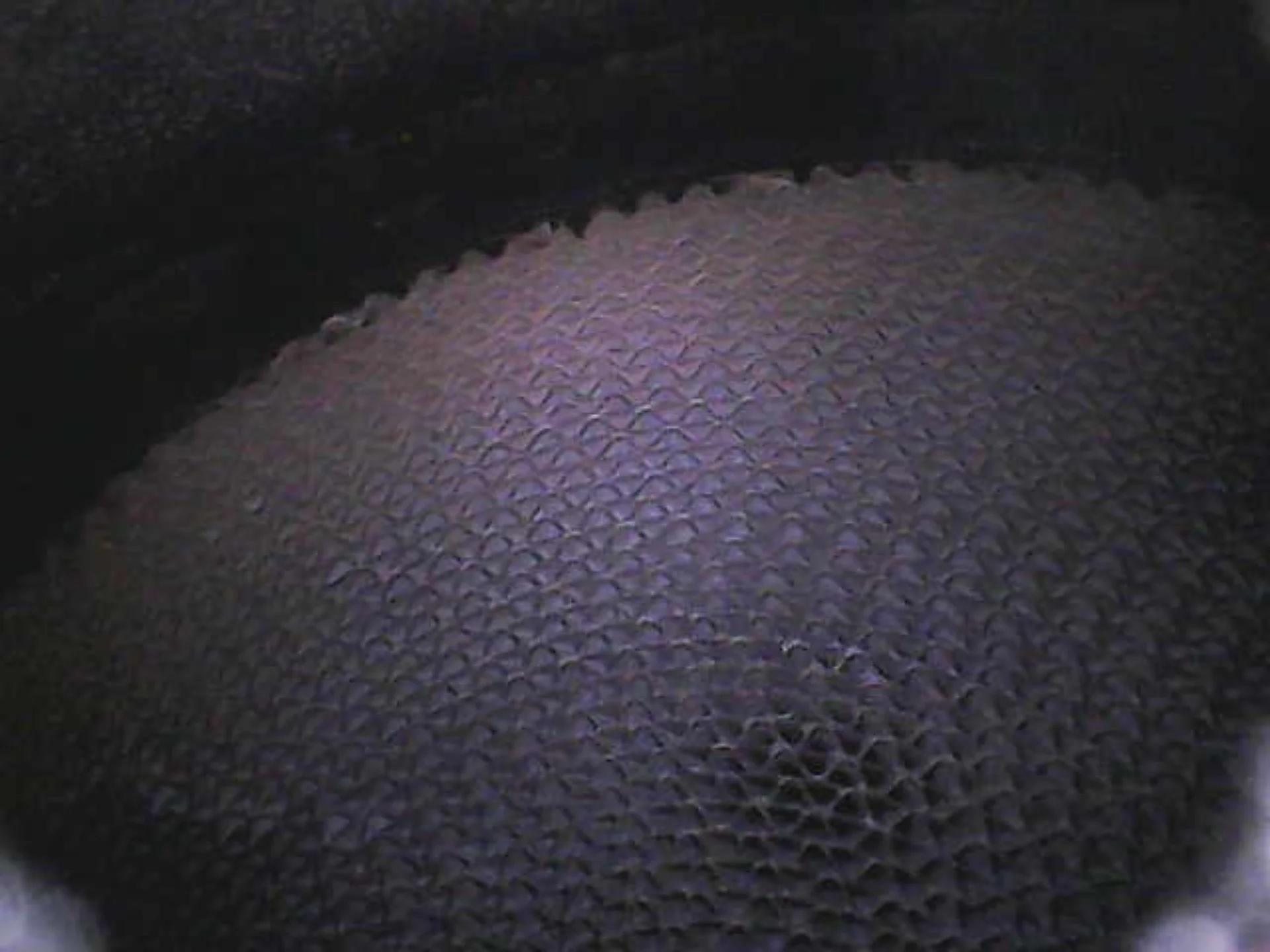

  1. Plugged cat testing - I’ve test driven the Jeep with the O2 sensors unplugged and separately test drove it with the lower half the exhaust disconnected at the intake manifold.
  2. Plugged cat inspection - just to double check I fed a wire cam to look at both cats, they look fine to me.

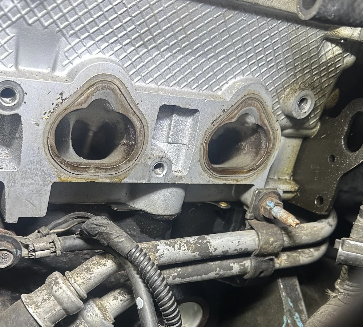

Decided to pull the intake manifold off while I wait for my compression tester. Looks like my head gasket is leaking on both sides of the block…
Well with the intake off you're only a couple of hours away from swapping out the head gasket...I used a Felpro set (on a 4.0) and checked flatness with a good straight edge. I used copper gasket spray for extra insurance in lieu of quick and available machine shop work.
Good find!
Might want to do a compression test and leakdown test. If you pull the head and you miss needing valve work or rings you'll be kicking yourself later.
Good find!
None of this is terrible to do.
