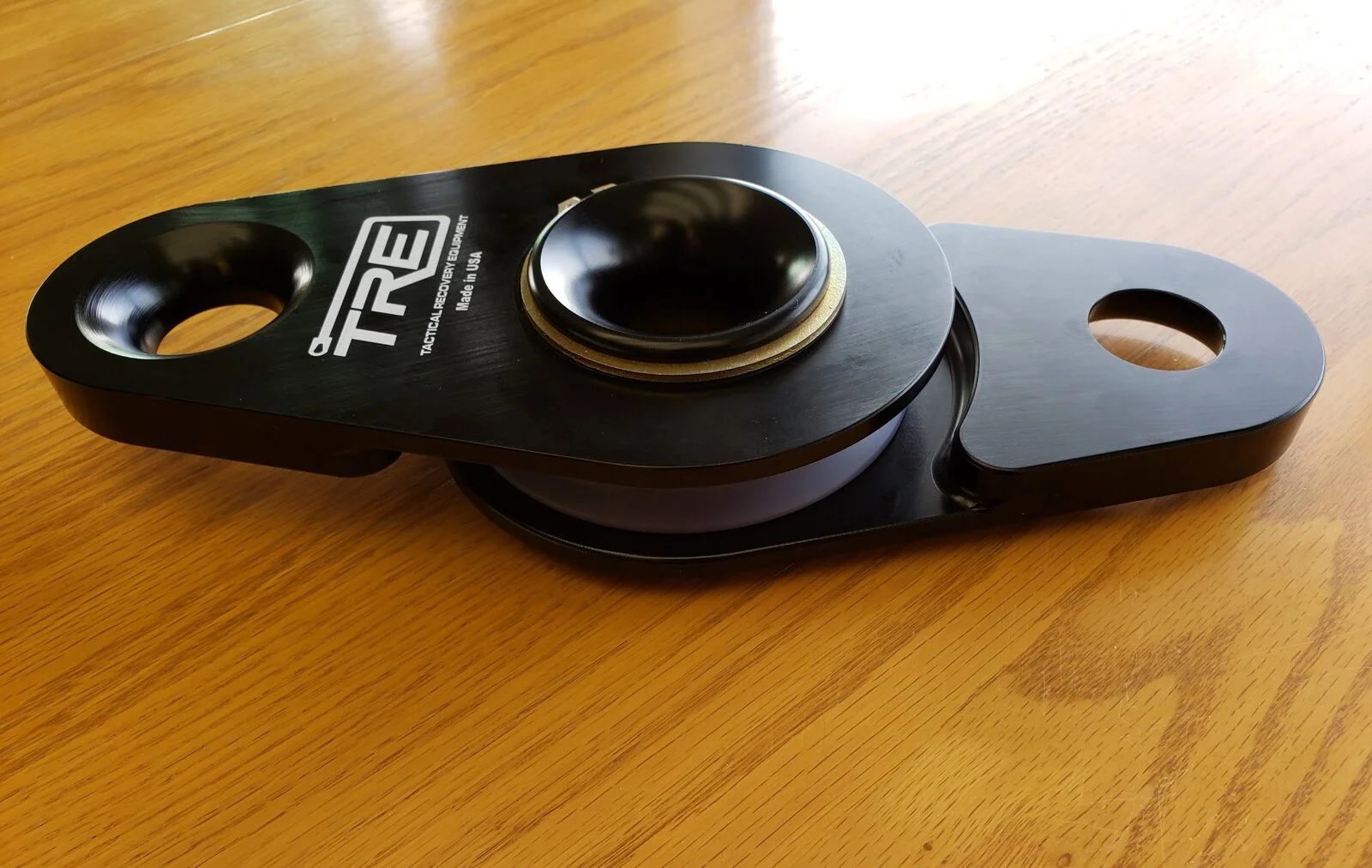

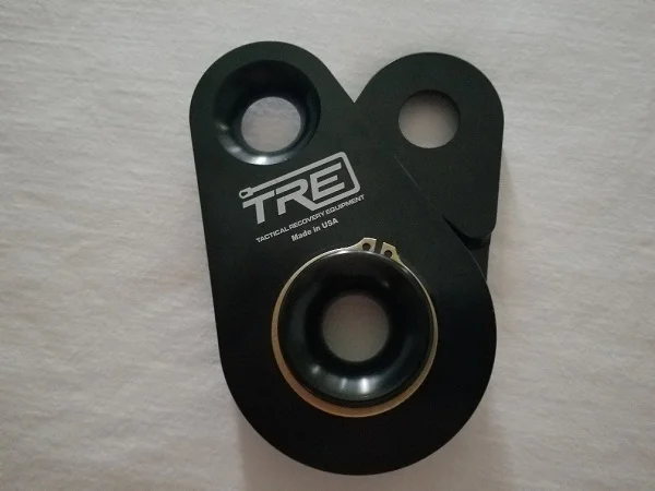

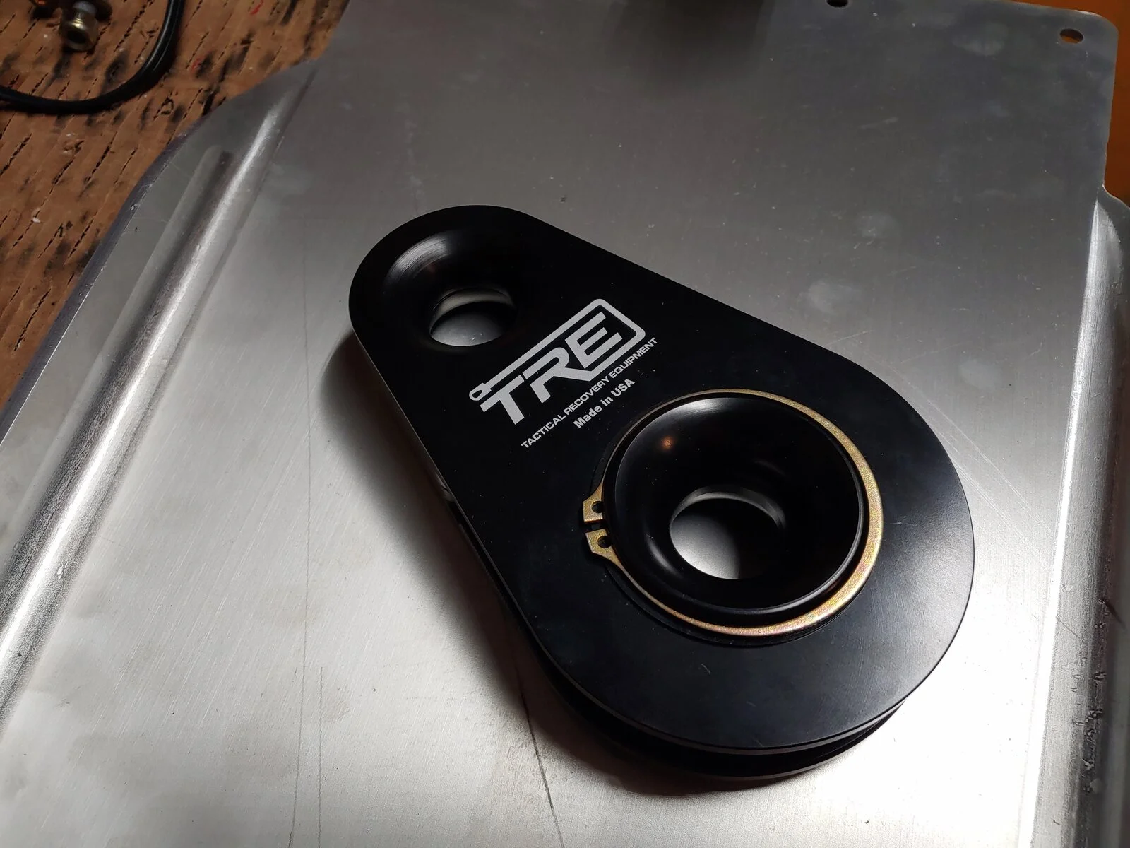

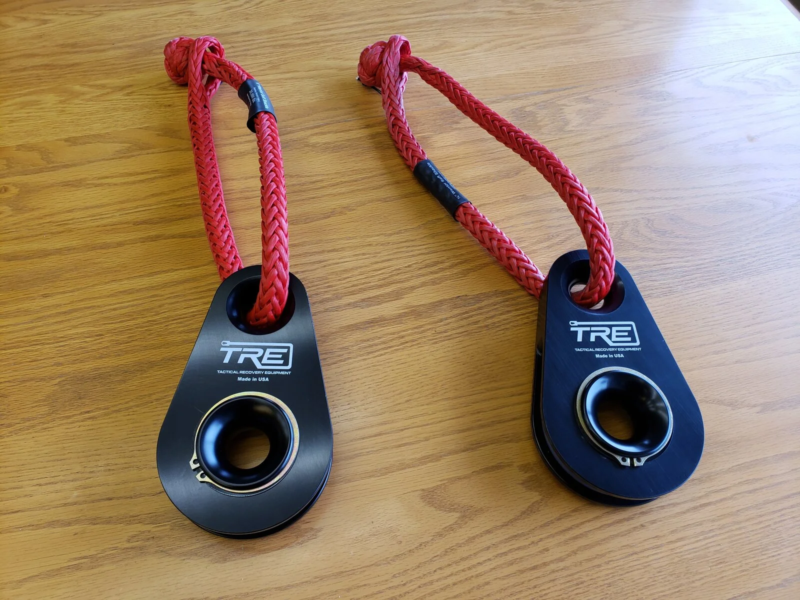

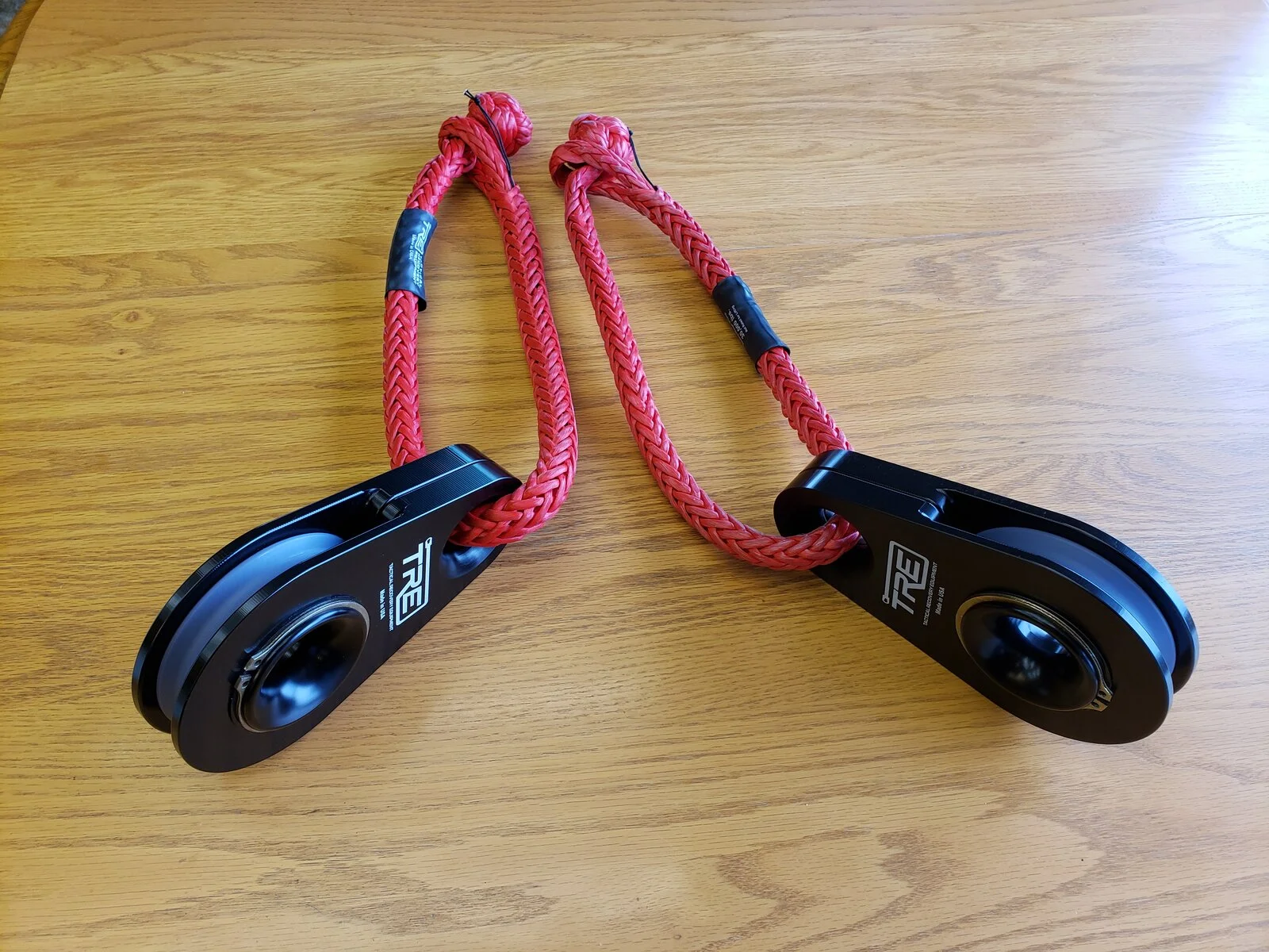

almost too nice to use (like the rest of my TRE stuff)
They're Purty all right!

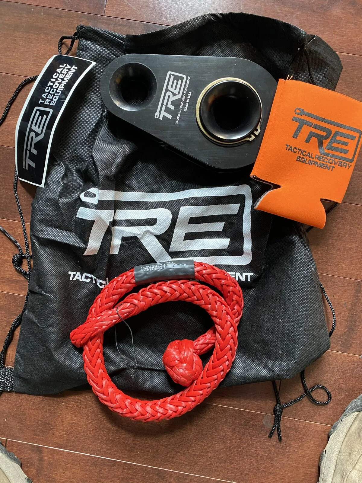

Edit: I can't say enough good things about these Snatch Blocks as well as all TRE products. I've added pictures for anyone that's on the fence. In my opinion you're getting a fantastic product and certainly getting your money's worth.
I got rid of my Warn snatch block and bought some TRE stuff a few months back. I haven't actually used any of the TRE stuff yet but it does seem to be high quality. The snatch block is certainly a lot lighter than the Warn one I had before. I like keeping things light so I'm happy.

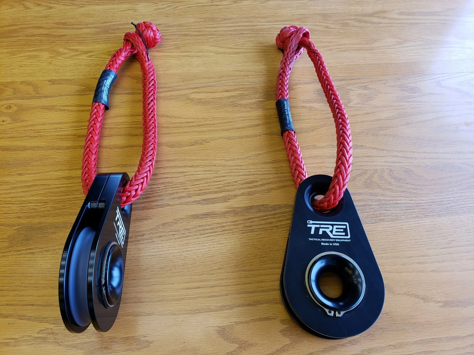

What do you guys think about the tree saver soft shackle from TRE? It should be plenty strong, no questions there. If one has a safety thimble, they should be able to directly connect to the tree saver shackle, right? Wouldn't this be the most "minimal" connection possible like @jjvw always emphasizes? I guess one negative is potential damage to the tree/bark since it's not a wide as a typical tree strap.

I have one and while I have never used it, I have no doubt that it will do no damage to any tree that I hook it to. It will also hook straight through a TRE safety thimble so that the only attachment you need for the winch is the tree saver soft shackle itself. Much safer than any steel shackle in my opinion.

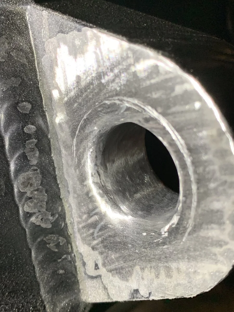

Savvy front bumper so no issues there. Rear, I have a hitch and tow strap/soft shackle though hitch with a pin should be good, no? I do also have typical recovery points in the rear as well, and I need to take a file to them sometime to do this (I had this saved from the forum from an old post):

That is actually a picture of my personal Genright rear plate bumper. Anything of the sort is close enough. Some people have done less and achieved similar results. A hitch with a soft shackle around the pin is good enough assuming that the soft shackle isn't forced against any sharp edges. As long as the end of the receiver is dull enough for pulls that involve a significant angle, you should be good. Even a stock receiver is good enough for that but smoothing it out can't hurt.
