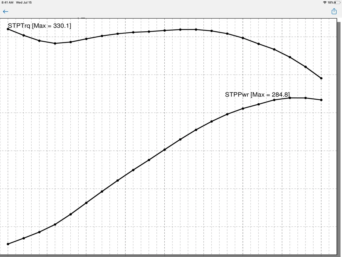

Yea, got a phone call from Chad this morning, it almost feels like Christmas my engine is ready to ship and Chad sent me the Dyno results for my Stroker looks better than promised, 330ft#’s torque and almost 285hp.

Seems like a stout engine. rpm ranges would be nice to see as well.
Crank numbers, but impressive nonetheless.

Yep, what matters I guess is how it is on the road/trail, the added power whatever that is in the end combined with going from 4.10 to 5.13 gears should be pretty noticeable, at least I hope so anyway. What’s typically claimed in the auto specs? Crank, wheels or axel?
Manufacturers always report HP at the crank. The TJ is reported as having 190 HP stock, but when you dyno them on a conservative dyno (a Mustang dyno, also the only one I would trust), they come back around 150-155 HP at the wheels, which is accurate, as it accounts for drivetrain loss.
So with 285 HP at the crank, you should be putting down around 245 HP at the wheels, which is still REALLY damn impressive to say the least. There's no possible way you won't be grinning ear-to-ear! That's almost a 100 HP gain at the wheels over stock.

I think crank dyno is the only way to really get a reliable apples to apples comparison across vendors since there's many different transmission and transfer case combos. Even then there's variation, but it's closer than at the rear wheels dyno.
