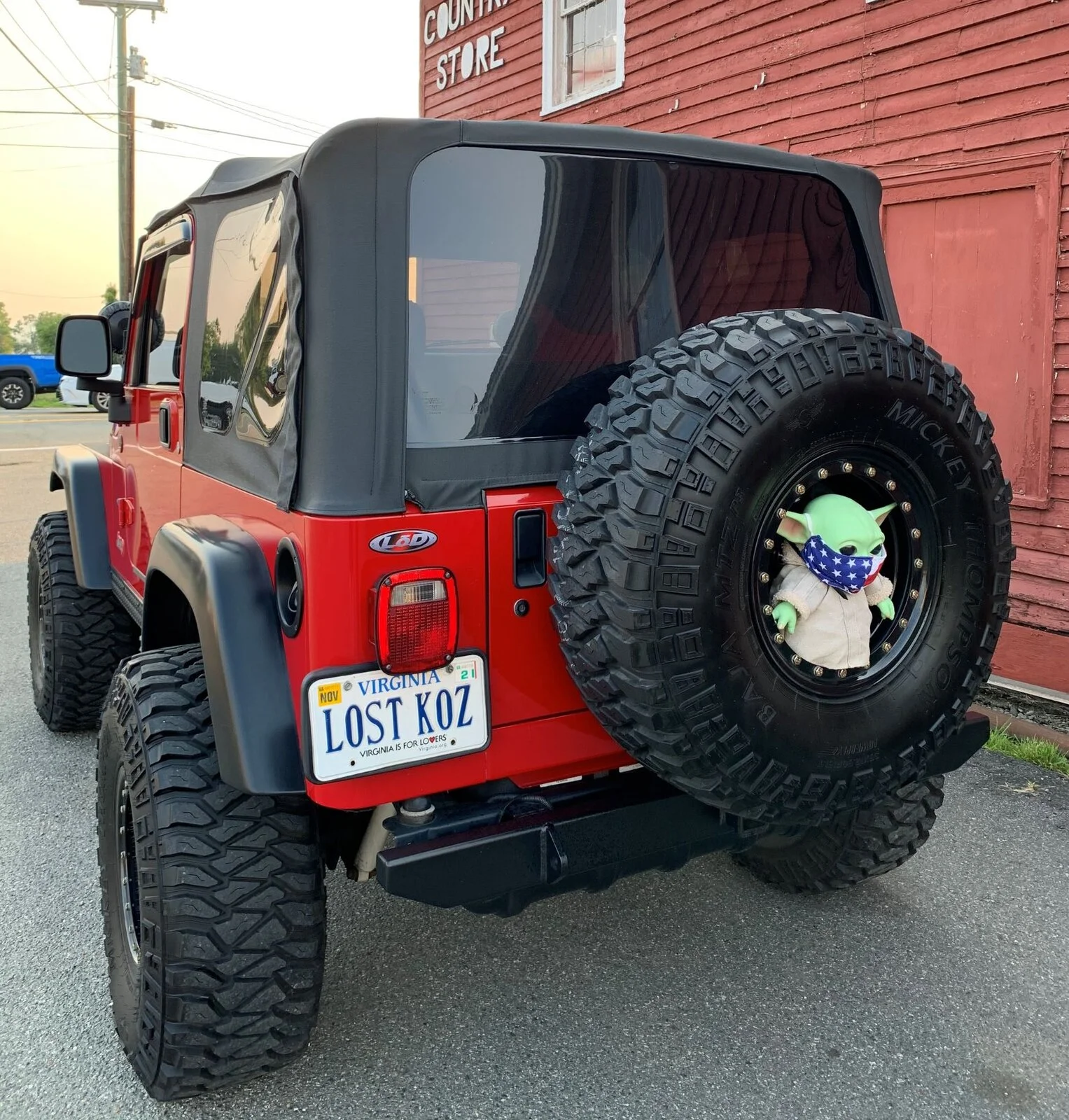

Stock carrier. Works for my 35" spare.

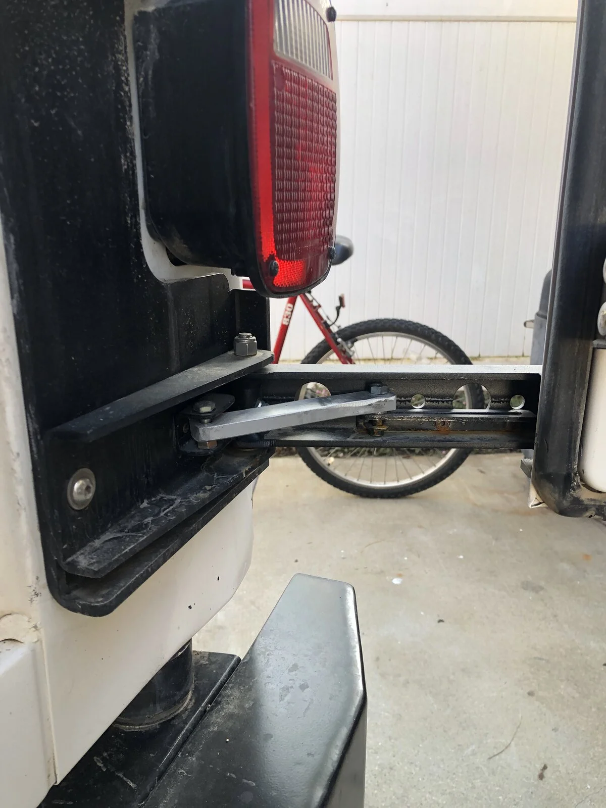

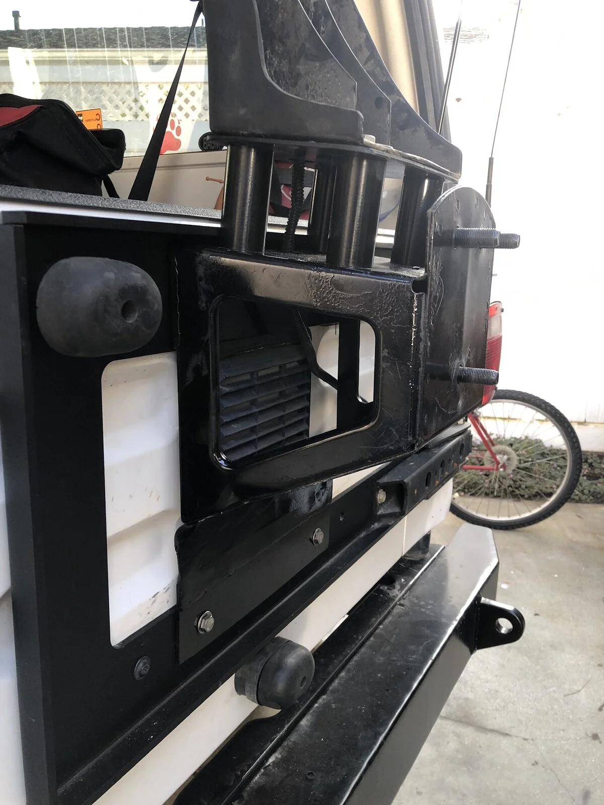

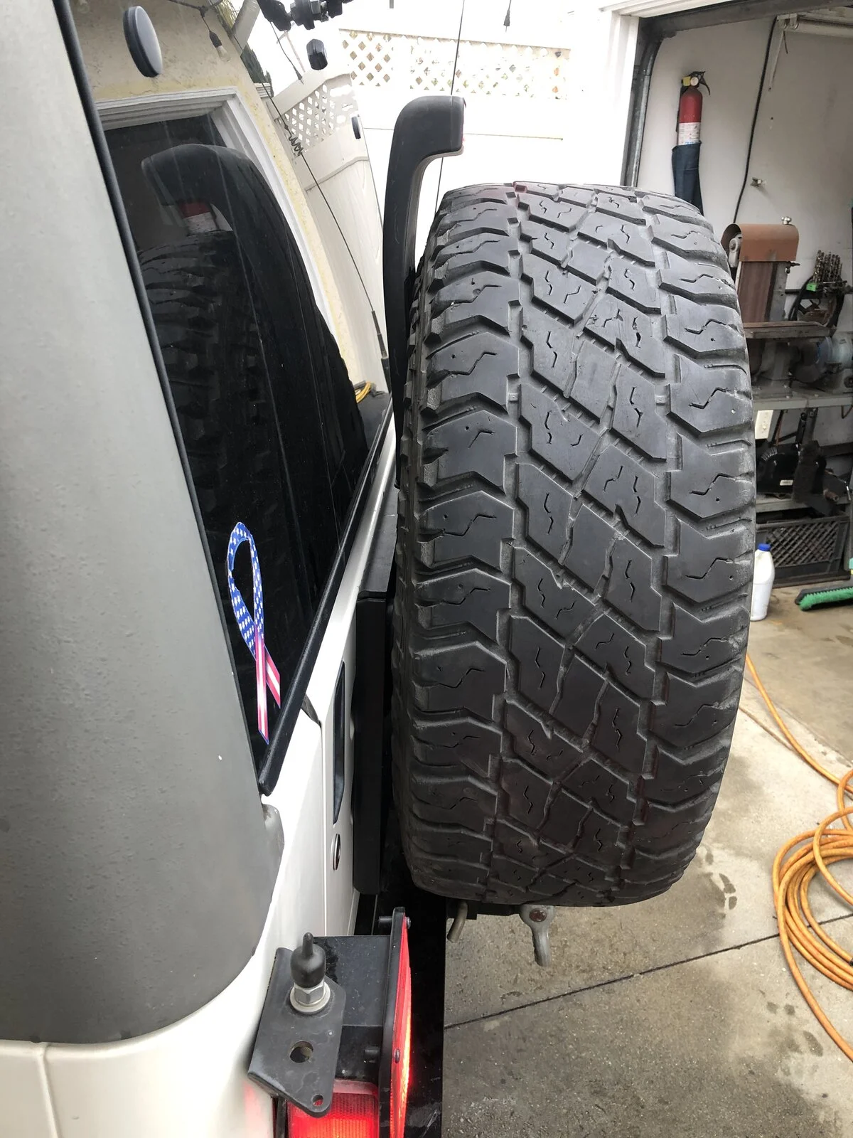

I installed the moryde tailgate reinforcement and picked up a rugged ridge mount. I did not like how far it was away from the tailgate. I found a stock mount with third brake lite on offer up. I didn’t like the brackets with the moryde that pushed this out and up. I cut the 1” lip off the top of the stock mount that the bolts go through. I welded a piece of flat bar below this then welded flat bar to the bottom mount. This raised the mount as high as it could go in the moryde reinforcement. I adjusted bumper length to hit the tire. The brake light extension is just a flat piece of Abs plastic and 4 pvc kippers cut to length. I am happy with the way this came out and can tell a difference with the tire not hanging way of the back. I also fabricated a latch to hold the tailgate open while on a incline.

Show us more on your bracket you made to hold it open

I will have to do a Thread on this when I get home this was the only picture I have with me. The angle bracket has a keyhole slot in it, when the gate is opened the bracket drops into keyhole then you lift it up to close it. It all fits inside the hinge.

That looks pretty awesome. It’d be nice to keep the tailgate off my back if I park on a slope.
