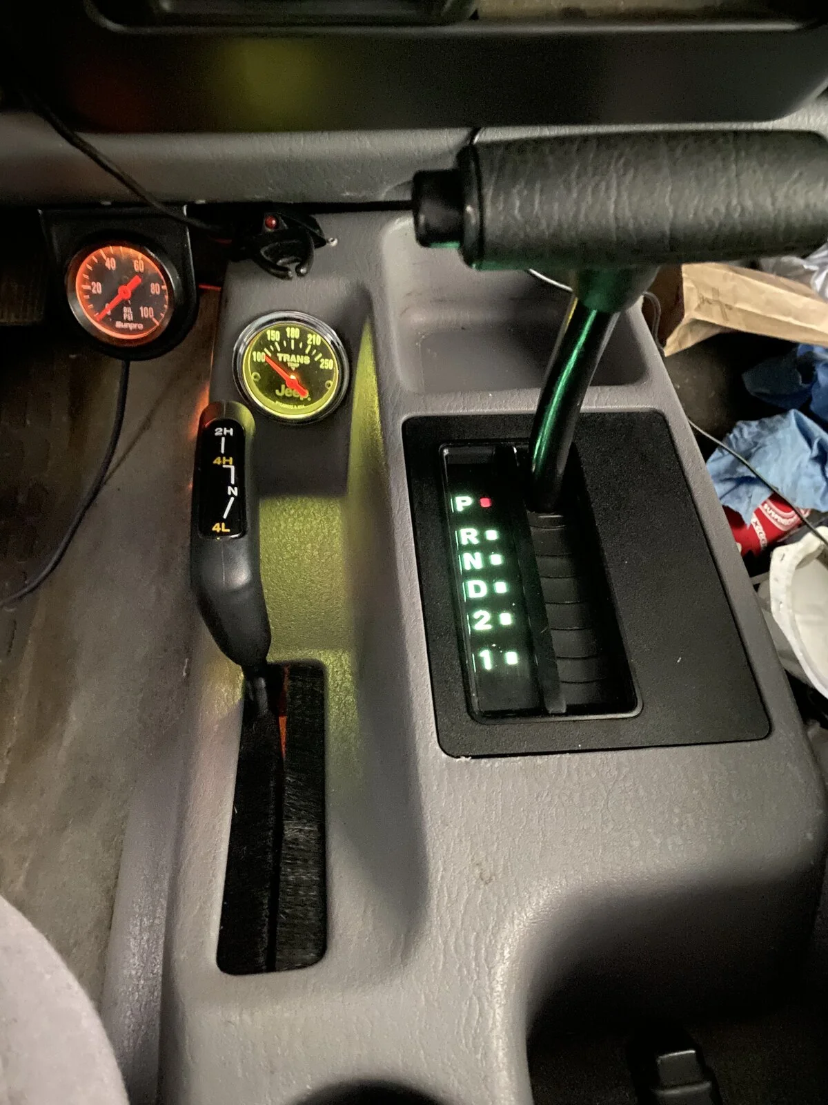

Well things are looking different around the Jeep. It doesn’t look like much but getting thing just right takes hours.
tomorrow :
ATF, and figuring out if I have the right transmission mount and rubber mounts too
