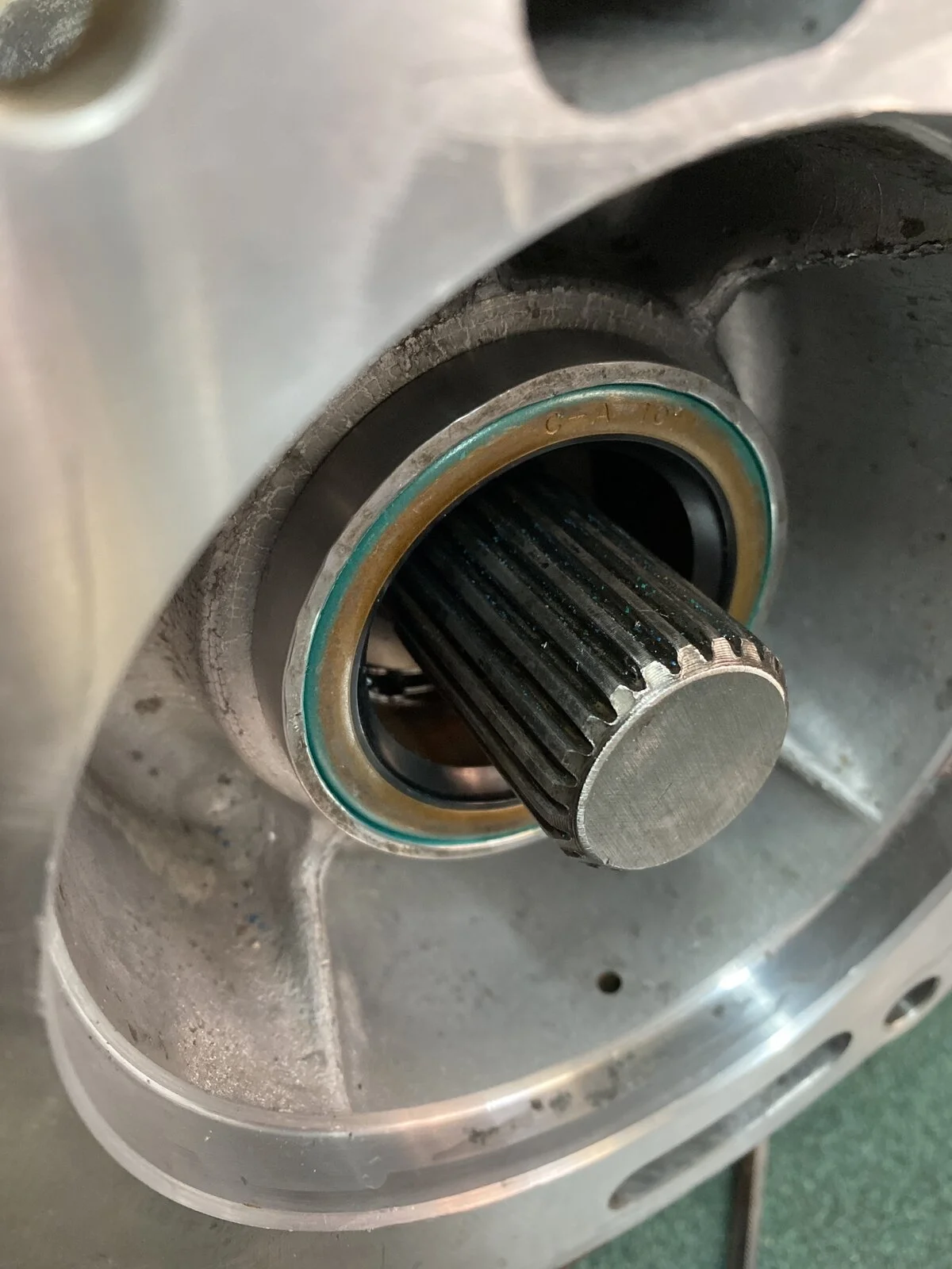

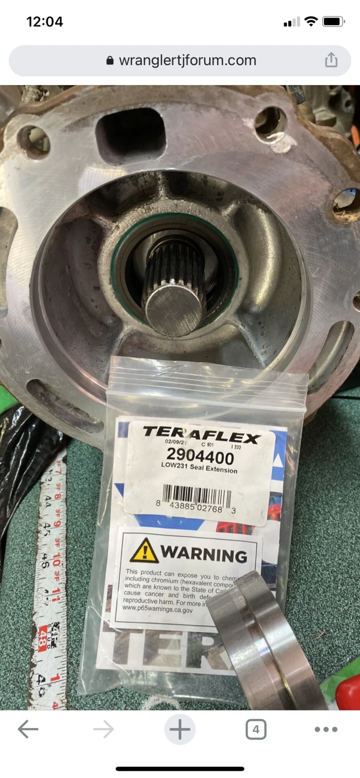

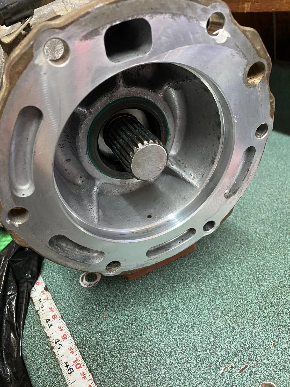

So I have the teraflex extension ( 2904400) seal for the output shaft of the transmission. I just can’t grasp the right tool to use to install the seal ?? Ball-ping hammer and an aluminum 1/4” square stock. Ya can’t use a seal install tool.
I was installing that, I would try to find something round that will fit around it and I can hit. OR, if I couldn't find anything in the shop like that. I would use a hammer and a large brass drift. Brass because I wouldn't want to dent it. Your aluminum idea would work, I might try to use a larger chunk of aluminum. But, you may be able to get it done if you work slowly with what you mentioned.

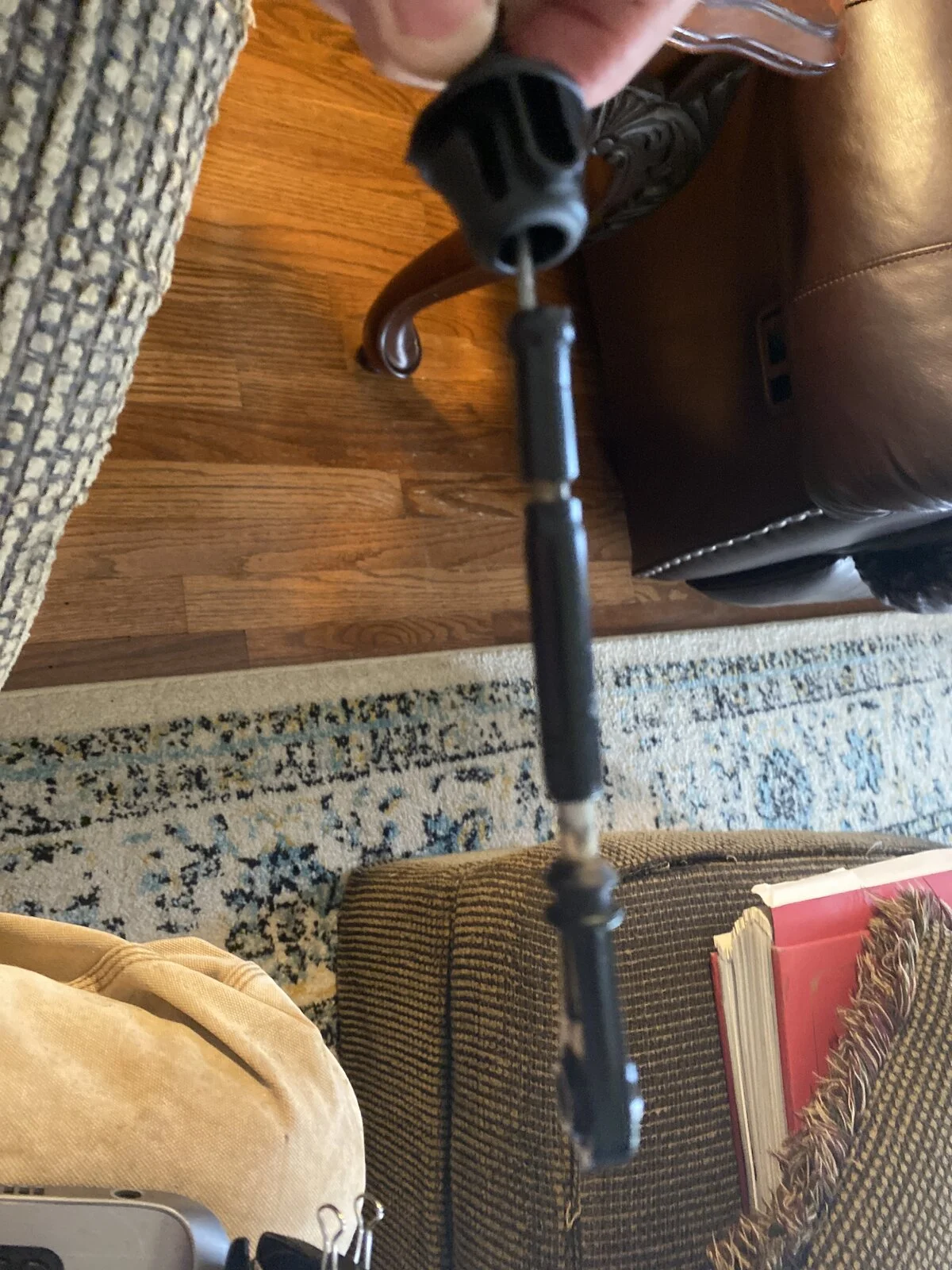

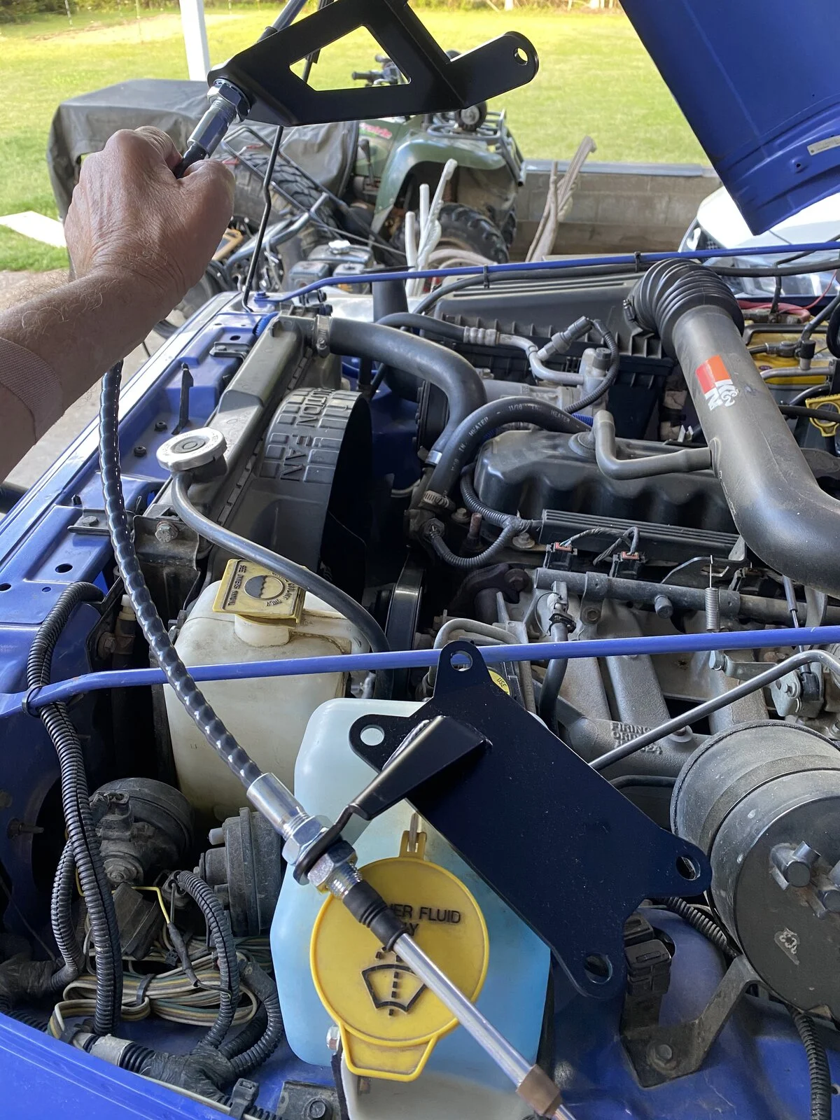

Hey , I’m back to this now. Are you sure this fits the 2002 / 32RH trans
It should! All the TJ 32rh dipsticks will fit.Hey , I’m back to this now. Are you sure this fits the 2002 / 32RH trans
