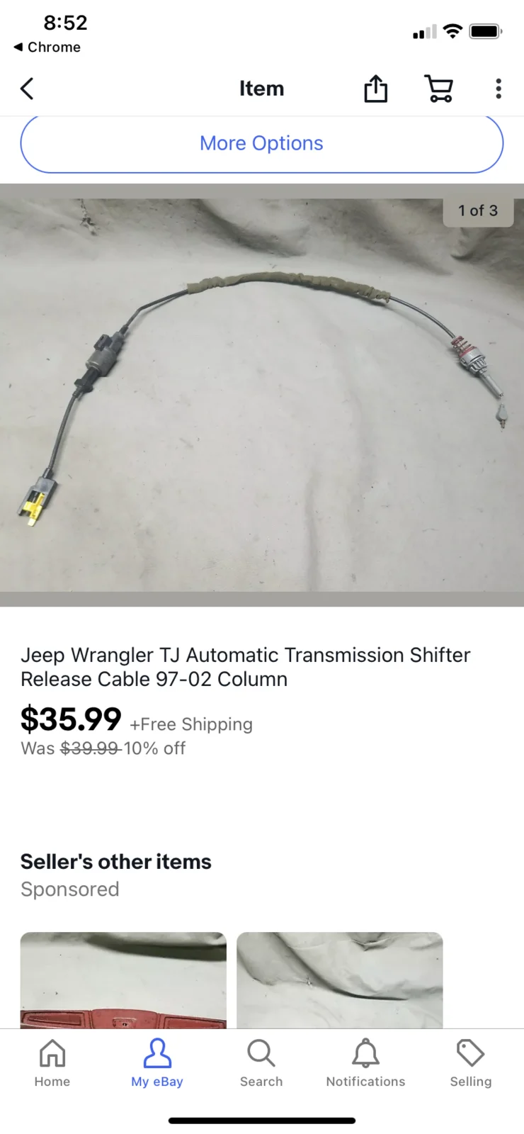

That is a shifter cable. If it is a shifter cable for an a 97-02 TJ then yes you need it.

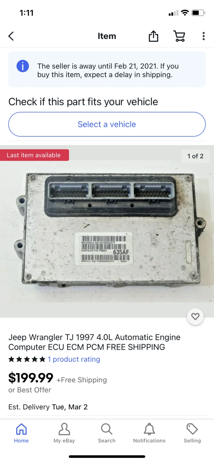

So on the pcm / Ecm / computer. For a 97 tj 4.0 w/ automatic , what should I expect to pay ? And are there companies that make new ones or are the OEM the best to look for ?

a guy has a pcm for a 97 Jeep Sierra and had a 4.0 and a automatic trans.
my jeep is a 97 tj sport 4.0.
would it matter if my jeep was not a Sierra ??
