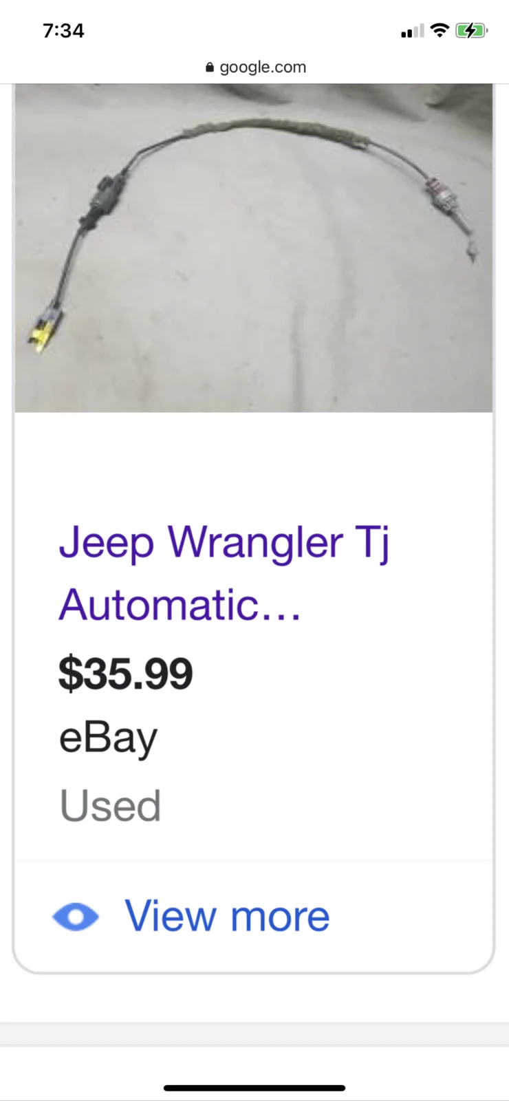

Thank you !!! I saved the picI posted the picture so @starkey480 didn't have to. It was simply so you could see what one looks like as it seems there are some incorrect ones floating around as imposters.

Yep. I didn’t know what it looked like when I bought mine off eBay. It said it was for a 32 but was really for a 30I posted the picture so @starkey480 didn't have to. It was simply so you could see what one looks like as it seems there are some incorrect ones floating around as imposters.

That is a shifter cable. If it is a shifter cable for an a 97-02 TJ then yes you need it.
