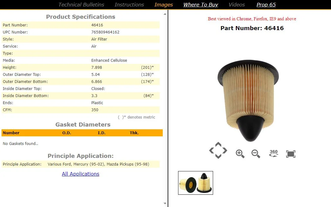

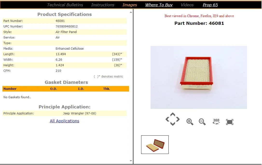

I'm not finding any info on the flow ratings of an oem airbox vs the windstar. It looks like the round windstar filter has a comparable surface area and the nipple that sticks into the cowl is a larger diameter than the factory horn?
I'd like to get cooler air into my 10.2:1 stroker this summer and if i got a small boost to airflow that would be a bonus. A decrease in airflow isn't a sacrifice I'll make on this stroker though. Without one in my hands i can't make a guess about that. Anyone have hard data? Or inlet/outlet measurements? Other comments?

Wix is the best source of info I have found.

Wow,thank you. Looks like a solid bump in cfm
Keep in mind that's only potential flow through the filter. Intake piping will dictate flow characteristics around the filter.
