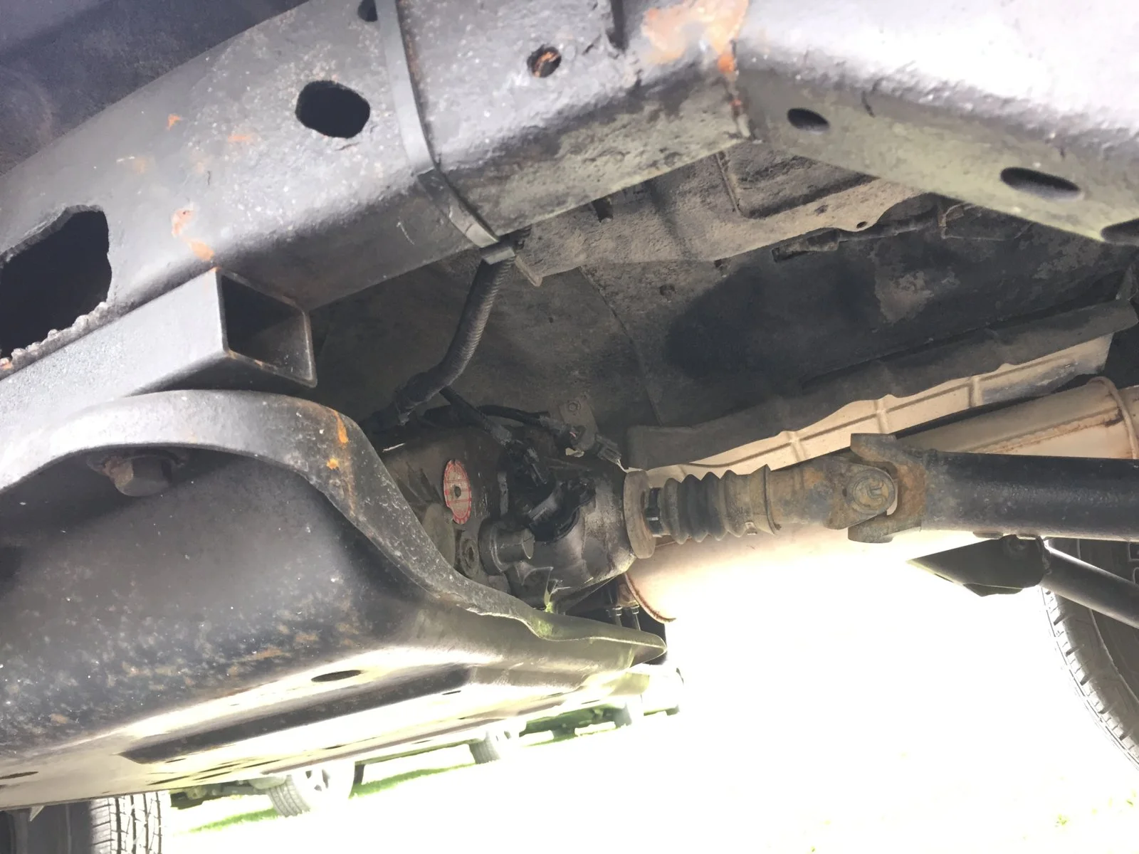

Ok, I've got a 4" lift on my PO TJ... trying to figure out if this thing has an SYE or not (probably not because there's a T-case drop) Here's pics.
