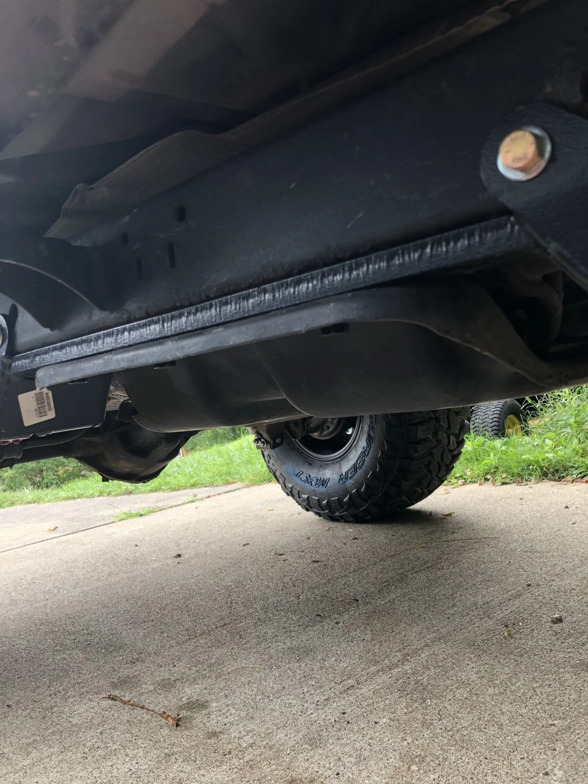

The jeep is a 5 speed manual. The issue I think that i’ve came across is that the console is in the way of the shifter but i’ve done some research and it seems like an SYE and CV driveshaft would fix it to where the shifting would be pretty much in the spot that it was before the lift if i were to raise the TC back up and install the the new parts. i’m not 100% sure, but i think the TC being lowered (if it is, still haven’t checked but like you said it probably is) is what is throwing off the shifting and it would hopefully go back to normal if i were to raise it back up and install those new parts. plus i could reduce other potential issues if i had the CV driveshaft & would have less driveline vibrations i think. thanks
Reactions: JMT
I took a look at the wrangler and there’s been a TC drop. instead of it being on individually placed spacers it’s been lowered by the new control arm mounts on my jeep (i’ll provide pic) but now my main concern is that it won’t be able to be put back to its original spot since i can’t remove the spacing from the mount. also i took off my center console last night to try and fix its shifting and that still didn’t work & i found out 4 low won’t work either
Whoa... that's a bizarre setup I haven't seen before. It looks like a lowered transfer case bracket that is connected to relocated control arm brackets? That's some real rigging right there.
Might want to start a new thread for this one for more attention. Never seen anything like this with the exception of a long arm kit.
i think i found a fix by just buying a larger straight shifting extender from rough country. thank you for your help though! (also that setup is what came with the rough country lift lol)

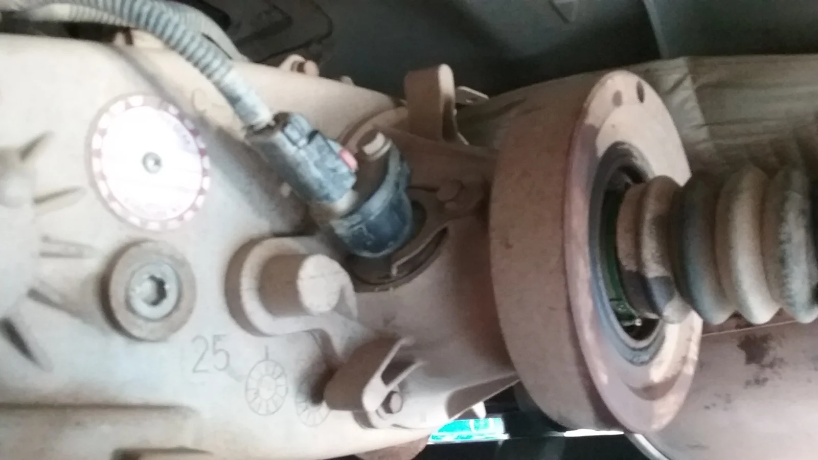

Just bought a 2004 Wrangler x and the driveline was vibrating at stock height. Contacted previous owner and he gave me a metal dampener that was on the yoke. I don't know enough to tell but would it be worth just getting an sye kit on a stock height wrangler or to find a shop to fix it. Currently have tried a few but they don't seem to know what it is or how to fix it exactly and dealer just quoted rediculous prices.
It would be worth putting a SYE on a stock height Wrangler if you have any plans whatsoever to lift it in the future!
No, you shouldn't need a SYE for a stock height TJ. It won't fix your problem. It sounds like one of your drive-shafts is out of balance. I'd take it to a drive shaft shop and have them check the balance and correct it.
If the drive shaft is not your problem, what about your tires? Are they in balance? TJ's have to have their tires in perfect balance. What size tire are you running, and what psi? What condition are your tires in?
Drive shaft was checked and it is ok. The tires are stock. One mechanic said the dampener on the yoke is the metal piece that came off and it’s not fixable it just needs a new one, then another mechanic said it was fixable just confused by it all.
Thanks for the advice I do plan to lift it but not soon, gonna restore the body first. Would I have to get a custom length driveshaft or would I be able to order one because it’s not lifted yet?
You'd have to get a custom length CV driveshaft. Call up Tom Wood at http://www.4xshaft.com and he'll set you up with everything you need and know the size you need as well!
My 03 TJ had a harmonic balancer on the slipyoke side of the transfer case. Maybe that is what your mechanic is referring to?
Thank you so much, yes that’s it. But I’ve heard it can be fixed from a shop and I’ve also heard t can’t be fixed from another. Do you know anything else about it?
I'm not entirely sure how it's attached. Does it have bolt holes on it or anything that suggest it can be bolted back on?
No it’s just a metal ring hat seems like it was pressed on, previous owner said it fell off so a shop just took it off the shaft for him and he held on to it. Because I’ve gotten different responses on if they can fix it or not I was wondering if it would b easier to do the sye because it gets rid of that part. Thank u all so much for the help also.
