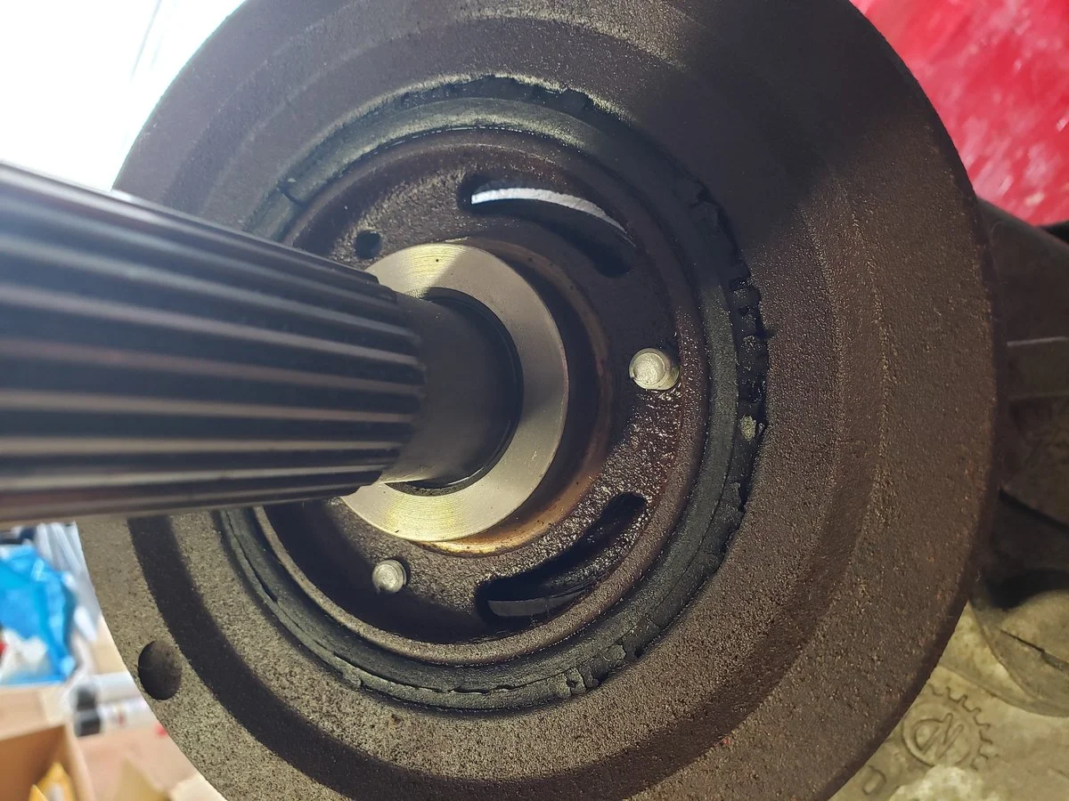

No it’s just a metal ring hat seems like it was pressed on, previous owner said it fell off so a shop just took it off the shaft for him and he held on to it. Because I’ve gotten different responses on if they can fix it or not I was wondering if it would b easier to do the sye because it gets rid of that part. Thank u all so much for the help also.

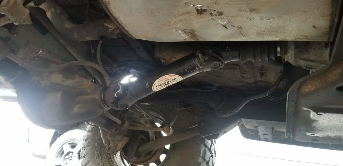

1997 tj just bought, only looks like it has a after market rear drive shaft. Still stock angel n boot. It has a 4in lift to it. Can someone help. Having vibration like crazy.
Reactions: reddvltj
The fastest/cheapest way to start eliminating vibes would be a transfer case drop, which I can't tell if you have already. Upper adjustable control arms would be my next move if i were you. without a SYE you'll want to keep the axle and transfer case yokes parallel.

I just installed an Advance Adapters standard SYE this weekend and I want to pass along my lessons learned:
1) If you have the harmonic balancer on your transfer case still, buy HARDENED M6x1.00 X 25 bolts to work it off the output shaft. Do NOT use non hardened bolts as they will break and leave you like picture #1, without many options. I spent the better part of two hours trying to drill them out to use an easy out bit and was unsuccessful. Ended up massaging it off with a BFH.

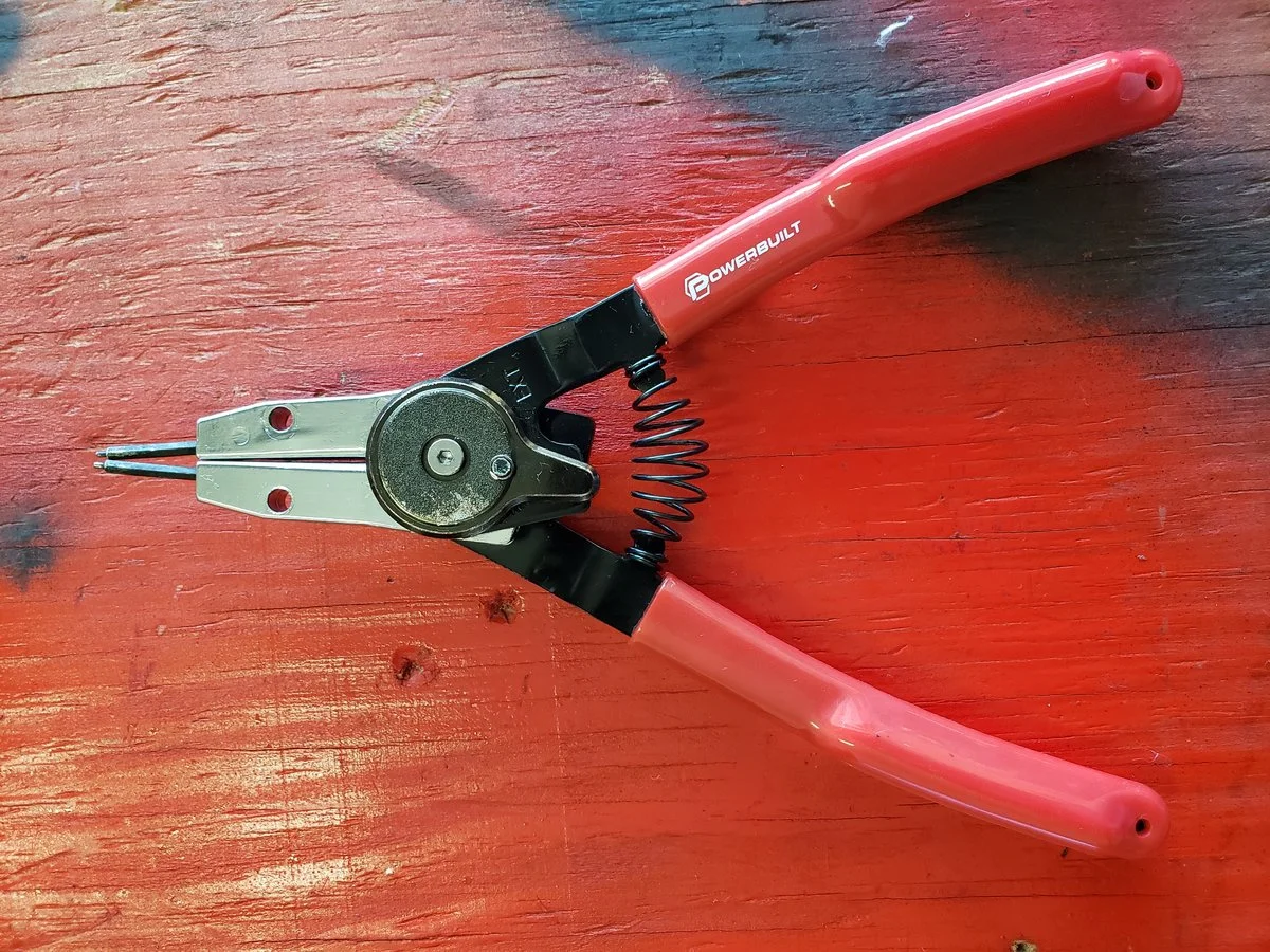

2) Invest in a heavy duty set of quality snap ring pliers. The set I had were cheap chinese made ones with the replaceable tips. They did not have enough strength to open the large rings enough to get the rings off the main shaft and barely enough to get the large on back on the new shaft. I fought with the ones I had before going to Auto Zone for another, beefier set that turned out to be just as worthless. See picture #2 and avoid these at all costs.

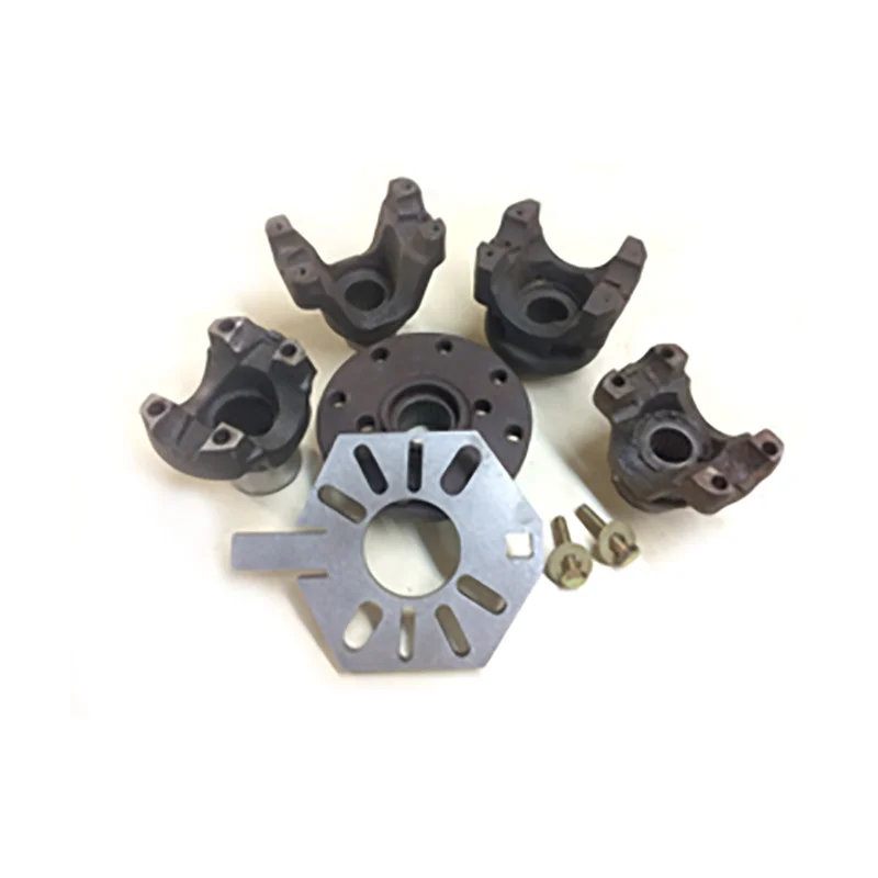

This bracket is handy
https://bleepinjeep.com/product/yoke-wrench-tool/

It becomes really really handy when crushing a pinion sleeve.
I appreciate the info, I watched bleepin jeep's youtube video on it and after thinking about it, I think it's a great way to support a great group who has taught me so much for free on youtube, ordering the tool now!
