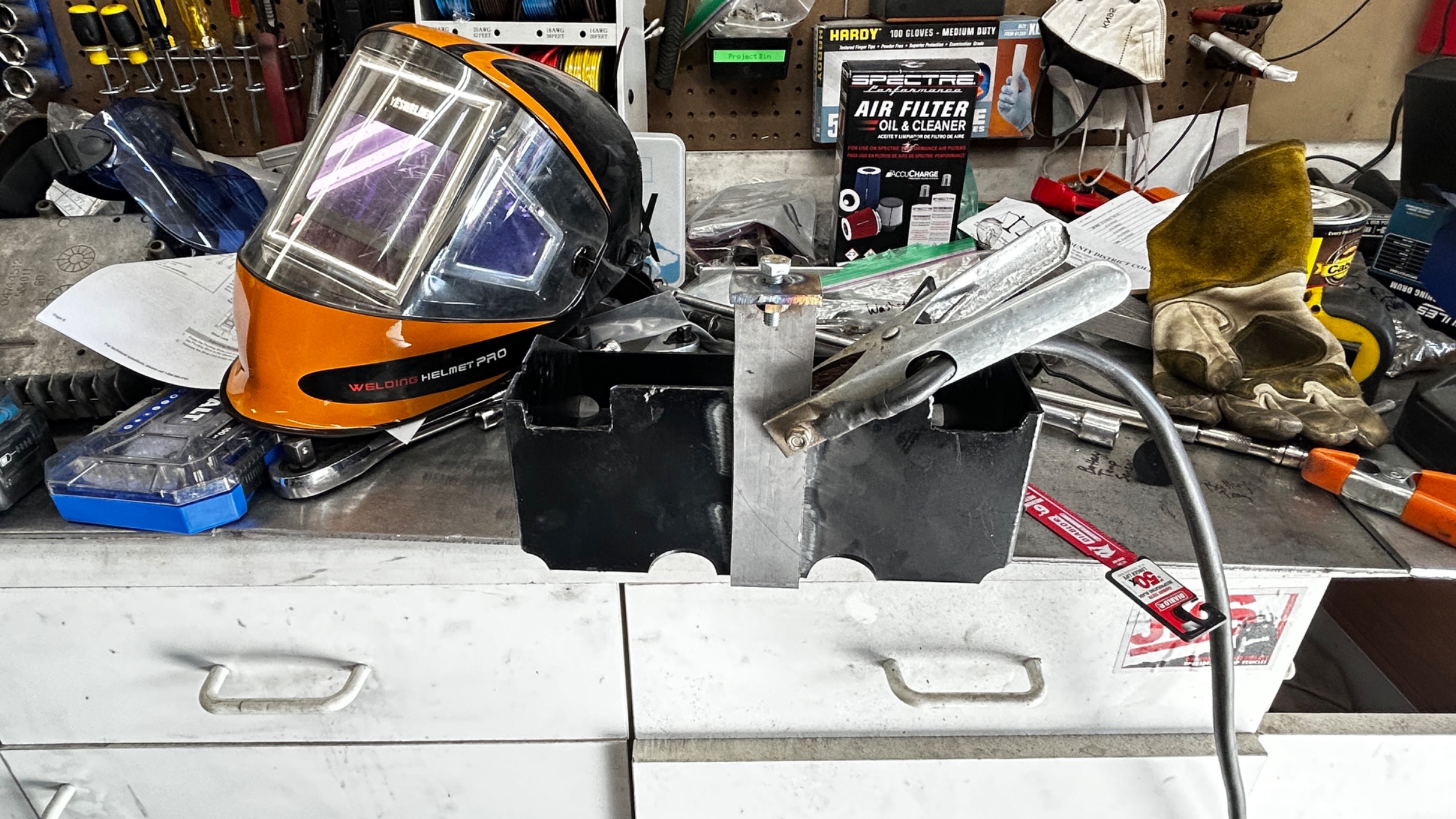

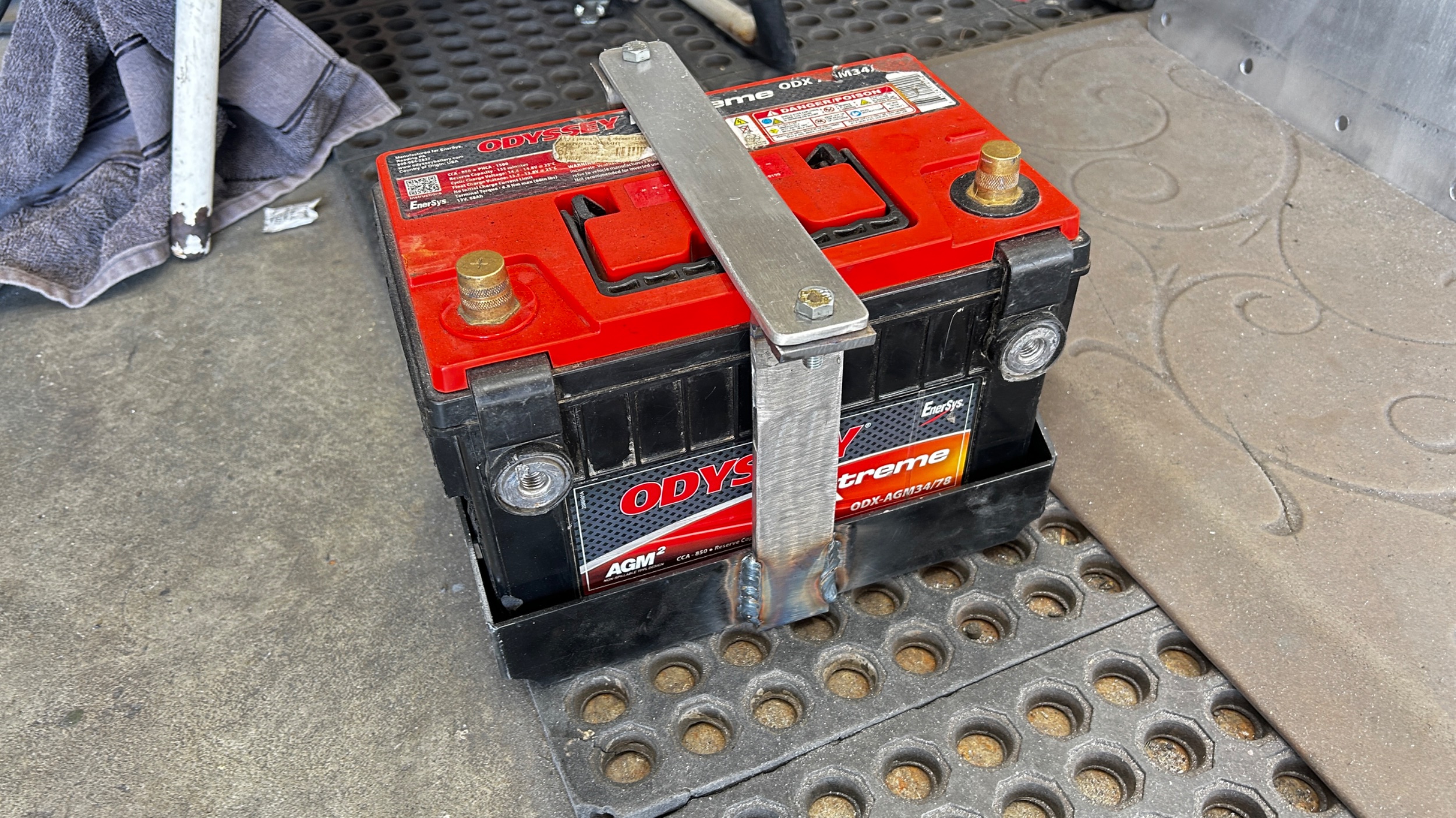

This should work for a battery tie down. Thanks for the good ideas.
The only issue in this design is that it doesn't allow much adjustment if it needs to strap down more than the tolerance you built in. However, you can just wedge something(s) in that top piece if you need to.

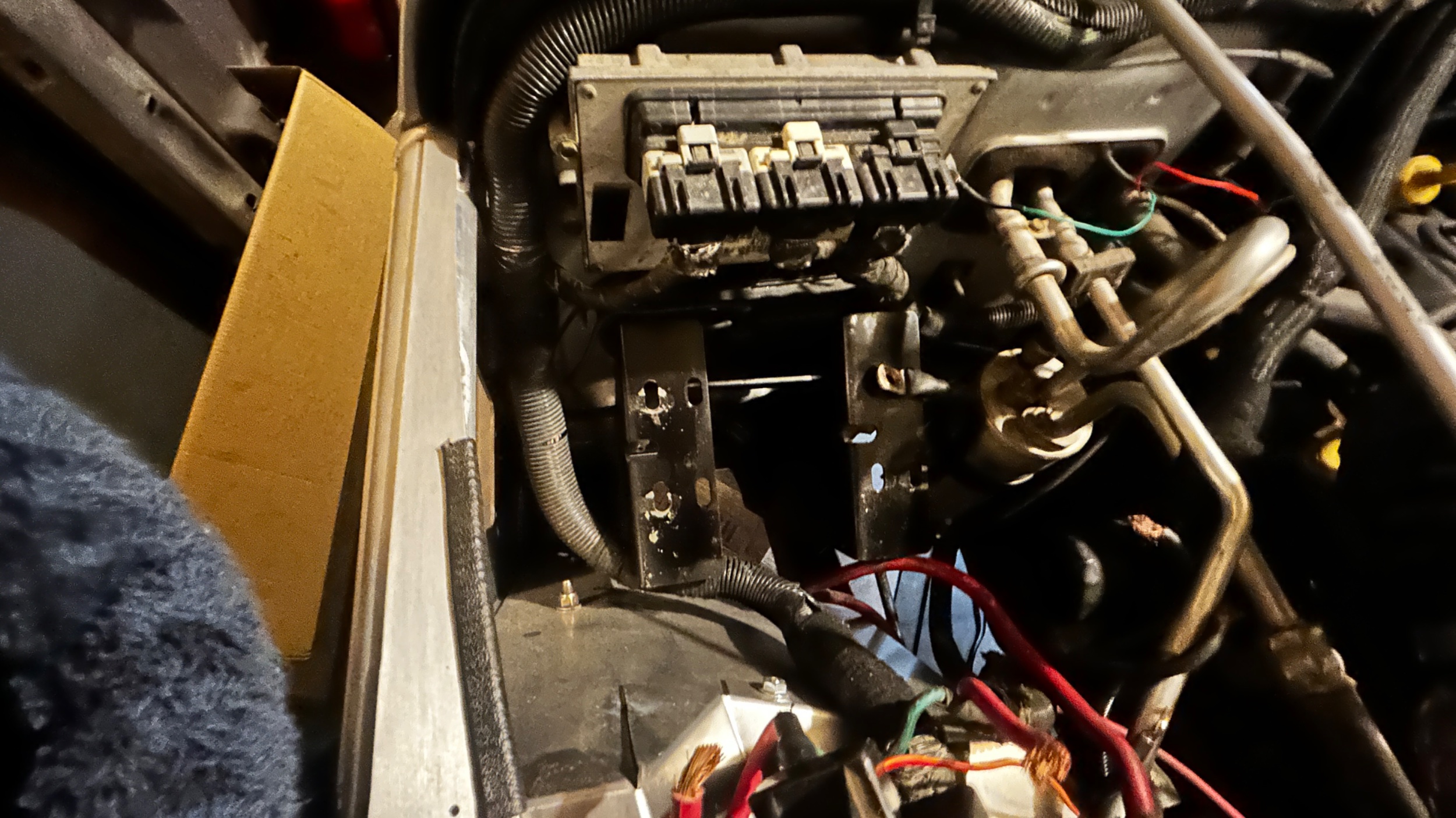

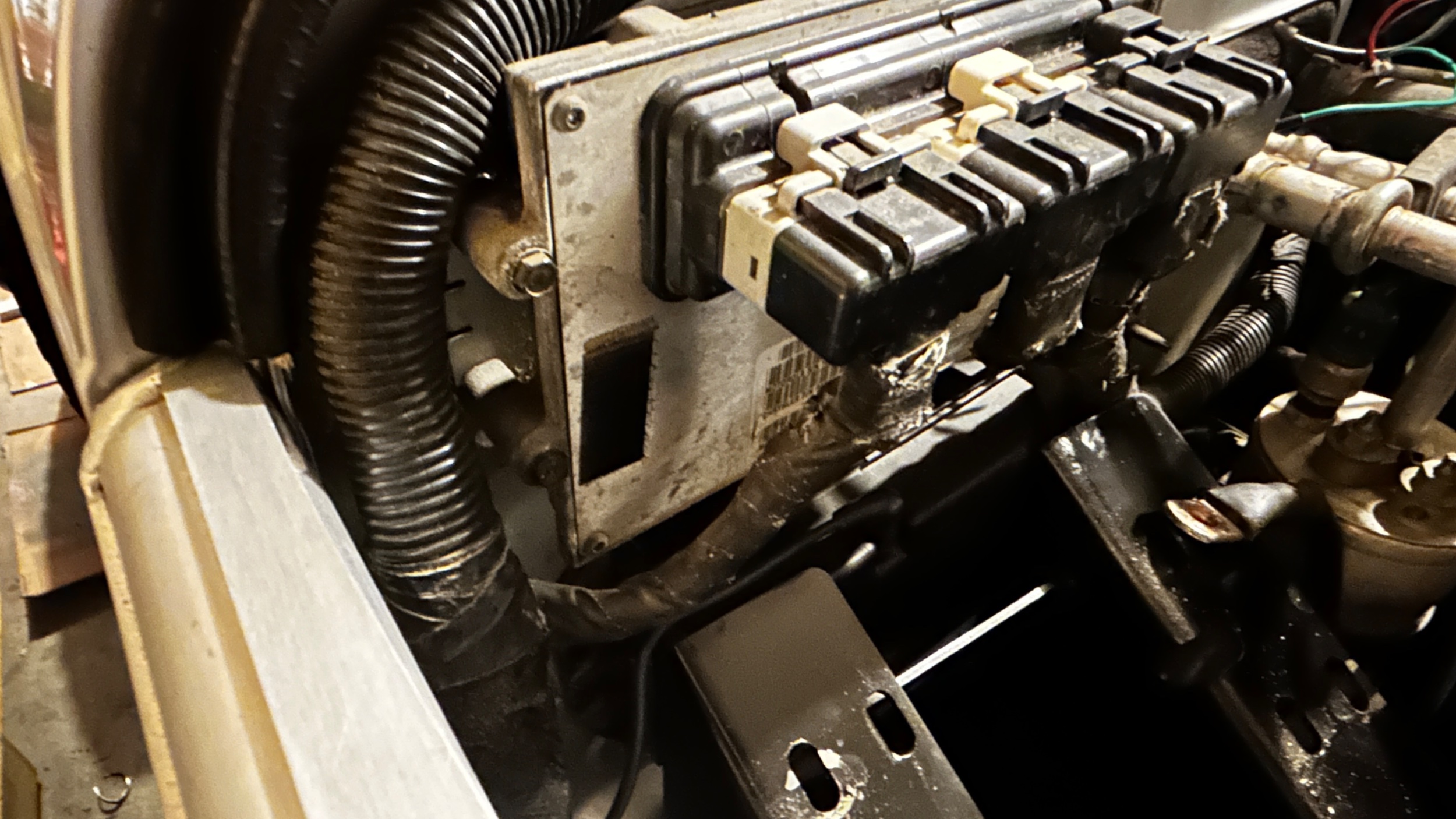

Don’t forget to move the pcm up and route the pdc harness under the battery box.
I need your help/advice with this. The PDC harness is in the normal position around the upper left corner of the PCM and then down and under the battery box. I can’t move it to the right side because an offshoot of wires goes to the plug on the upper left of the PCM. I don’t know where else it can go?!

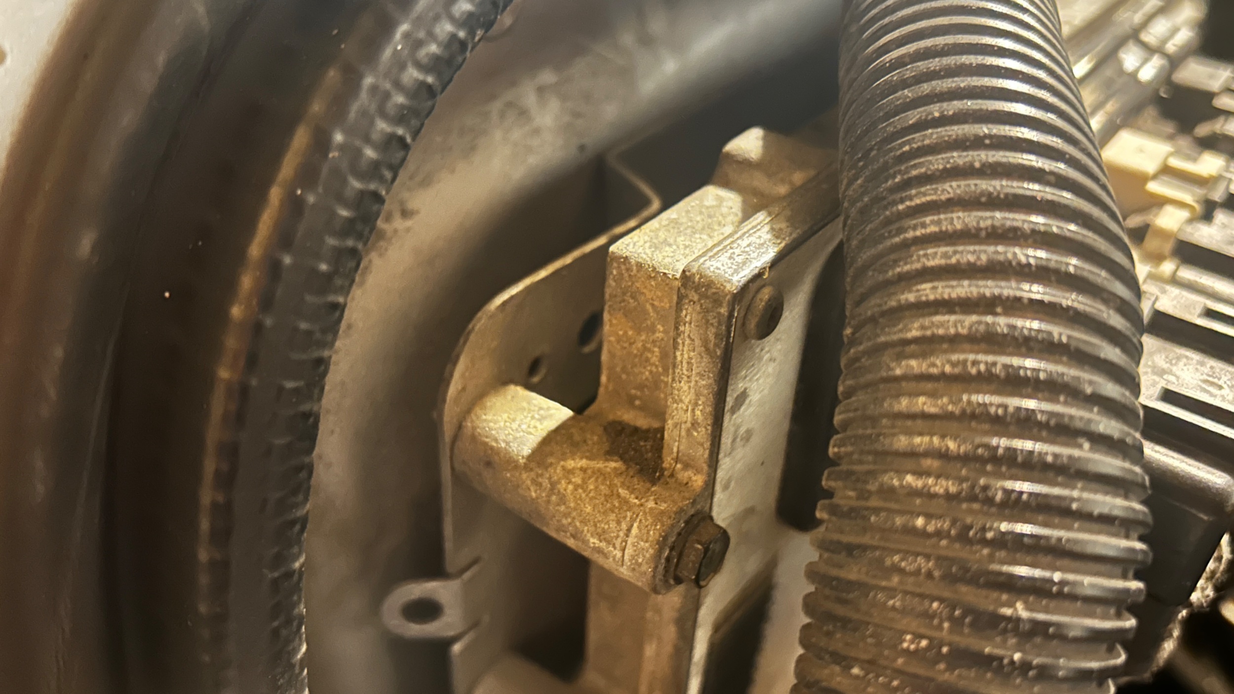

How do you move the PCM up? It’s mounted to a bracket that’s welded to the firewall. Cut all that off and use nutserts? It would move it back, away from the battery, which would be nice.
True, true. Something to ponder.

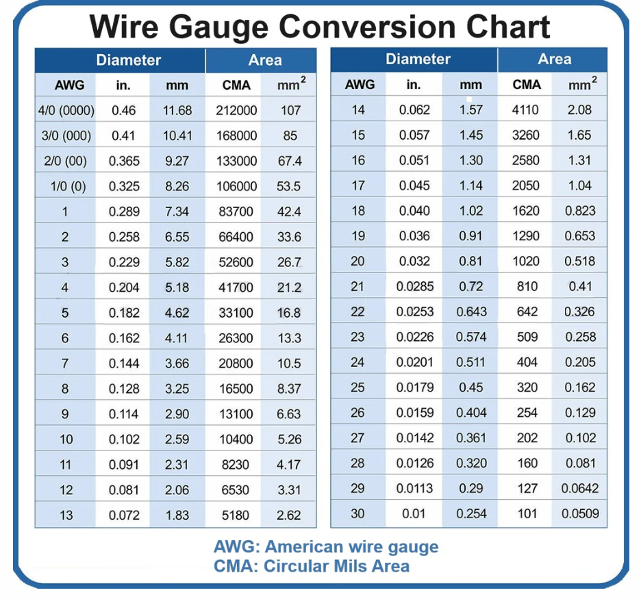

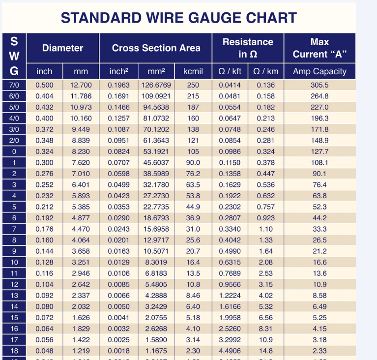

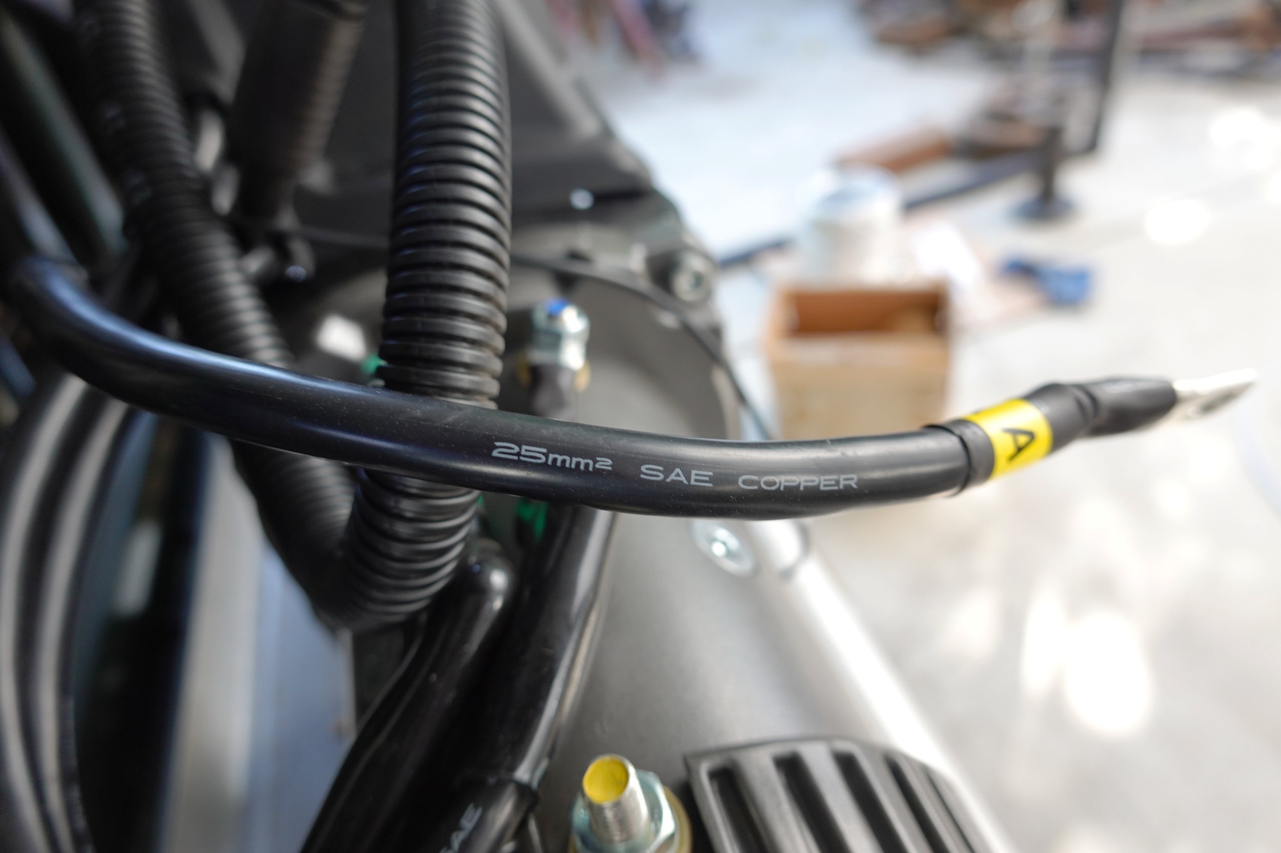

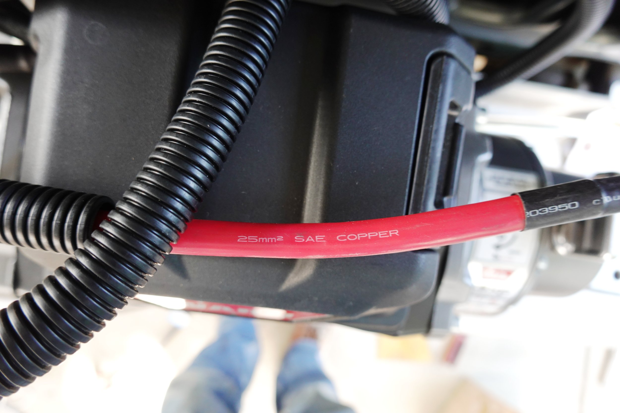

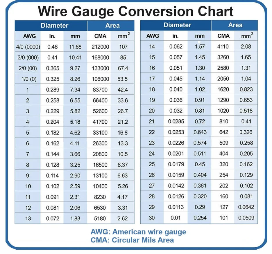

That is interesting...There isn't a standard gage size for 25mm² wire...Smaller that 3 ga, but bigger than 4 ga

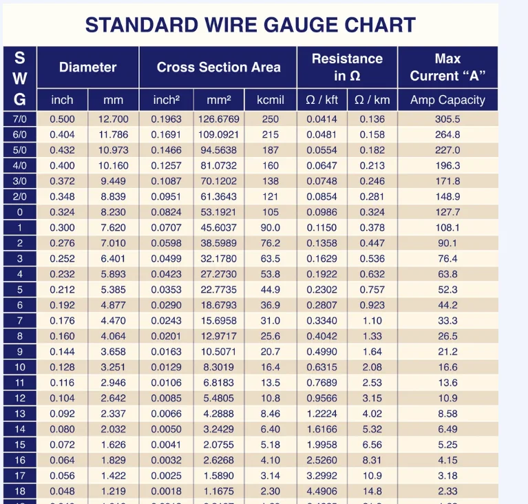

Also interesting...Another "standard" table that has different mm² sizes for AWG

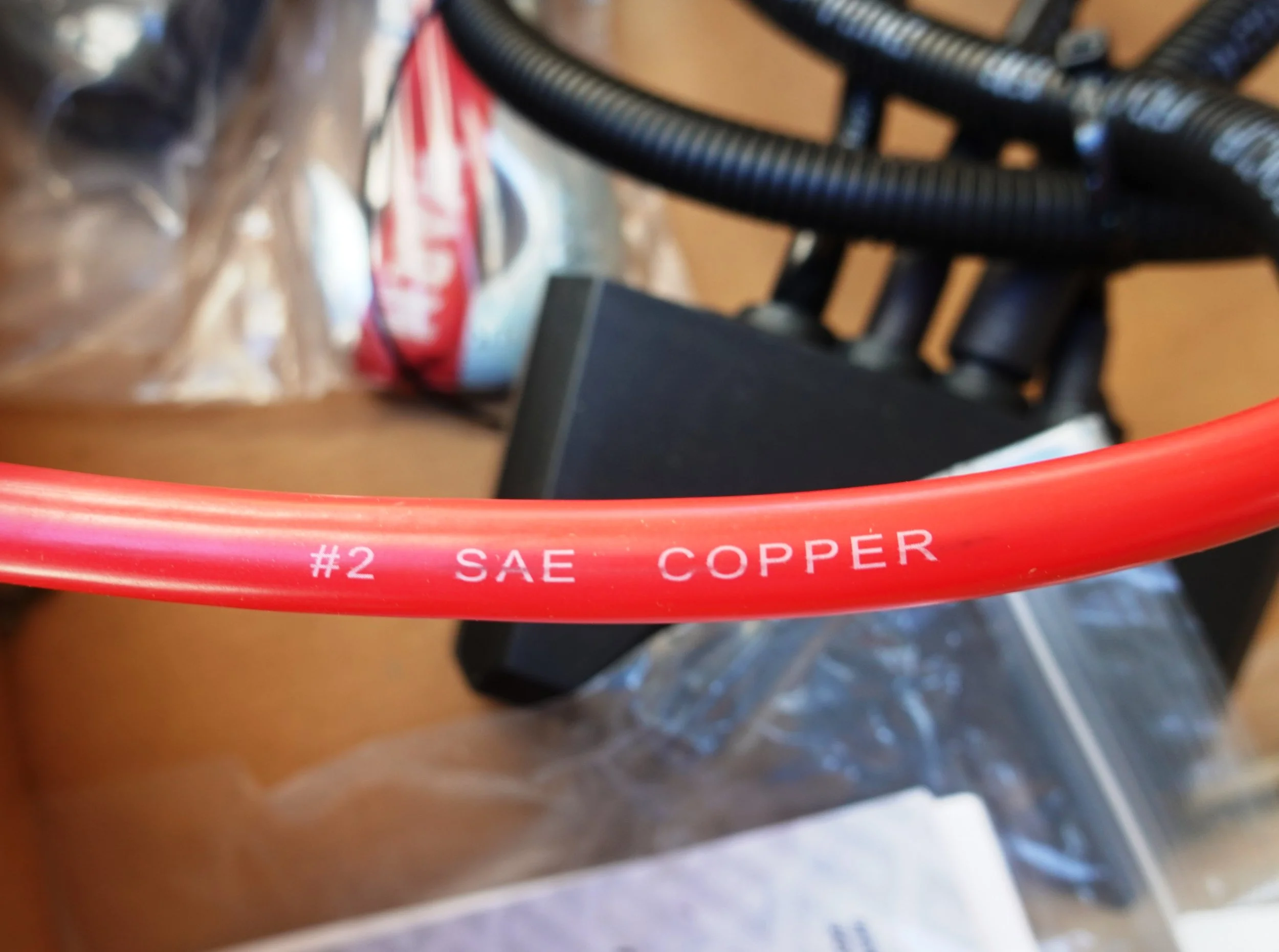

All I know is I've never seen that and all I did was test fit a few lugs to get the size that fit the best which was 4 gauge. The SAE part messes me up a bit.
WTH is standard metric? 25mm squared SAE?

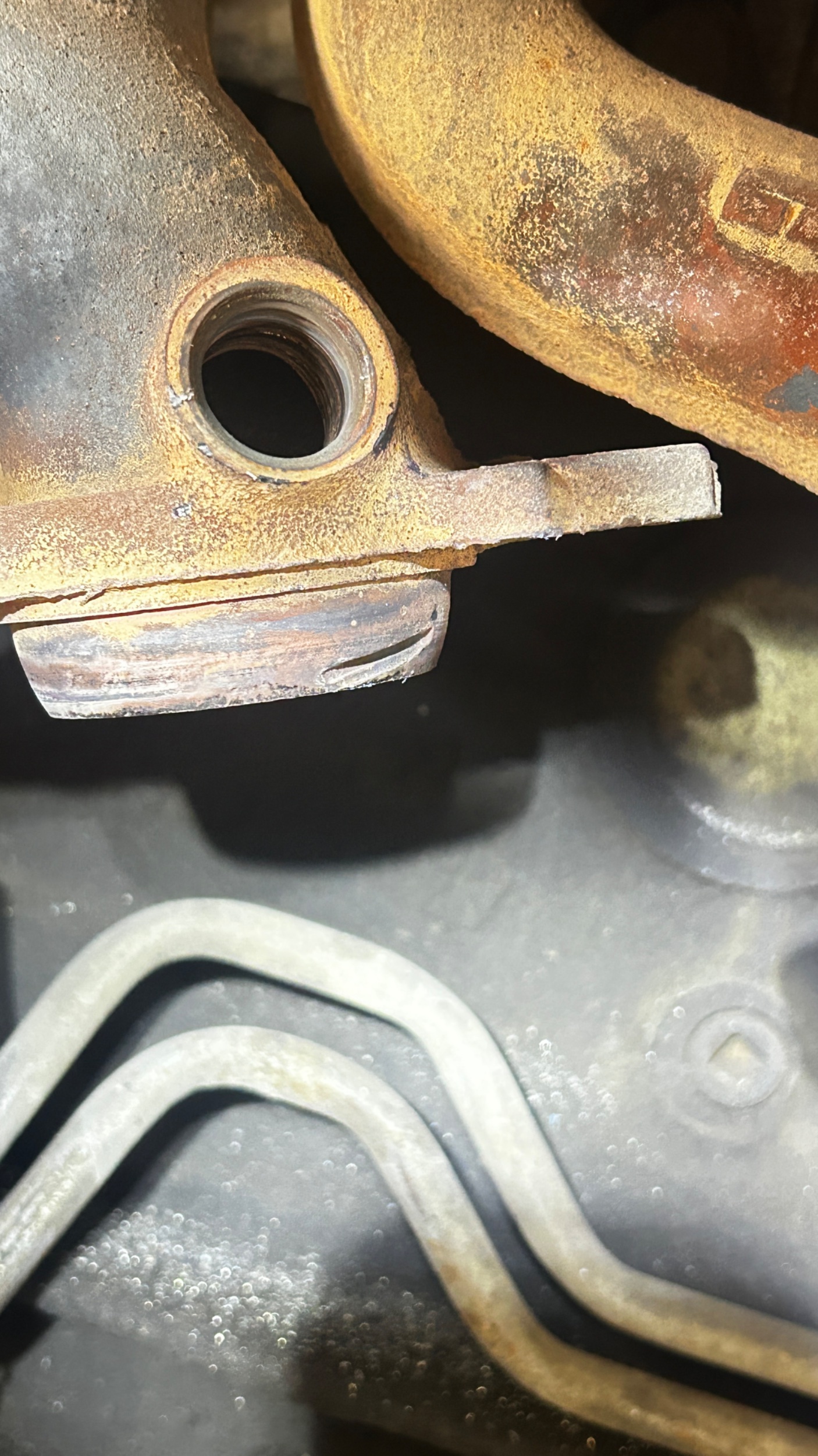

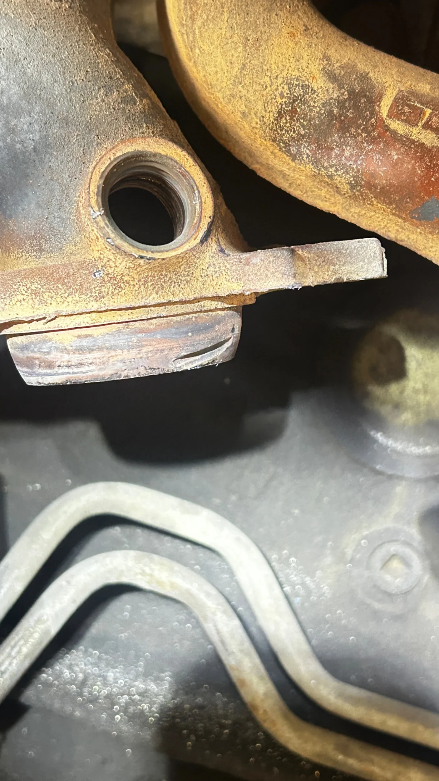

I removed the cats to replace them and this cut was there right where they mate to the manifold. Can I just weld it up and grind it smooth?
