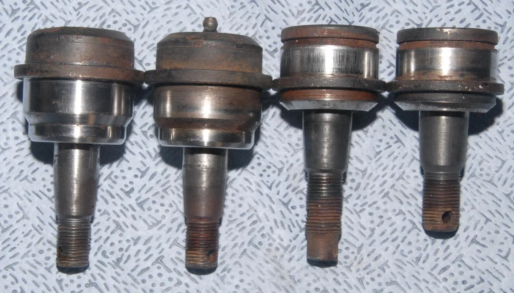

2 of these are JK ball joints, 2 of them are TJ ball joints.
different design but without a micrometer the diameters do not look different. i'm sold, same but different.
Yep, same but different. The main difference is the taper, that's it and that same difference also exists between the WJ and TJ lower ball joints. A micrometer may tell the whole story but it is easier to know that you can swap them between the inner C's with no difference in how they fit the holes.
