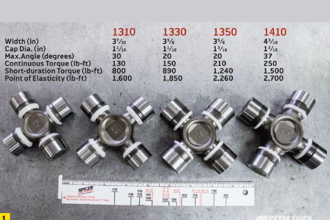

A 1350 u-joint is a 1 ton joint. The 1410 is also a 1 ton U-joint. The 1410 uses a wider body but the same-size caps as a 1350 joint. The 1350, it uses a wider body of the 1330 joint (3/4 ton) but with larger trunnions and caps...The front Gen2 Dana 44 uses a 1350 u-joint which is 1 ton spec.
I believe 1310's came in the TJ Dana 44..? @mrblaine
1310 on the left and 1350 is the second to the last. Thats a significant upgrade over a the Gen1 Dana 44 IMO.

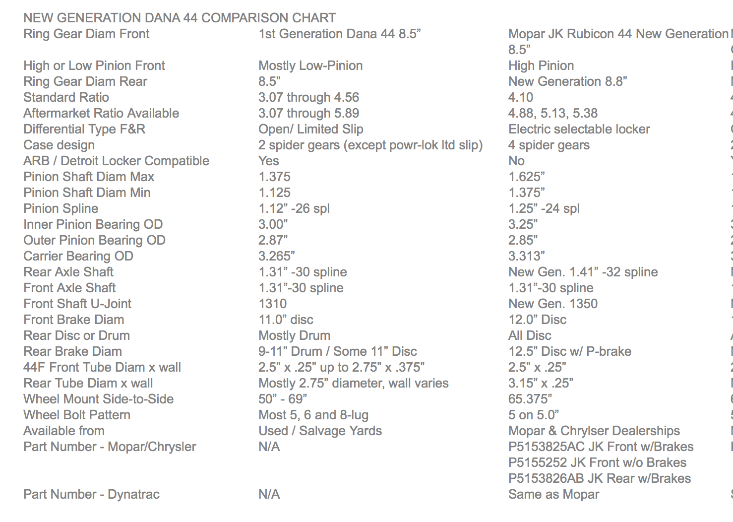

The Gen2 Dana 44 pinion shaft is same size as a Dana 60 Pinion shaft at 1.625 inches. It also has a bigger ring gear measuring in at 8.8 versus 8.5 in the Gen1.
The front Gen2 is high pinion Dana 44 which increases the front R&G strength.
The Get 2 Dana 44 also uses bigger bearings in the differentials.
You are right on the Gen1 & Gen2 Front 44 using the same axle tube measurements. Did the TJ front 44 use 2.5 inch OD though? I imagine it's much smaller...
The rear Gen2 Dana 44 uses much bigger axle tubes measuring in at 3.15 inch OD. Not sure what the TJ Dana 44 rear measures. F&R still use .25 Wall
I don't know who is calling a 1350 a 1 ton joint but I run a 9" front with 1 ton outers and there is no way that I would even try to run 1350 joints in my 35 spline axles.
It is absolutely an upgrade which is why I helped Revolution get them into axles for the TJ 30 and 44. Great upgrade, not a 1 ton upgrade though.
I understand the pinion shaft is larger but again, that doesn't make it strong enough for a 1 ton. That and the 8.8 means it is no longer a 44 even though they refer to it as one. Agreed on the HP, smart move on their part.
Same size, 2.5" OD x .250 wall tube.

Rear is 2.75" on the TJ 44 all models.
