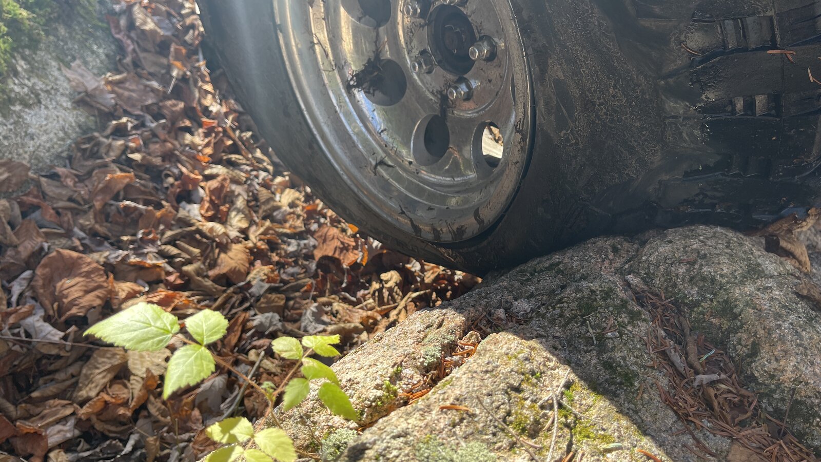

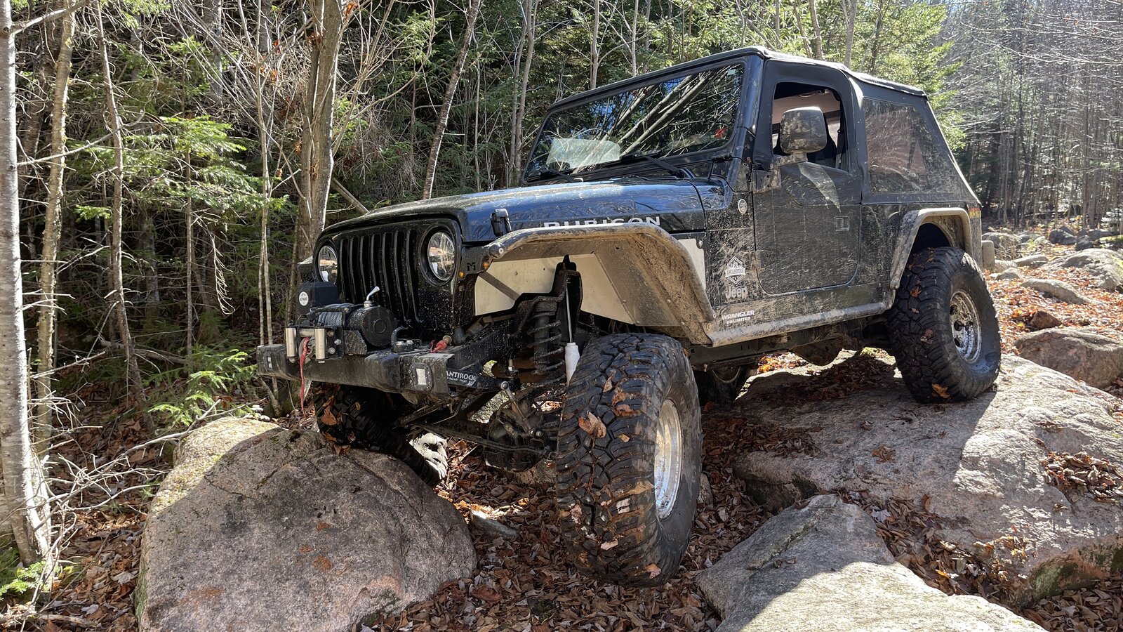

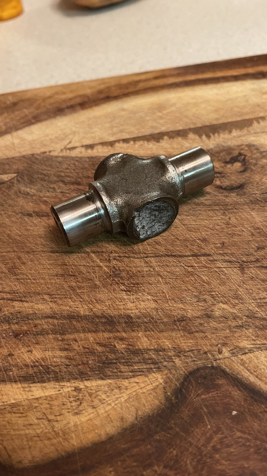

Today I had my first failure in 20 years. Luckily shafts were fine and got it replaced and back on the trail in 15 min
Looks like the joint was already cracked and this just finished the job. Joint only had 500km on it.
Almost everyone on the run had rcv shafts so I might make that swap.
