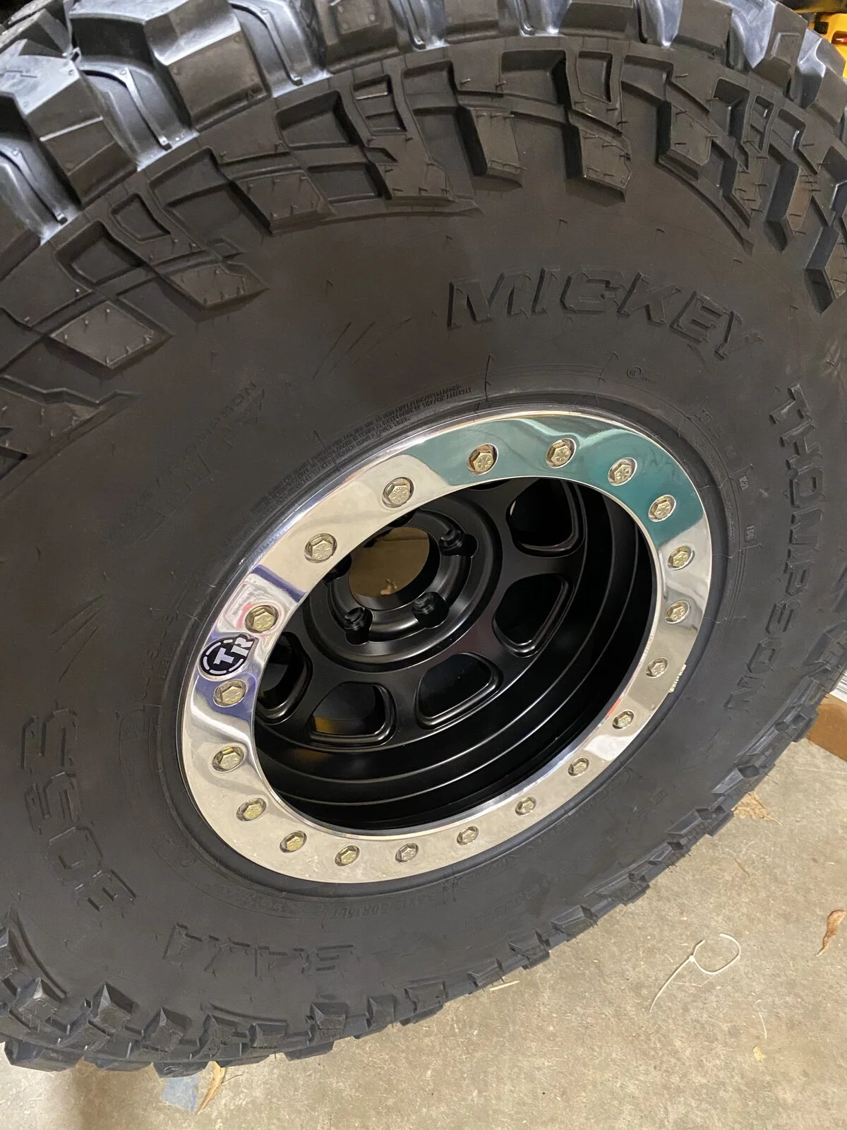

When I ordered my trailready’s I ordered from wildhorses4x4 and got free shipping. Best deal I could find for them.
