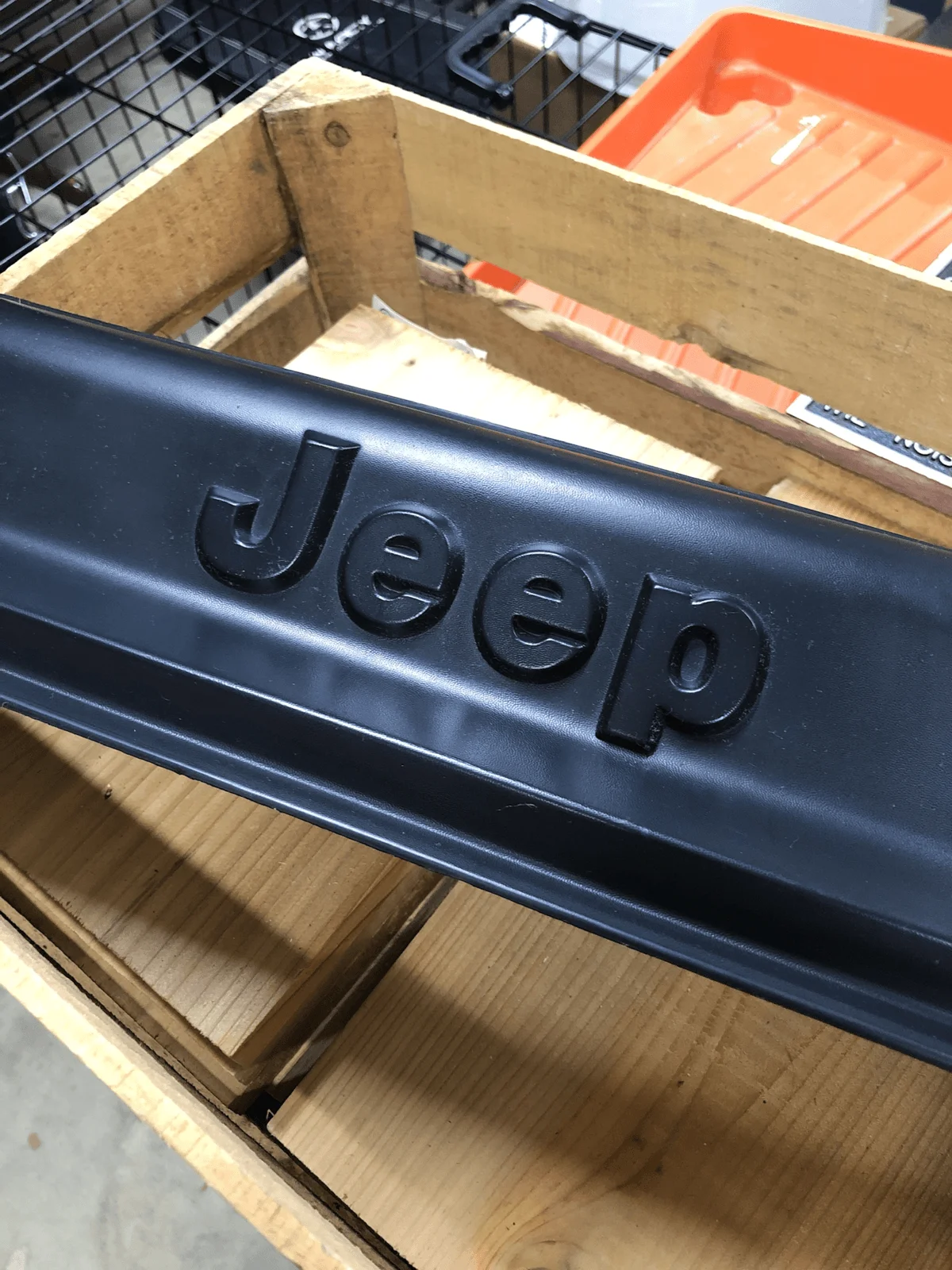

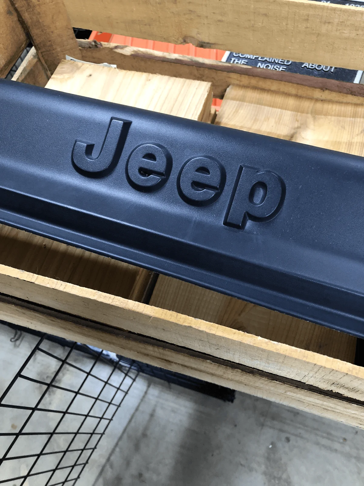

Seems the SEM trim paint is the way to go for those with Rubicon's as I don't see any exact replacement's for these like the Sports and such
Heres a cool video with some popular products head to head..looks like the turtle wax does well!

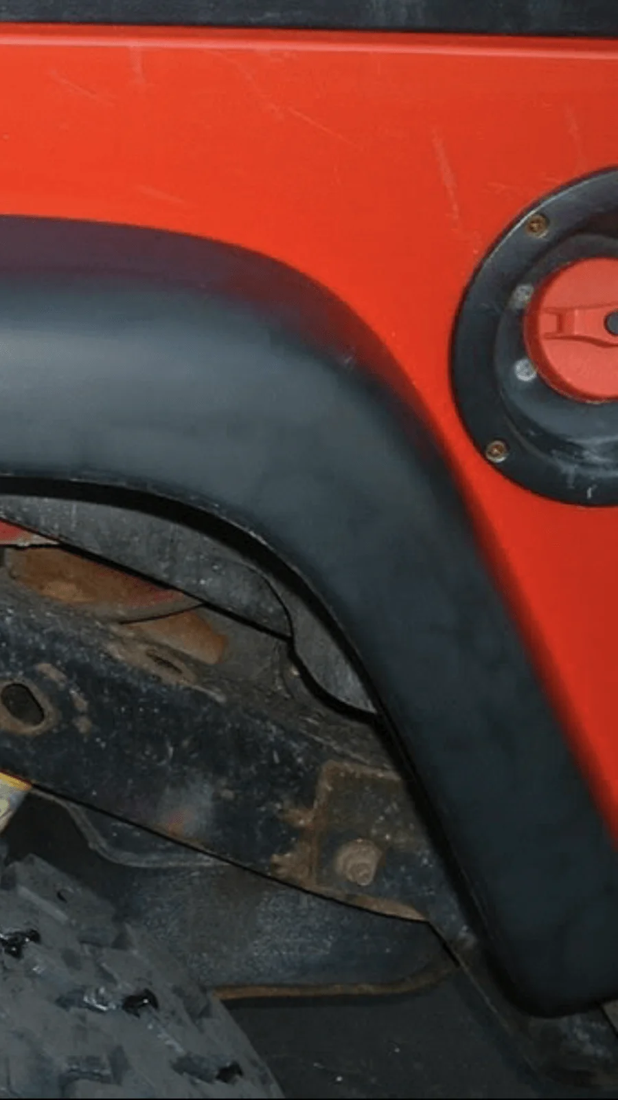

I don't have these kind of flares on my TJ, mine are metal now, but I have them on the JK, and they are huge in the front, same material from what I can tell (I didn't lab test the polymer/plastic).

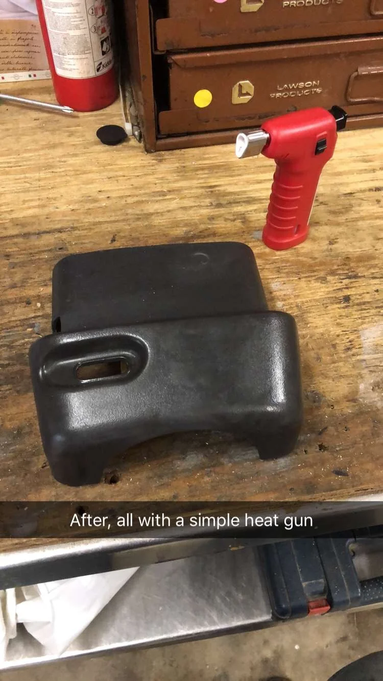

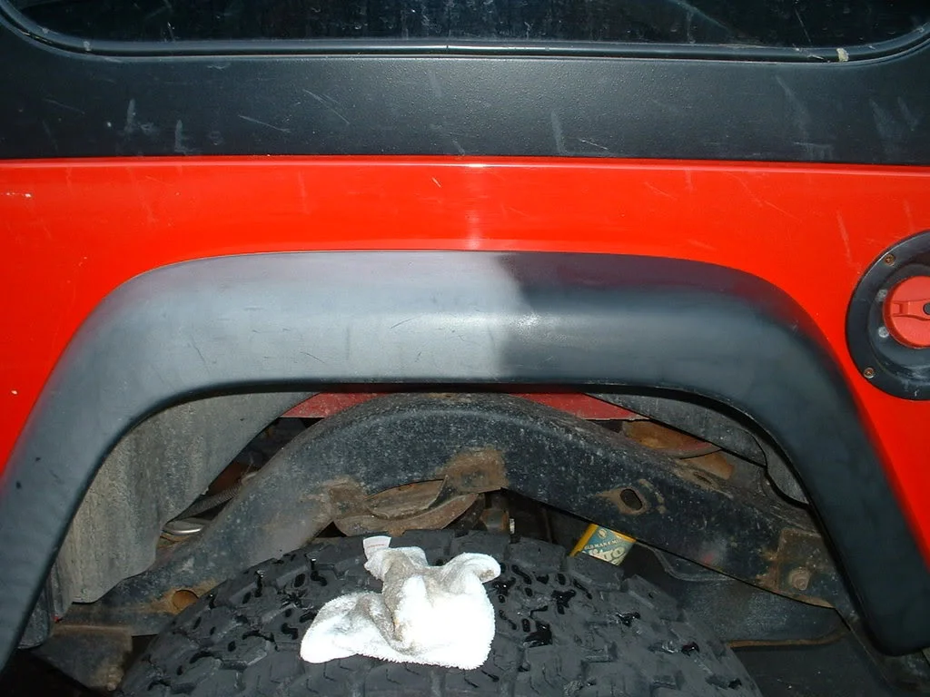

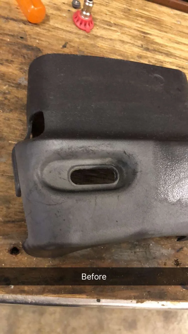

This stuff worked big time. I was extremely impressed for $20. I would try a free heat gun first, but if if that went gray again as some suggest in a month or two, I'd look at this. Make sure and clean with dish soap big time before.
.............and do you get dirty oil on your clothes if you bump into or accidently lean your flares ? :rolleyes:
just barely a dab, is enough to replace the oils the sun dried out of them, i'm not soaking them down.....vegetable oil would do the same thing, just not last more than a few days........i've never noticed any transfer from them but i don't lean on my fenders or wear button down shirts and dockers either.
