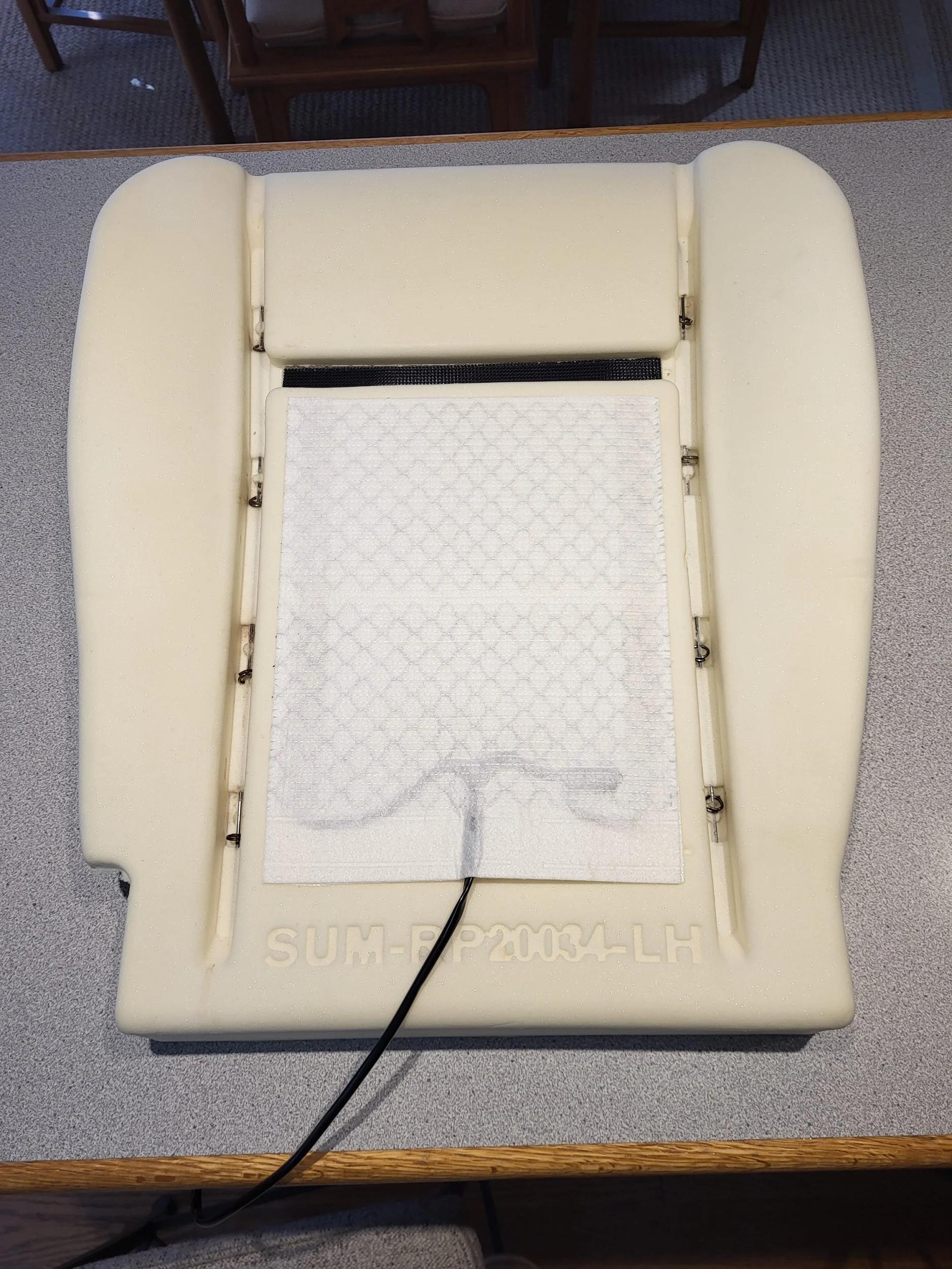

For those who have heated seat pads and put the new Summit foam in, did you have any issues re-sticking the seat heaters to the new foam? Or getting them off the old foam for that matter?

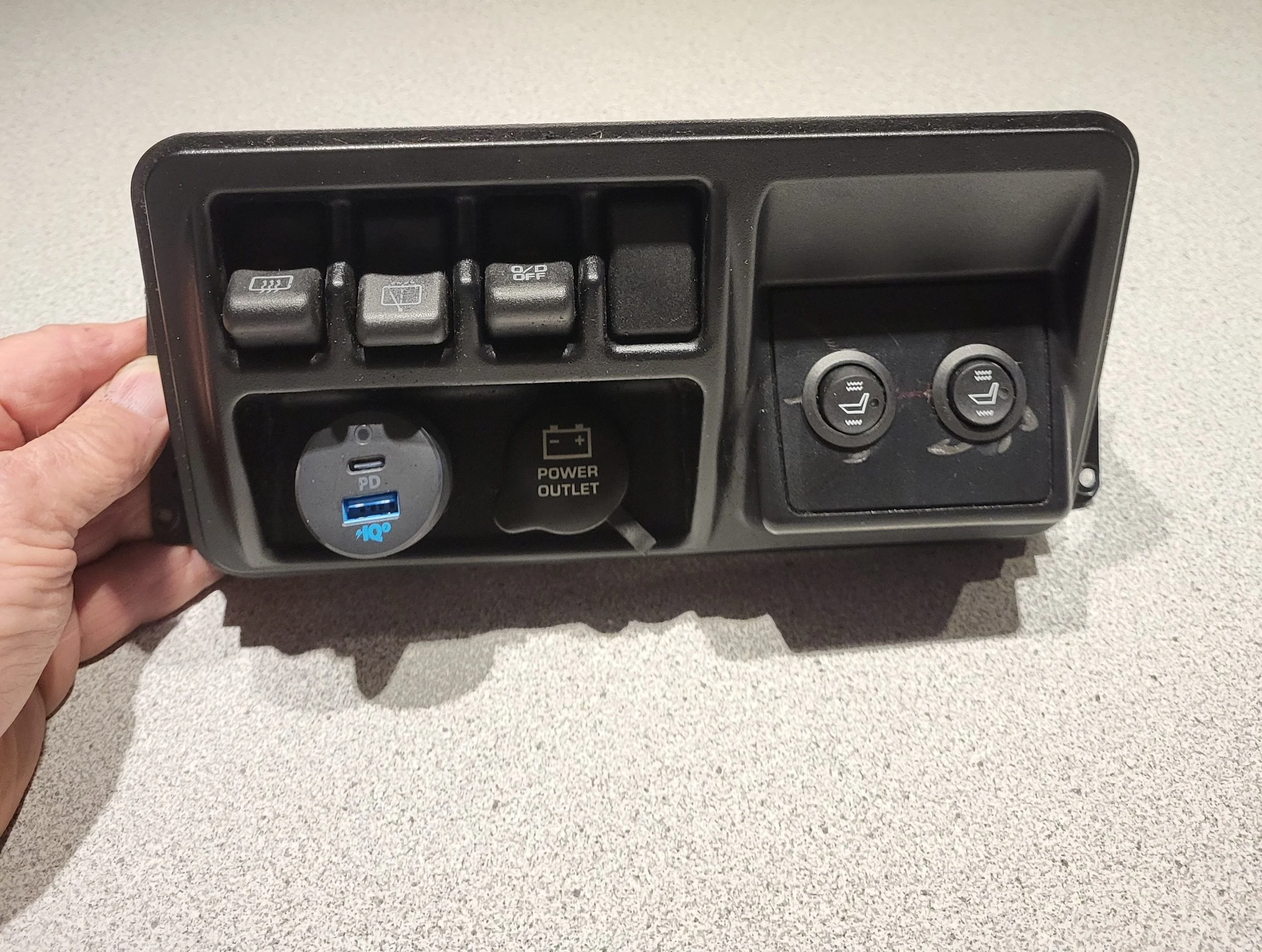

What is your seat heater setup? I should consider adding them, my heater core is bypassed and I dont plan to change that anytime soon so seat heaters would be a good idea.

Getting the seat heater off of the old foam was a pain in the ass. I took a razor blade and cut just below the heater taking only foam and not cutting into the heater. I wasn't sure if it was going to work, but it did. I used 3M spray adhesive to put it on the new seat cushion and that worked really well. I also have the regular seat cover and then Bartact over the top of that.

Thankfully from what I remember I just slid in my heaters without and adheasive.

Thanks. Any specific 3M spray adhesive? I’ve used a few different kinds of their spray adhesive over the years but can’t remember which.
I was afraid of that. I may consider getting another set and just putting new heaters on the new foam
