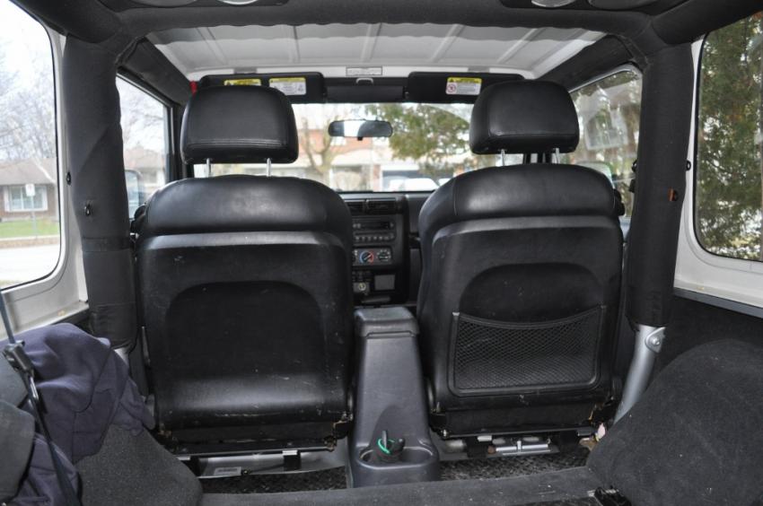

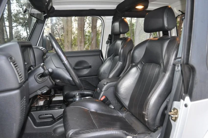

Here's how they turned out ... very comfortable!
And from the back. I even got a mesh storage net out of the deal!

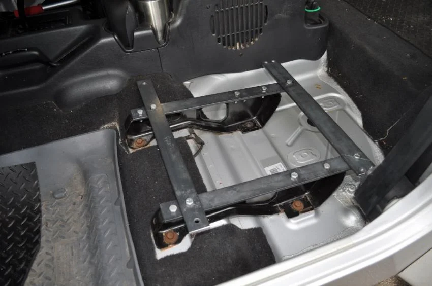

I made a simple bracket out of flat bar. There was no need to weld anything. I later removed the seats, painted the brackets black and used grade 8 hardware to secure everything. The Tiburon seats can now be removed and reinstalled easier than the original seats.

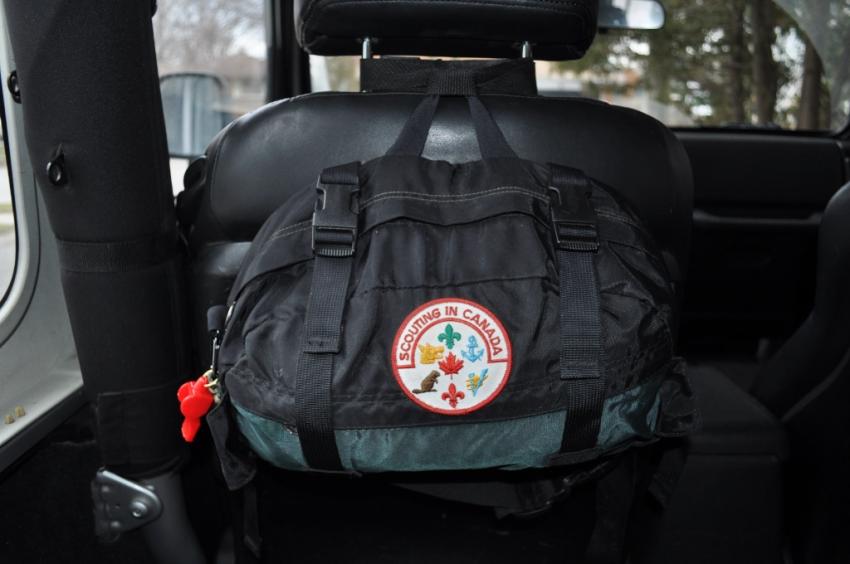

The nice thing about this type of head rest is that I can hang a back pack (or ?) from them. This is my old first aid kit from Scouting.

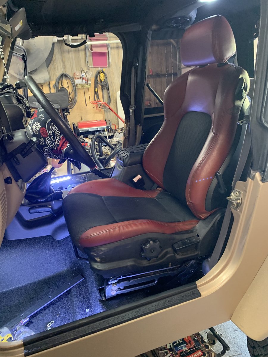

A local guy here did the same swap, and loved it. Seats are only $34 each at the u-pull, and I've been thinking about doing it myself. If my seats weren't perfect, I probably would have by now.
derekmac - Do you know what year of Tiburon he used? When I went to the first wrecker there was only 1 Tiburon but the second one had 9! I went with the first one for my TJ and the second for my LJ. I also put them in my XJ and got them off a guy on Kijiji. There was quite a variety at the second wrecker from relatively simple seats in the early years to nicer ones in later years. Some also came in cloth which may be appealing to someone. None of the sets I got came with heaters but I know they exist. The 3 sets I got all came from 2003's (coincident only). I think Tiburons are now of the age where we'll see a lot of them going into wrecking yards so the supply of seats should be good for a while yet.
This is only one option of course. I saw a guy put a set from a VW Golf in his and it turned out great.
Reactions: Chris and derekmac
^^^ That's pretty neat. First time I've seen another set in a TJ! His look just like mine so I guess at least model years '03 to '06 are the same. He's right re the dimensions. Without checking I remember having to go from 11" to 17". He used 0.25" flat bar but a little bit wider than I did. I also put in a couple of 0.25" spacer blocks on each of the rear bolting points to elevate the back a bit.

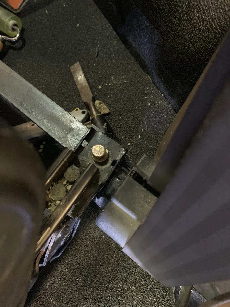

I know this is an old thread but I’m pretty sure I’ve seen the op on the forums a few times. I’ve got a set of seats and got the drivers side mocked up and the brackets made except the last 4 holes but I’m running into an issue where the slide is hitting the seatbelt roll. How did you get around this?
