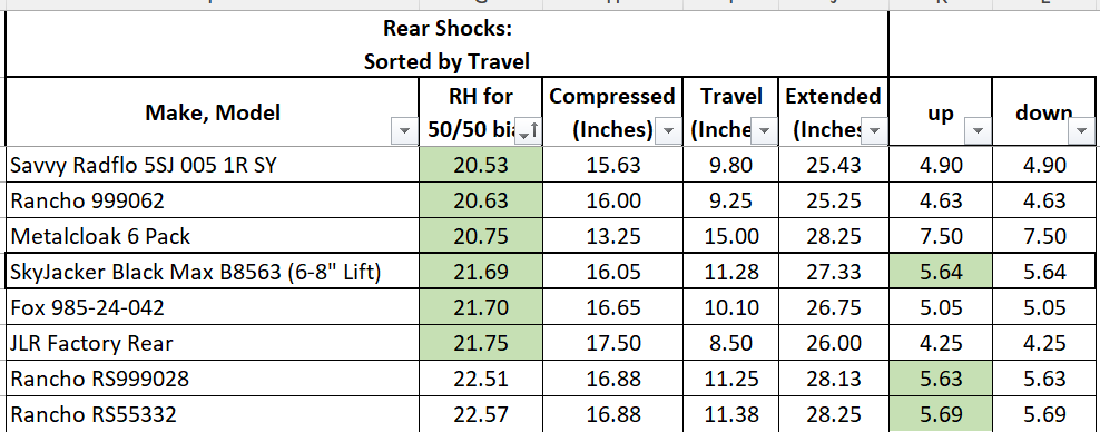

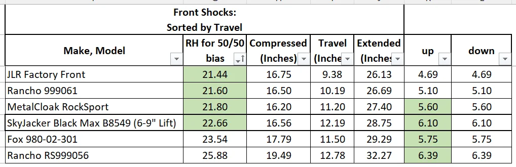

I took the spreadsheet from the original post and added a couple of columns, including one that calculated the shock ride height at which each shock would be at 50/50 bias for up and down travel (it's just the compressed length plus half the travel length). Then I measured my suspension cycle and ride height with my new 4" Currie springs. My Front shock ride height is about 21.75", compresses to ~17" and extends to 27". Basically, +/- 5". My Rear shock height is about 21", compresses to 15" and extends to 27" (+/- 6"). Based on this, the Skyjacker Black Max shocks highlighted below seem to be as close to a perfect fit as you could hope for. They're also super affordable. I've seen a variety of reviews of these shocks, but mostly better than average.
I know this spreadsheet isn't exhaustive, but I don't see any options from the more commonly recommended brands (Rancho, Fox, etc). that match the specs I'm looking for. Is there something else I should consider? Or a different approach I should take?
I just want to double check before I place an order.
Thanks!
@Chris
the front Jk black max shock b8575 can be used on the front of the TJ with a 3-4” lift and a 2” bumpstop. you need to press in a TJ bar pin. The published lengths are 15.39” collapsed and 26.31” extended. It offers a length between the TJ b8525 and the TJ b8549 shocks
Reactions: PRNDL and Chris
