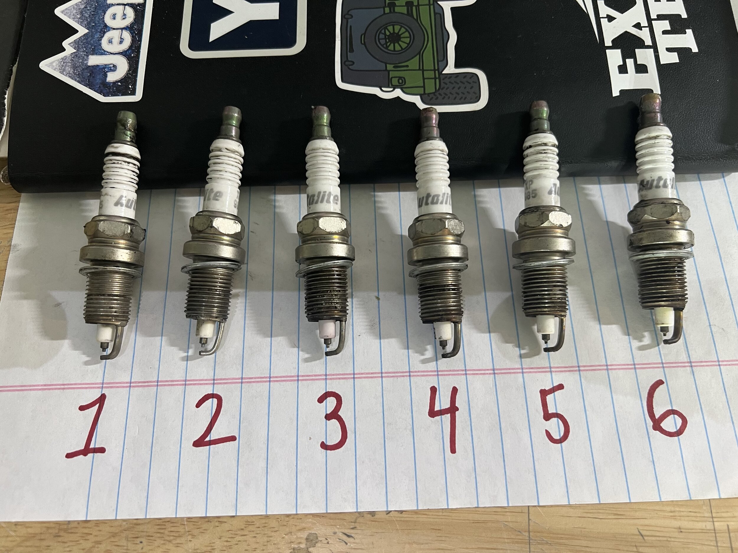

Thanks for this advice. This approach makes a lot of sense. I just removed the plugs and here is a pic aft right at 200 miles since they were replaced. I will clean the up and then install them in different cylinders. I will report back soon with my findings. In case it makes any difference these are Autolite Iridium XP985 plugs.

Well, moving the plugs around has corrected all my problems. I did replace the plug on the #5 cylinder due to it had some scarring on the threads. It ran awesome for about 29 miles and then I parked it because I needed to get some stuff done. I wonder if there was an issue with that plug in the #5 cylinder? I will advise over the next few days if it’s still good.
