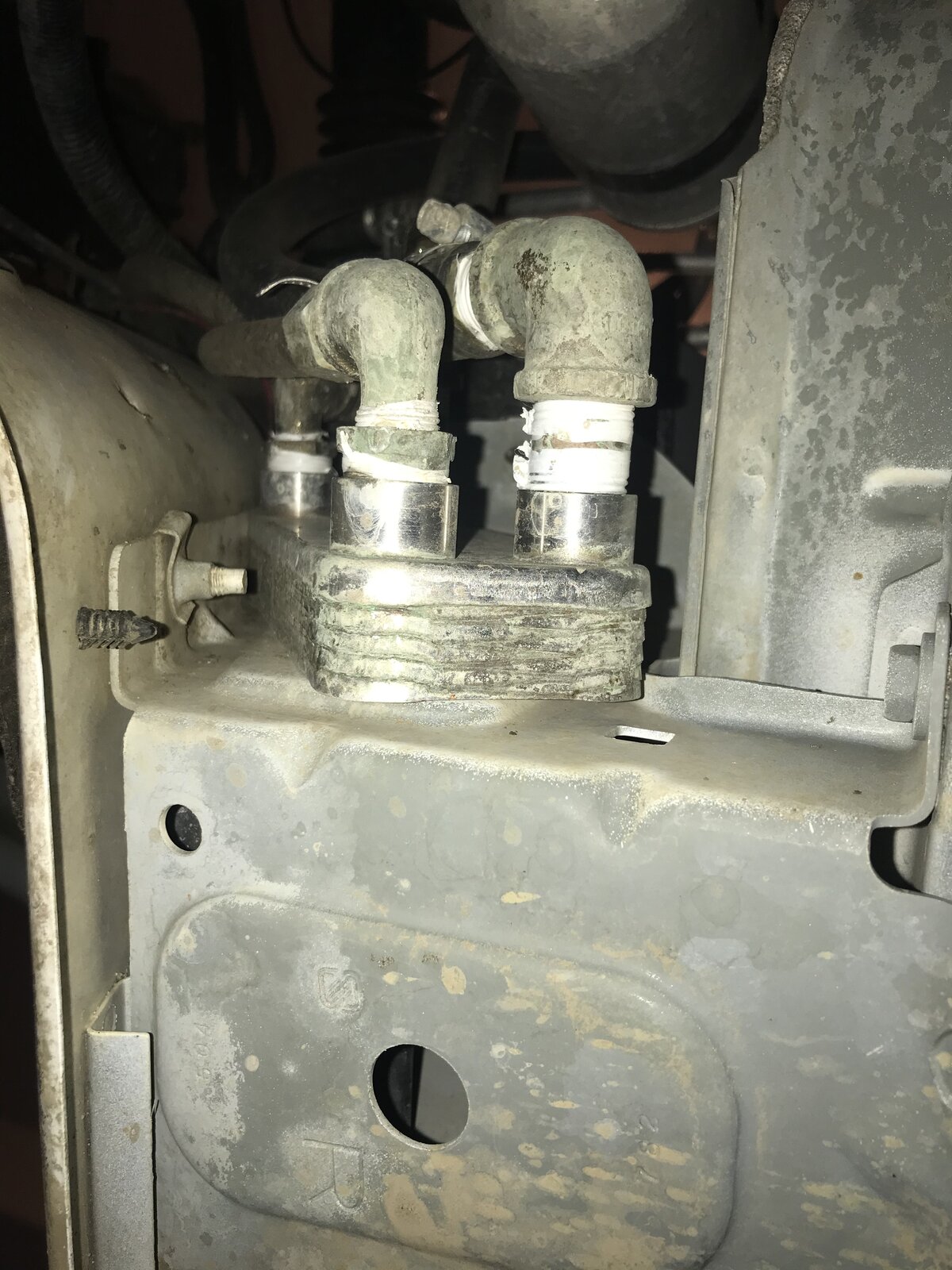

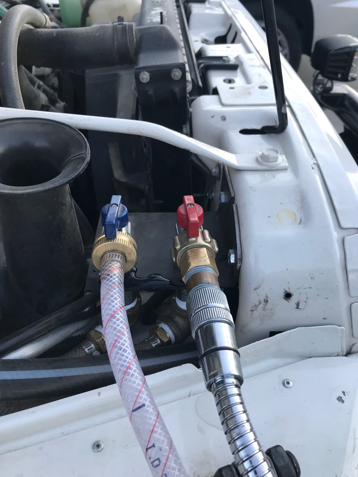

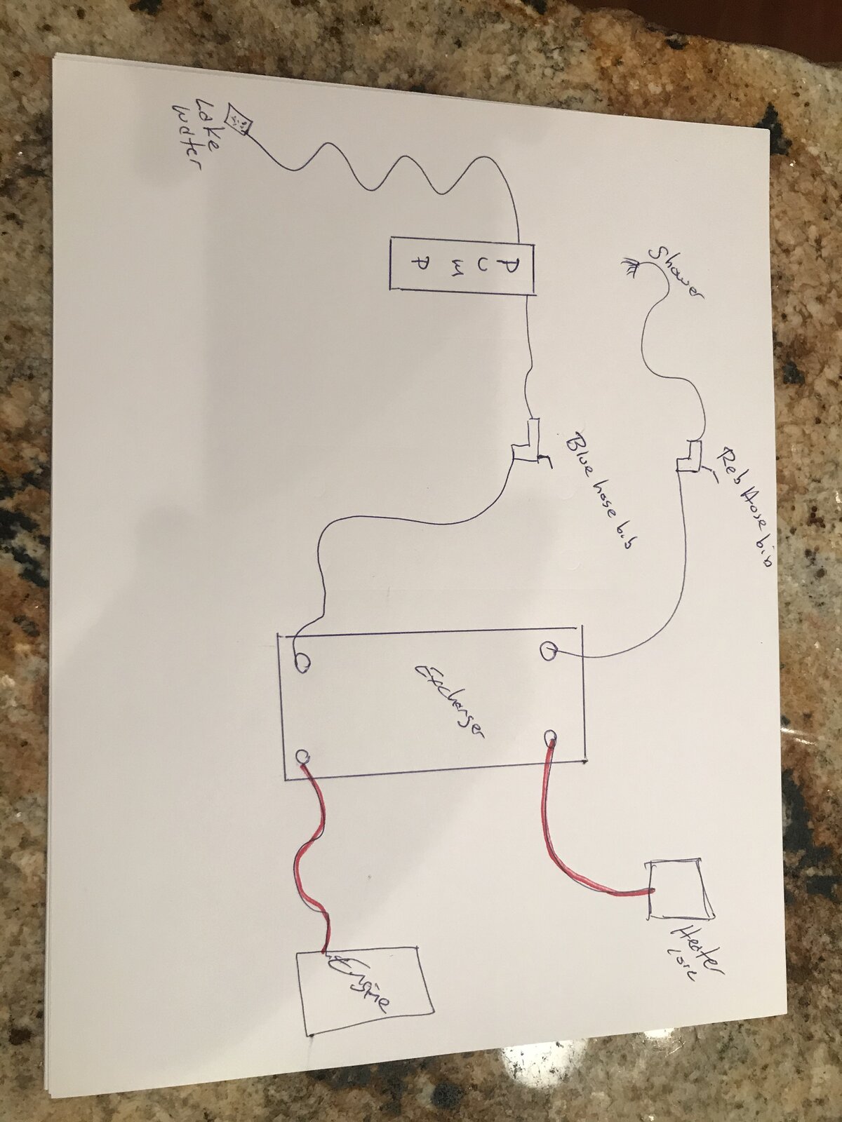

I use a Plate Heat Exchanger that I got from Duad Diesel https://www.dudadiesel.com/heat_exchangers.php and mounted it under my battery. Then it just a mater of cutting the hose going to the heater core and connecting hoses. If you decide to go this way let me know and I can give you some extra info

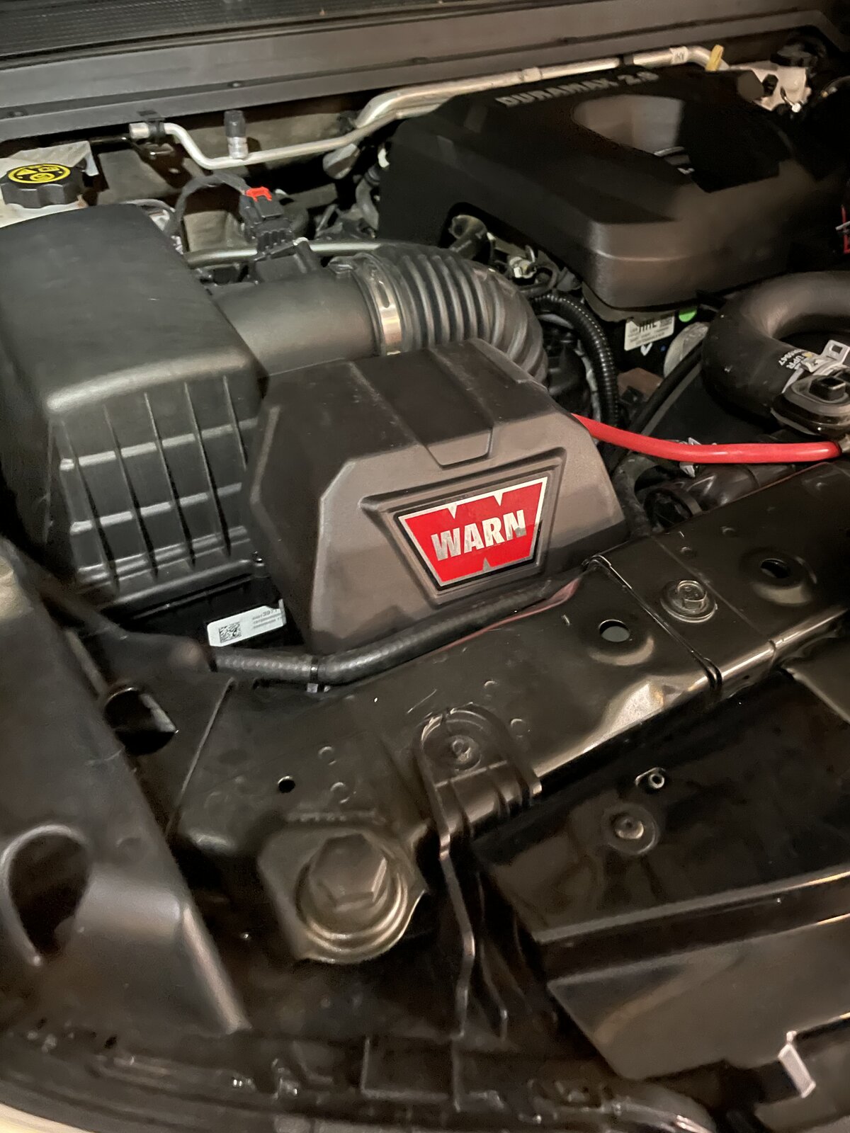

Installed the winch last night. We relocated the control pack to under the hood, as in the enclosed bumper there was no way to access it. AEV sold a nice kit so it looks pretty clean
Next I have a compressor mount for my dual arb to install under the coolant reservoir, and then eventually a mount for my spod by the window washer reservoir and cleaning up the wiring. Should be super clean when everything is done with everything having it’s place.

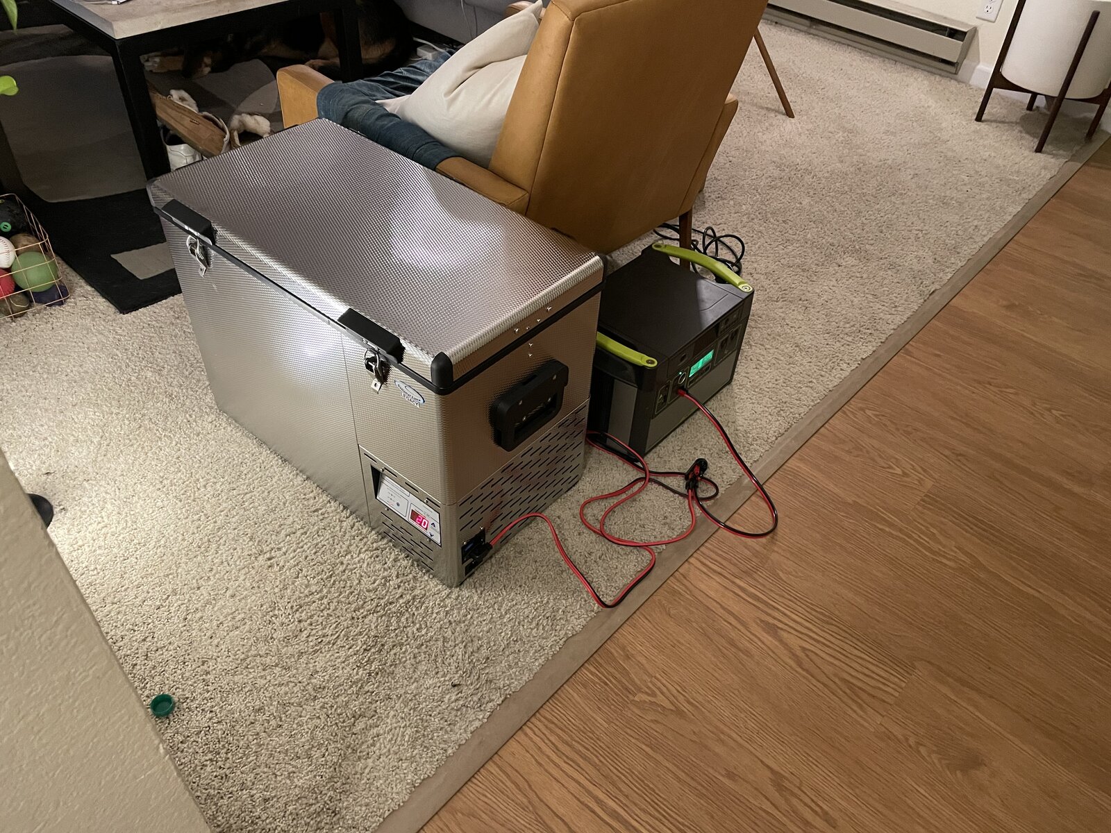

National Luna came real quick, two day free shipping from Equipt Outfitters and it was packaged really well. I returned the dometic. The lunas DC cable came with what I believe is called a hella plug. I switched it out to an anderson, matching the other side which plays more nicely with my goal zero and it’s running.
