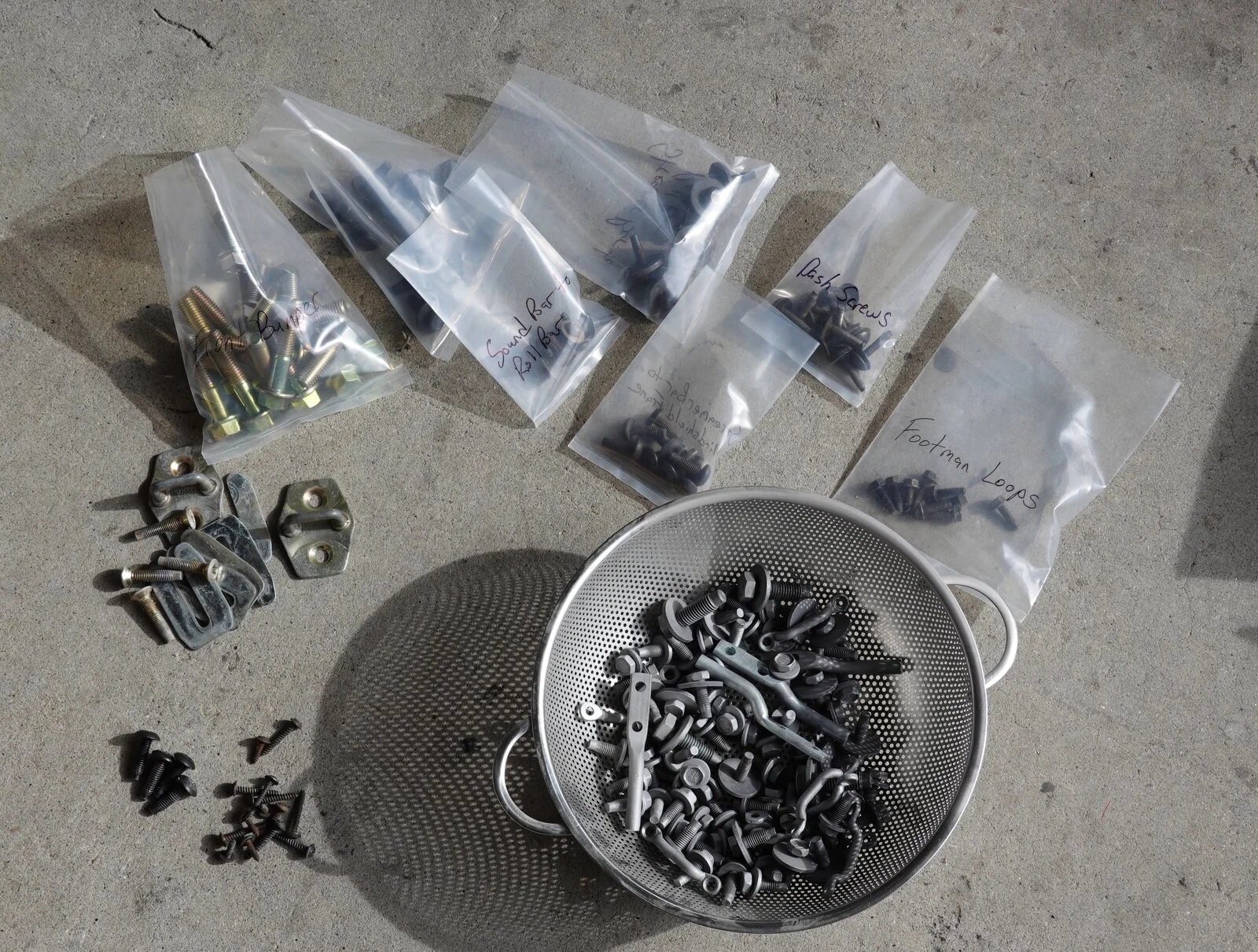

I just want you to know that you are a rank amateur when it comes to accent color crap. I just spent the last two days bead blasting the paint off of 10 lbs. of OEM fasteners to send them out for Olive Drab Hexavalent Zinc coating so I don't have to deal with chipped powder coat or automotive paint on the heads when I reassemble. I also hunted down and sourced 50 pieces of 3/8-16 x 1.25" hex head captive free spinning washer body bolts to send along for all the cage attachment points.
Along with cowl screws, dash screws, door strikes, footman loops, and a few other odds and ends.
Wait I just re-read this - hexavalent? You can actually get hexavalent plating done in California in 2022? That's been all but banned in most places, starting way back in '06 with RoHS in Europe. I was still working in the vehicle industry back then, and it was a mad rush to figure out how to comply with that...

Not in CA. This is what they told me to specify.
https://www.gattoplaters.com/olive-drab-zinc-plating.html
Thanks, mrblaine - Looking at their website, they're an "old school" plating company. Not many of those left. That is a true hexavalent process, which is much more durable than trivalent, and it's OD green, to boot! The Europeans decided that the trace hex chrome washing off fasteners in cars needed to stop, and that decision changed the plating industry over a very short period of time. Since then, most platers converted to trivalent (or other processes altogether different), and the hex guys are few and far between. The movie, "Erin Brockovich", was partially responsible for this rapid abandonment of hex chrome. I'm putting that one in the "Rolodex!"
