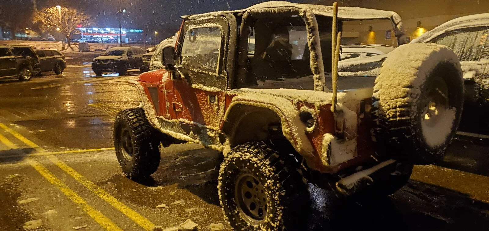

Ohio too!

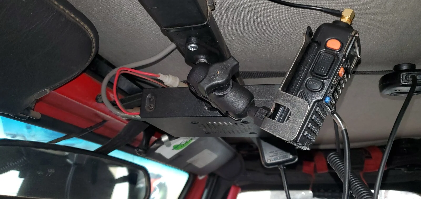

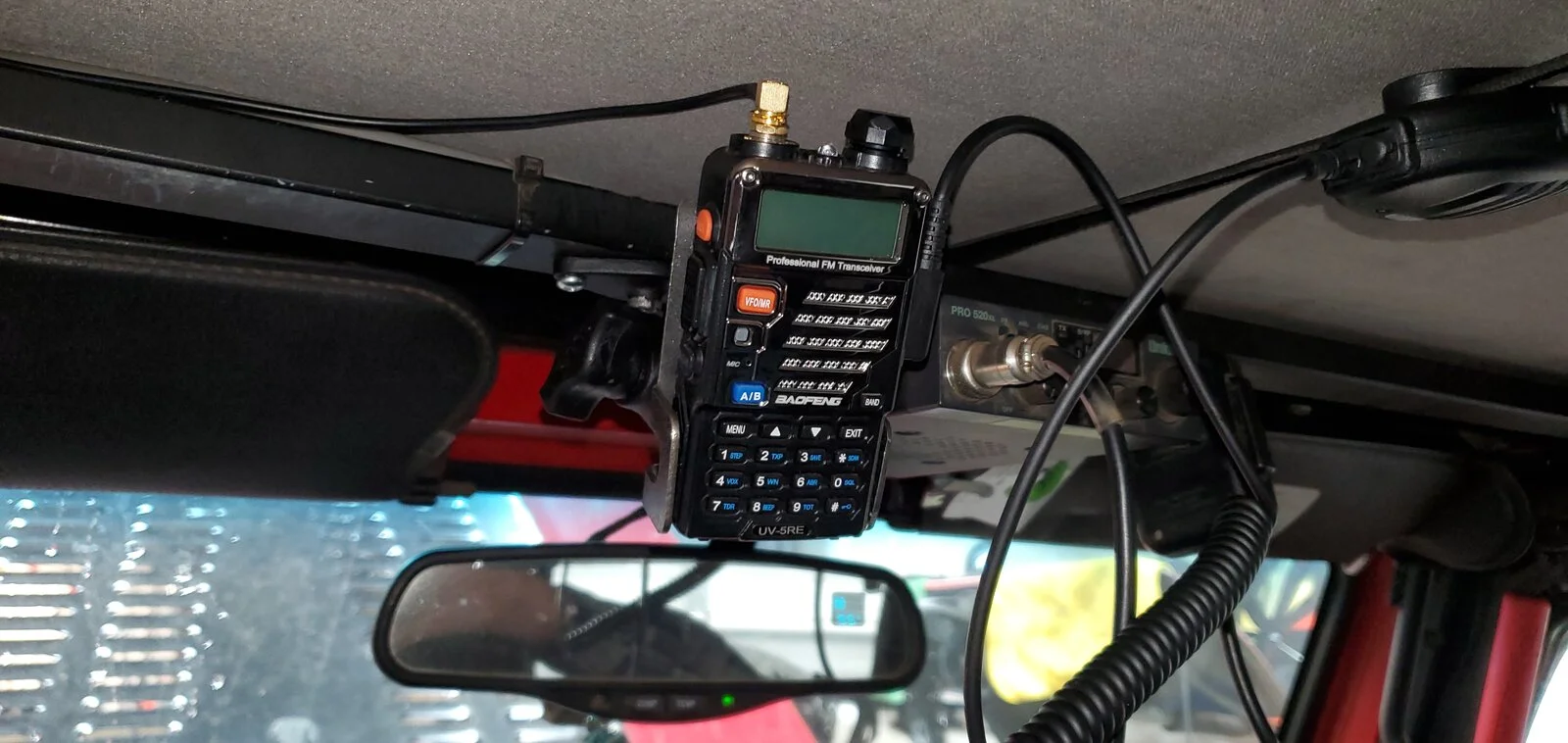

What's the UV-5R mount? Looks like it cradles it really wellScrounging to get Moab ready. Oil change as we speak, mounted my radio while it's draining. Still need to set my toe and tie up the front driveshaft. And fix my door handle from the inside...View attachment 245750

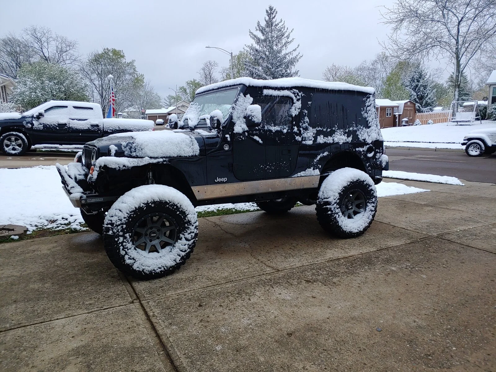

Is the TJ on the street yours too?Ohio too!View attachment 245751
Yes. 04 RubiIs the TJ on the street yours too?
I picked it up off ebay. It's a metal version. I'd like to weld a mic arm to it. Still need to paint it too but I'll do that laterWhat's the UV-5R mount? Looks like it cradles it really well

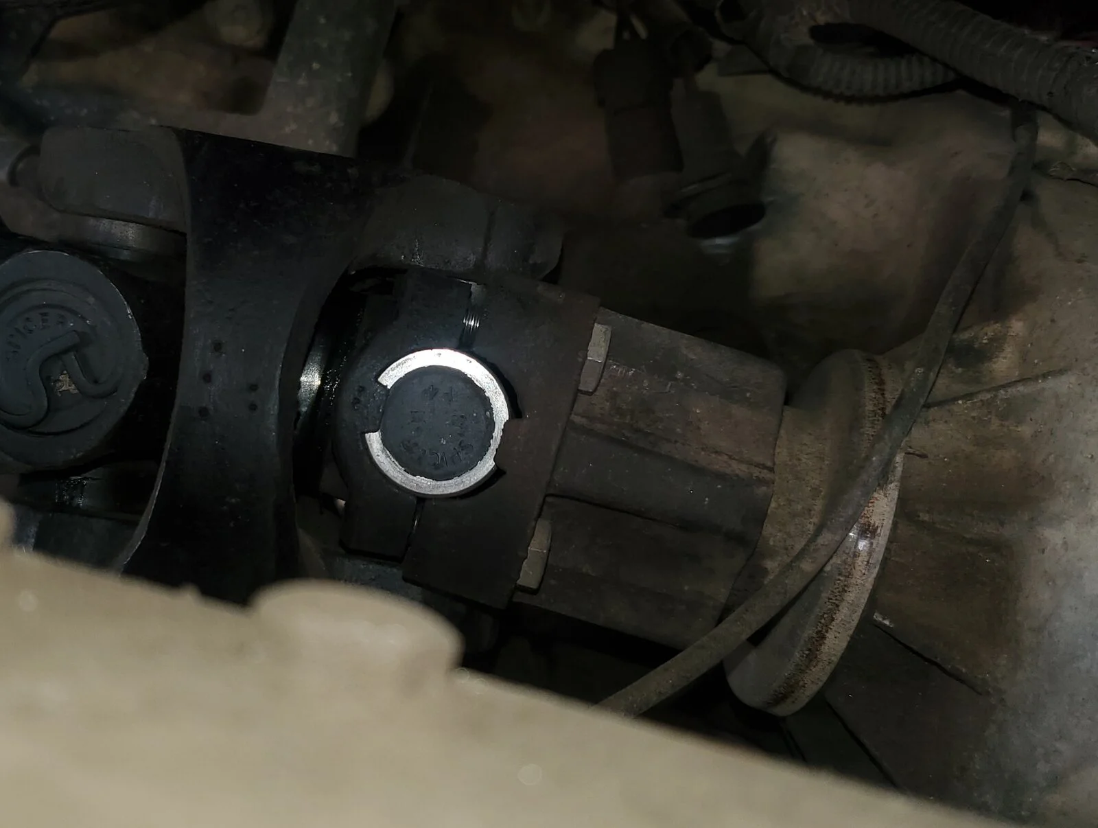

Missing one completely, other three were very loose. Pulled everything and it feels fine. So reinstalled with loctite. Initial drive and I am vibe free!It it me or does it look like the top bolt is loose? Backed out?
good thing you found that today. that's not something you wanna find the other way.Missing one completely, other three were very loose. Pulled everything and it feels fine. So reinstalled with loctite. Initial drive and I am vibe free!
