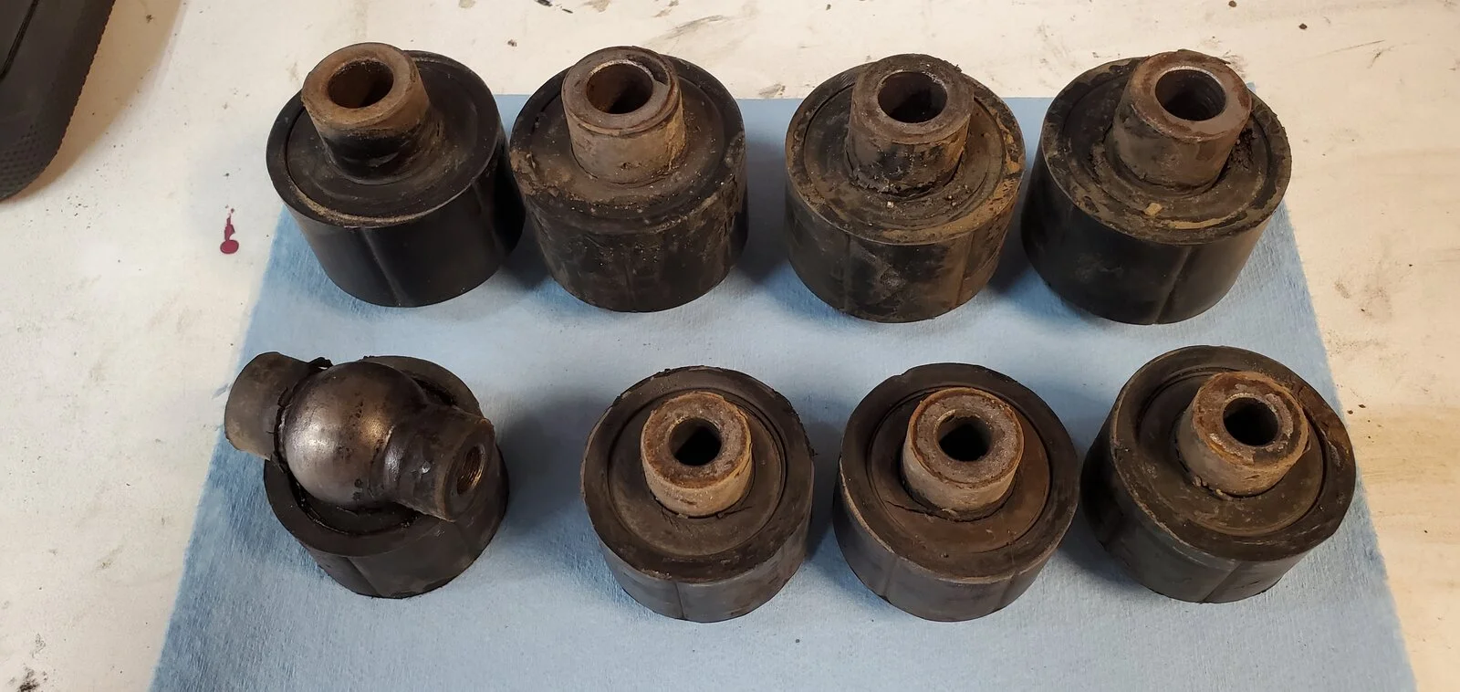

That looks as bad as mine were... You'll notice a difference.Got started on the metalcloak bushing replacements, just the rear lowers tonight
Maybe 80k give or takeHow many miles on them?

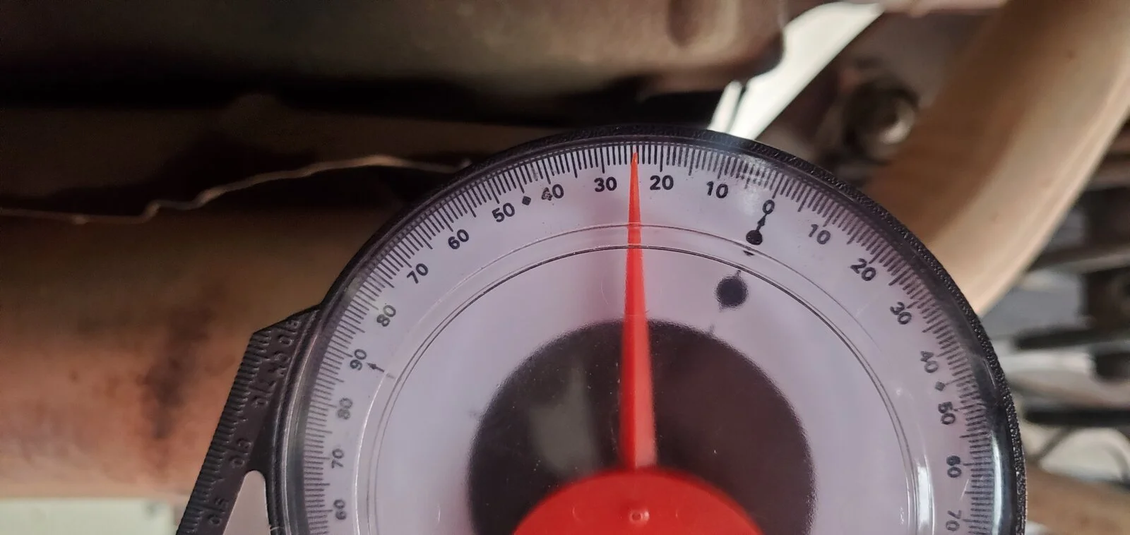

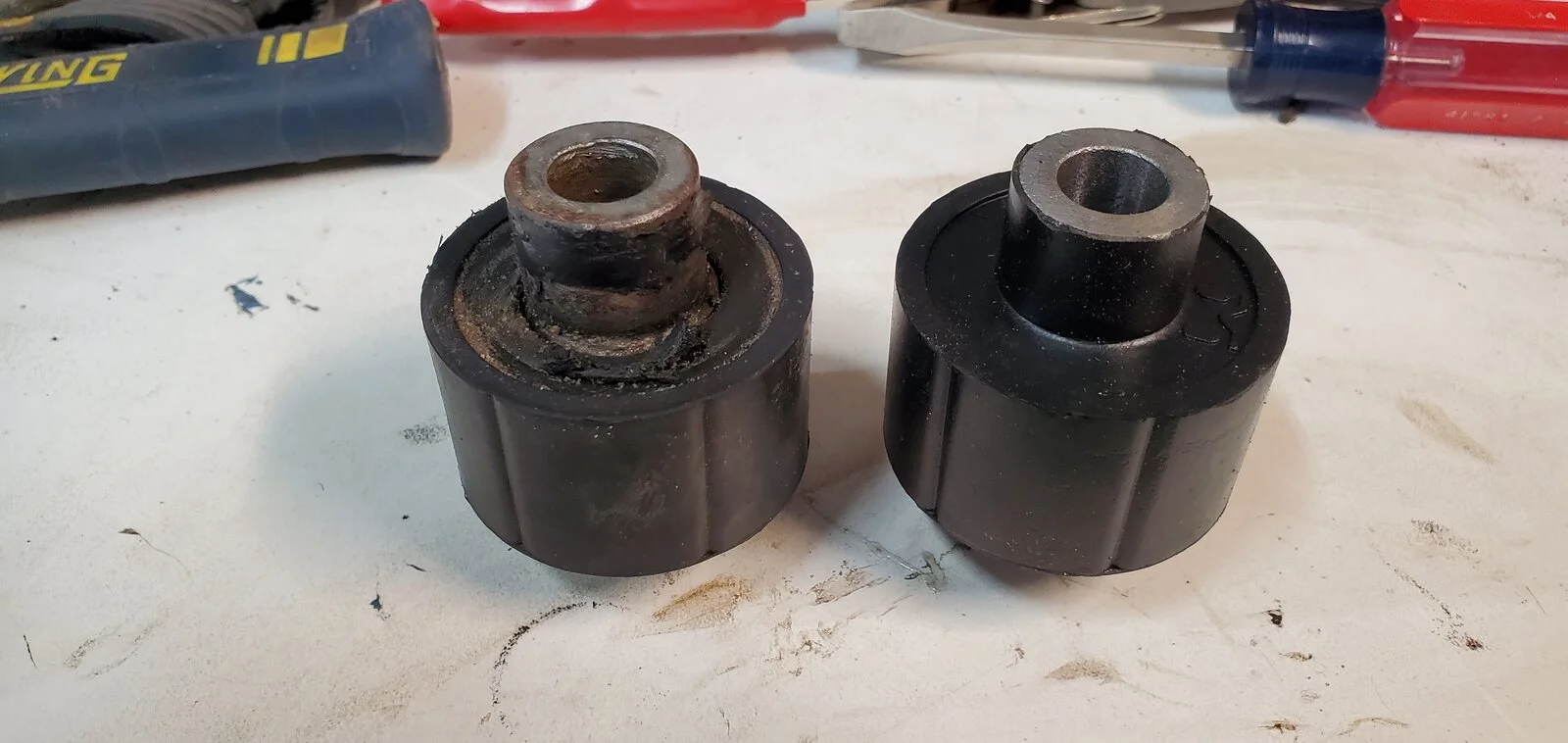

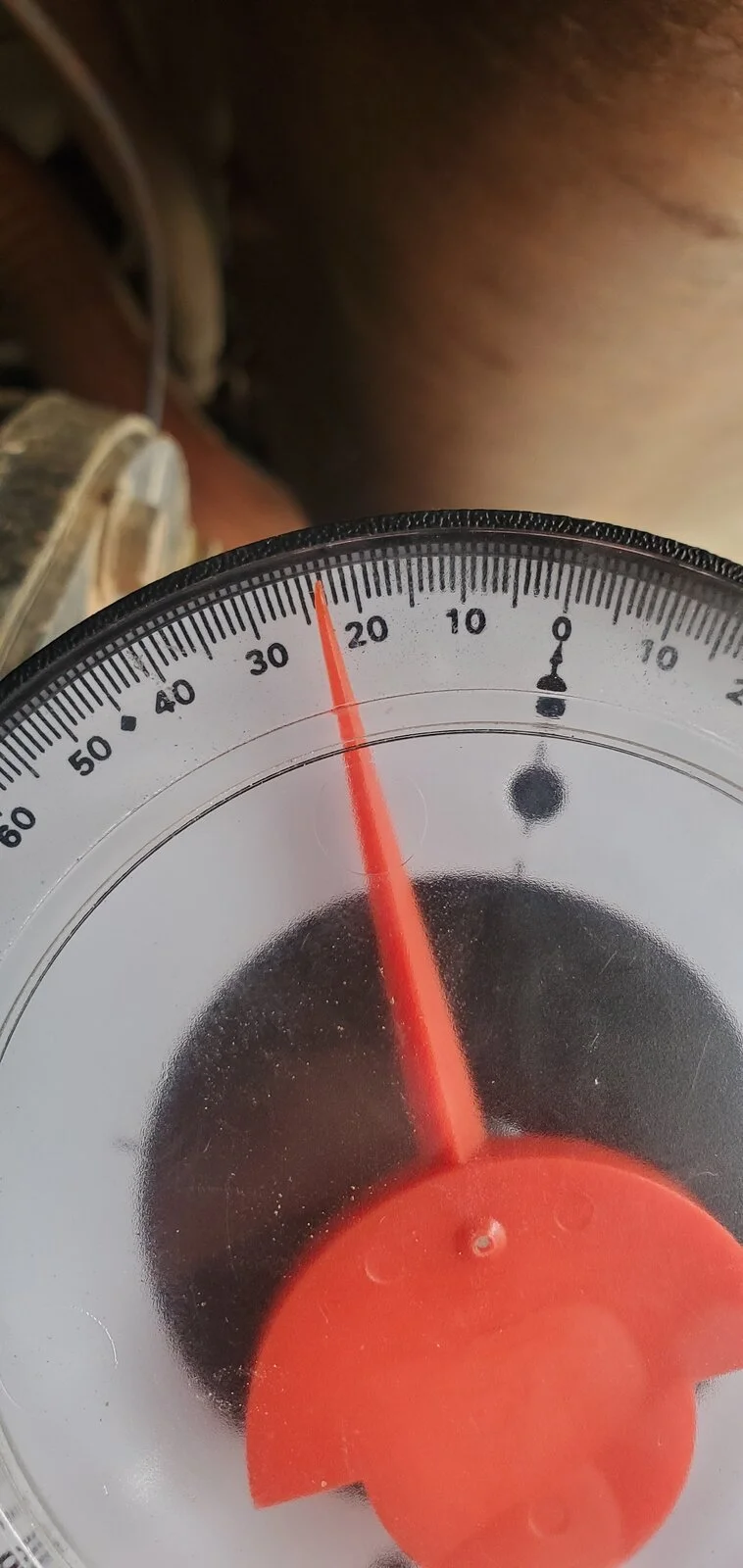

Did you see any movement in the arms as a result of this?These were pretty bad. 3 of the balls would spin inside the rubber bushing (supposed to be bonded) and one completely fell out when I removed the arm
I can only imagine there was. A couple of them easily had 1/8" of lateral movementDid you see any movement in the arms as a result of this?

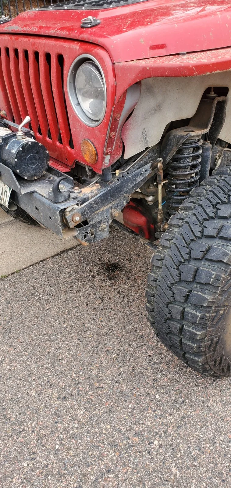

Its a NAPA brand pump that has been on for 3 weeks and maybe 500 miles. My guess is the gasket surface wasn't clean enough.new water pump?
