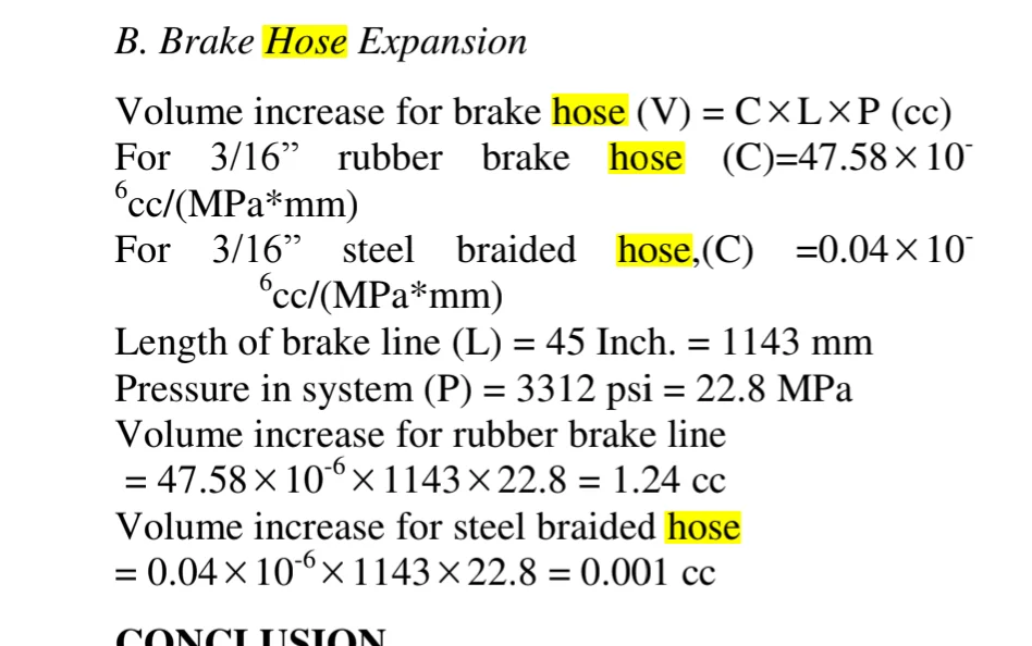

You're a testing guy. Do a simple test and afterwards you'll figure out that (a) either your existing lines were deficient, (b) you're dealing with confirmation bias. The test is simple and I did it at higher pressures than most can generate. I have a vacuum booster system in Kat's rig that is capable of 2800 psi. I hooked up a Goodridge SS braided line to the system and used a pair of very nice calipers to measure the relaxed and expanded diameter between 0 and 2800 psi. Then I did the same to a new OEM rubber flex hose. They both expanded exactly the same amount under the same pressure which sorta makes sense since the design burst pressure for both is typically in the 3000 psi neighborhood.Well...
