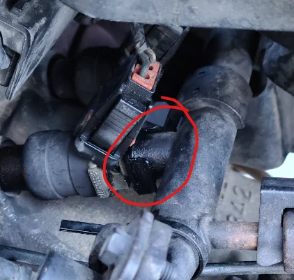

Hey Jerry, I was thinking about replacing my injectors until I saw this thread. I appear to have a fuel leak from an injector. you think from where the wetness in the photo is that its the o ring rather than a bad injector? this is a 97 se 2.5
Hard to say. I'd start by replacing the o-rings first as they're the least expensive potential fix. They're available in kits for all four and it's an easy job.
