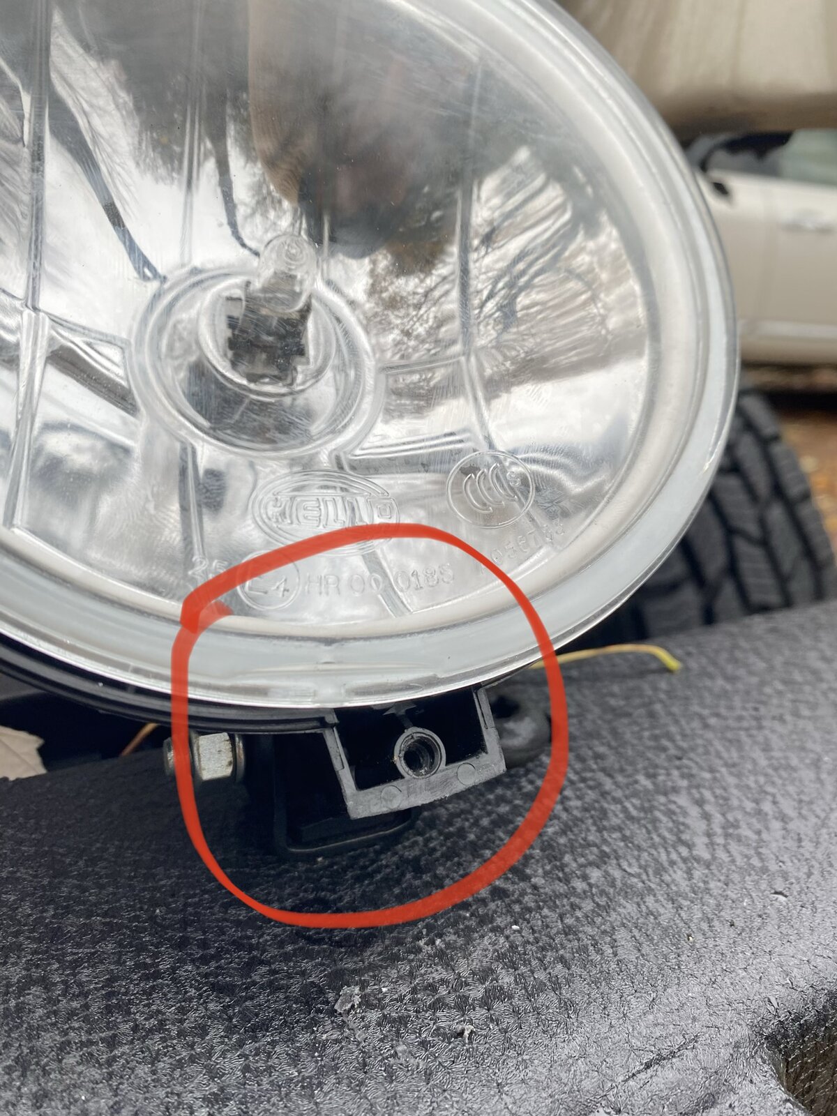

Did this really cool, totally free mod where I take apart my factory fog lights and then lose the critical piece that holds the light into the plastic fixture, so now I've got a fog light flopping around...
Anyone know where I can buy the piece that screws in to hold the light in place? I'd rather not buy an entirely new light, but I'm afraid I am...excuse the pun...
screwed.
Anyone know where I can buy the piece that screws in to hold the light in place? I'd rather not buy an entirely new light, but I'm afraid I am...excuse the pun...View attachment 202796screwed.
Those are not factory fogs right? If not try and find the spec from the manufacturer and then pickup a bolt at the hardware store or Mc Master Carr. If it is factory then you should be able to get the size from the factory parts list (posted somewhere here) and buy from hardware store or McMaster Carr.
Here is the nut part number and size. 6101 445 2 J NUT AND WASHER, Hex Nut-Coned Washer, M8 x 1.25 . So it looks like you need an M8 x 1.25 stud. I have found Metric studs at Ace. You might want to remove the stud from the other housing so you can get the exact length required.

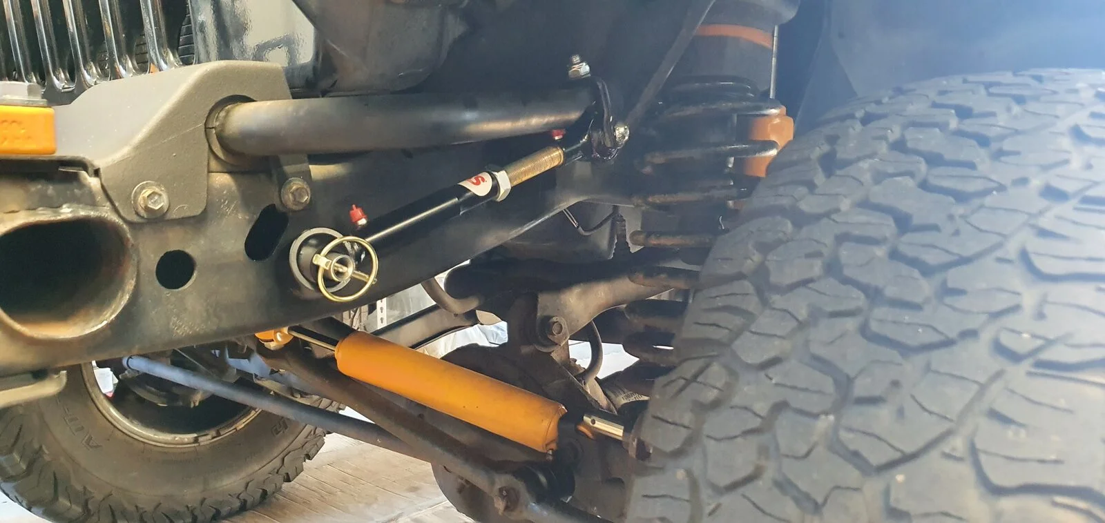

Finished my jks quick disconnects install.
May want to grab a couple extra lynch pins to throw in the glovebox. I learned on my first trip with my JKS disconnects that my tires could rub those holder pins and they took off the lynch pins. Looks like you may have 10.5 from that pic (could be the pic angle) so maybe not an issue. The lynch pins are cheap enough at the local hardware store.
Reactions: BeavisTJ
X2 to this. I had one break not long after install. Called JKS and they sent me a whole bag at no charge. They ride in the glovebox at all times.
I ended up removing the frame pins and going simple with bungy cords on each side and hooked into the fender reinforcement bracket. Simple and cheaper than continue buying lynch pins.
JKS disconnects have performed well. I found they were looking for a lube every 2500 miles, about half way through my normal cycle for the rest of the front end.
I'm going to an Antirock this winter but the JKS have served me well for the past 12 years. Just keep them lubed.
