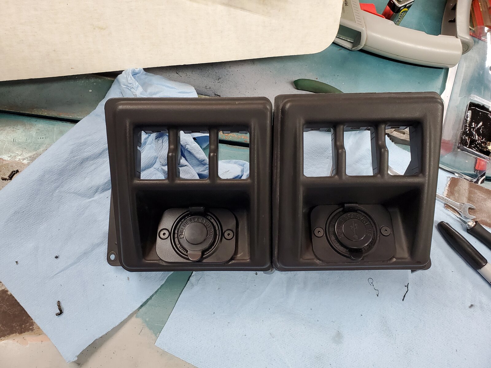

Thanks to @dschwes for a wiring pin on the back of the cluster, and @mjtjnj for a deal on a used a/c panel, I finished up the hard top wiring job and added an aux switch pod where the ashtray was today. That is to say, I finished the job. Today. I didn't do, the entire job...today. LOL. Just....put the finishing touches on it.
The dash harness I bought was for a different year, so I grafted the necessary wires onto my Jeep, but needed 2 wires to connect to the cluster. Found one at work and dschwes sent me the 2nd. Thank you, sir!
Once I had verified everything would work, it was time to add the switch pod. I'd watched all the videos and seen the threads. Nothing left to do, but.....do.

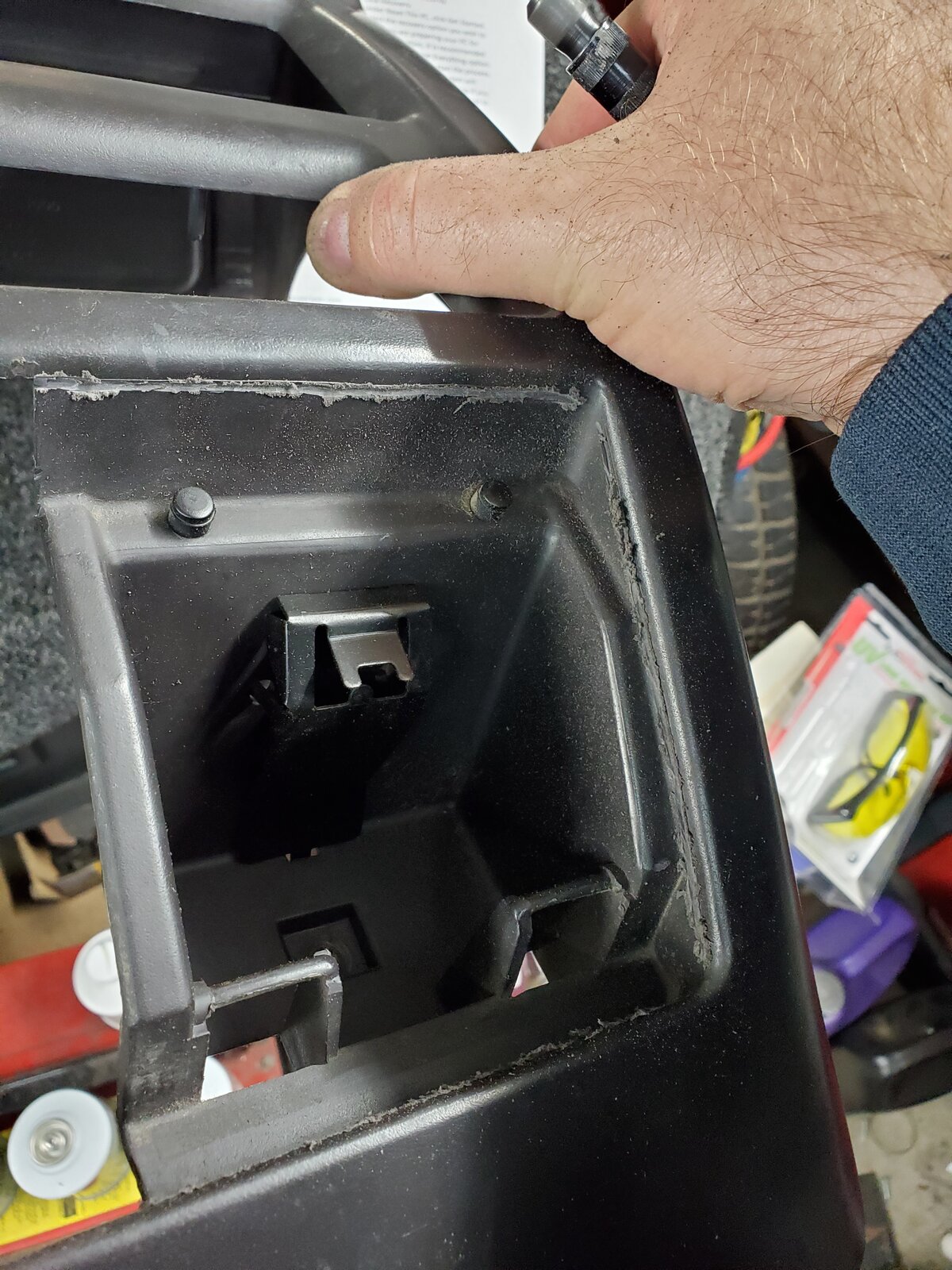

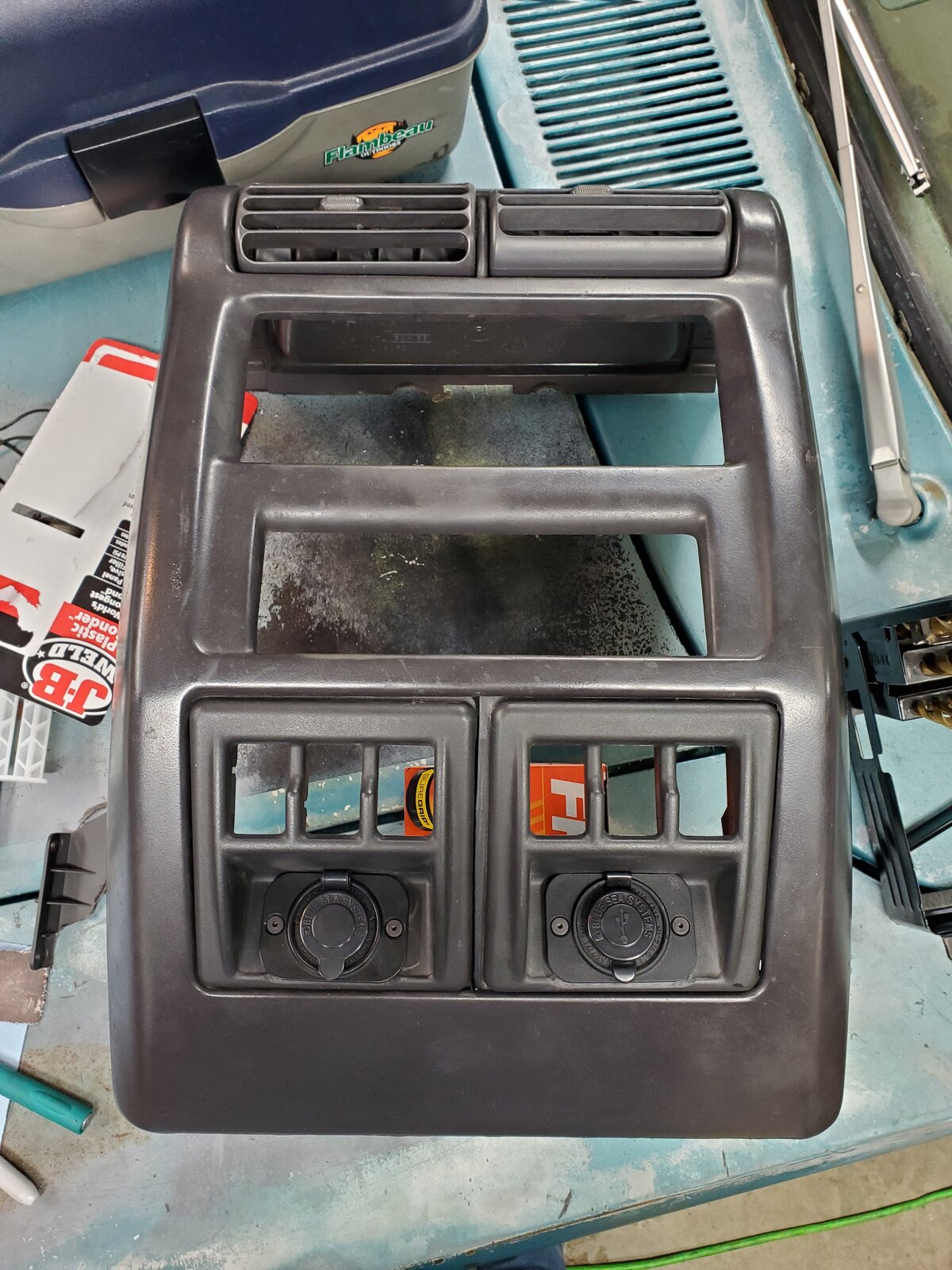

Cut the ashtray pocket out:

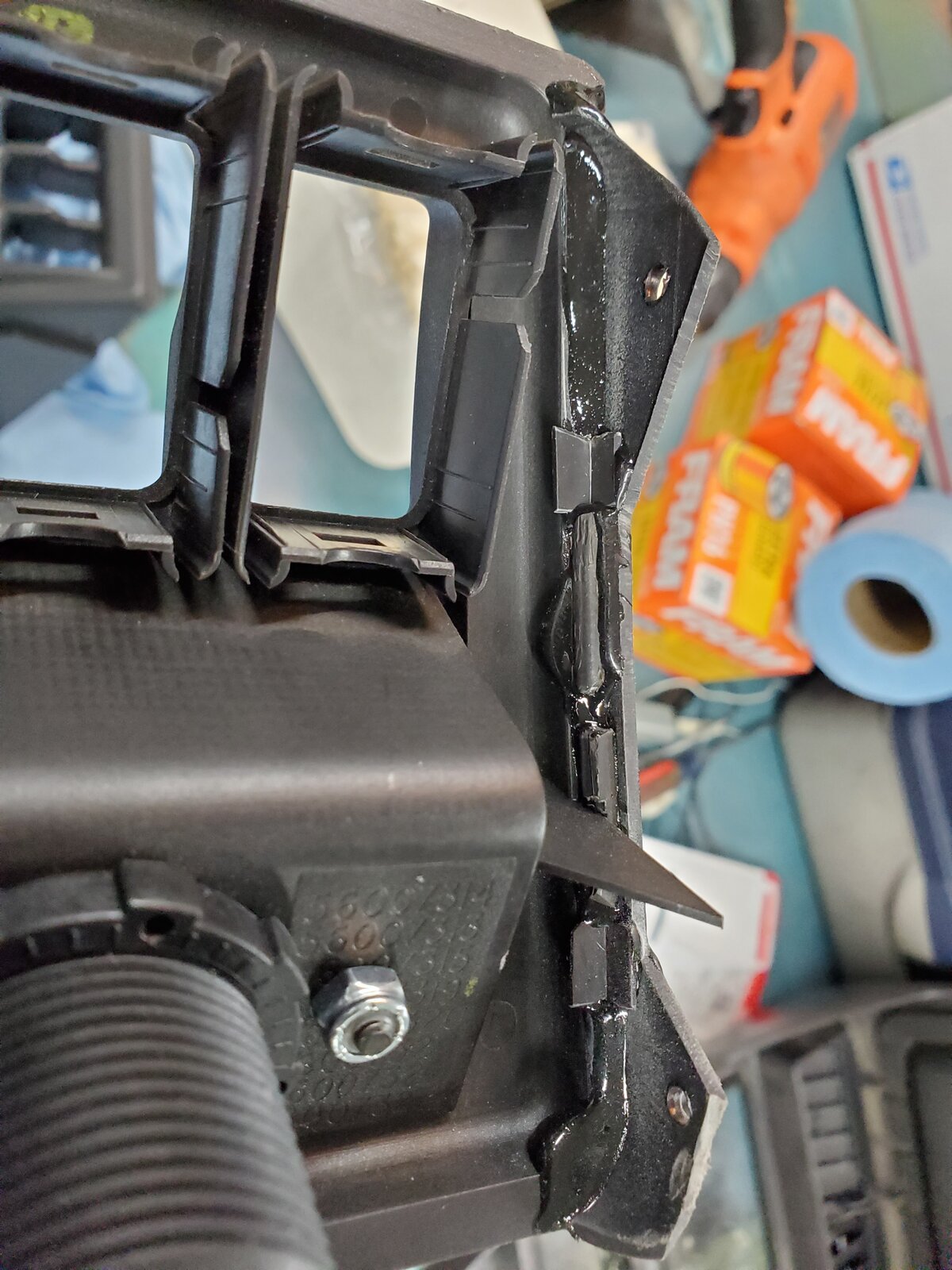

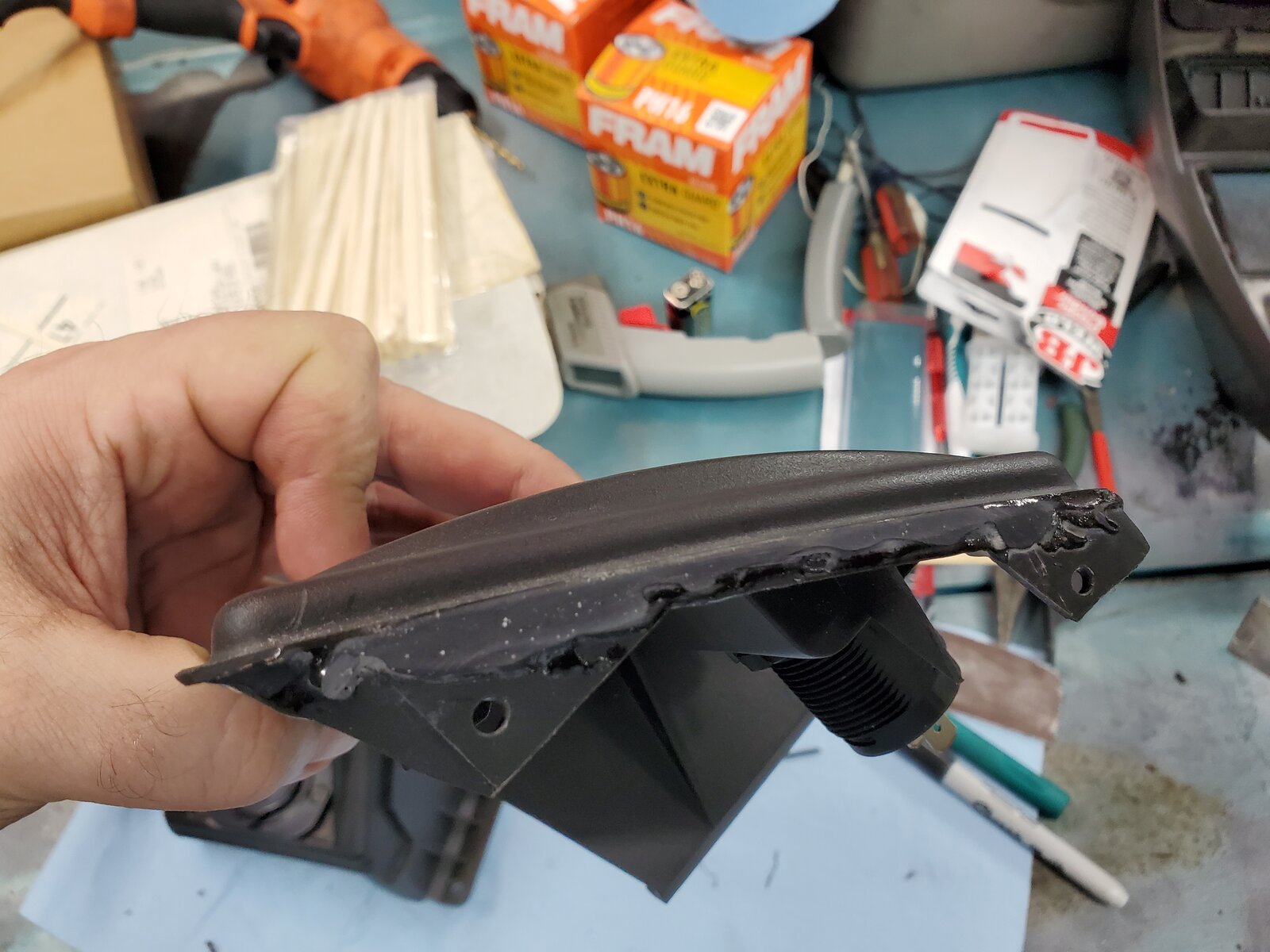

Carefully cut the edge off the new pod and moved it over a hair and used some JB plastic bonder to glue it back on. Used some small bits for reinforcement:
Trimmed the opening on the right side just a hair for the right pod to snug up cozy-like.

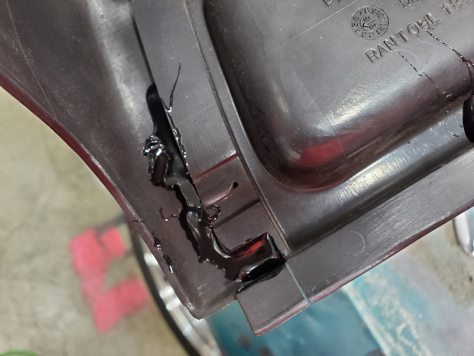

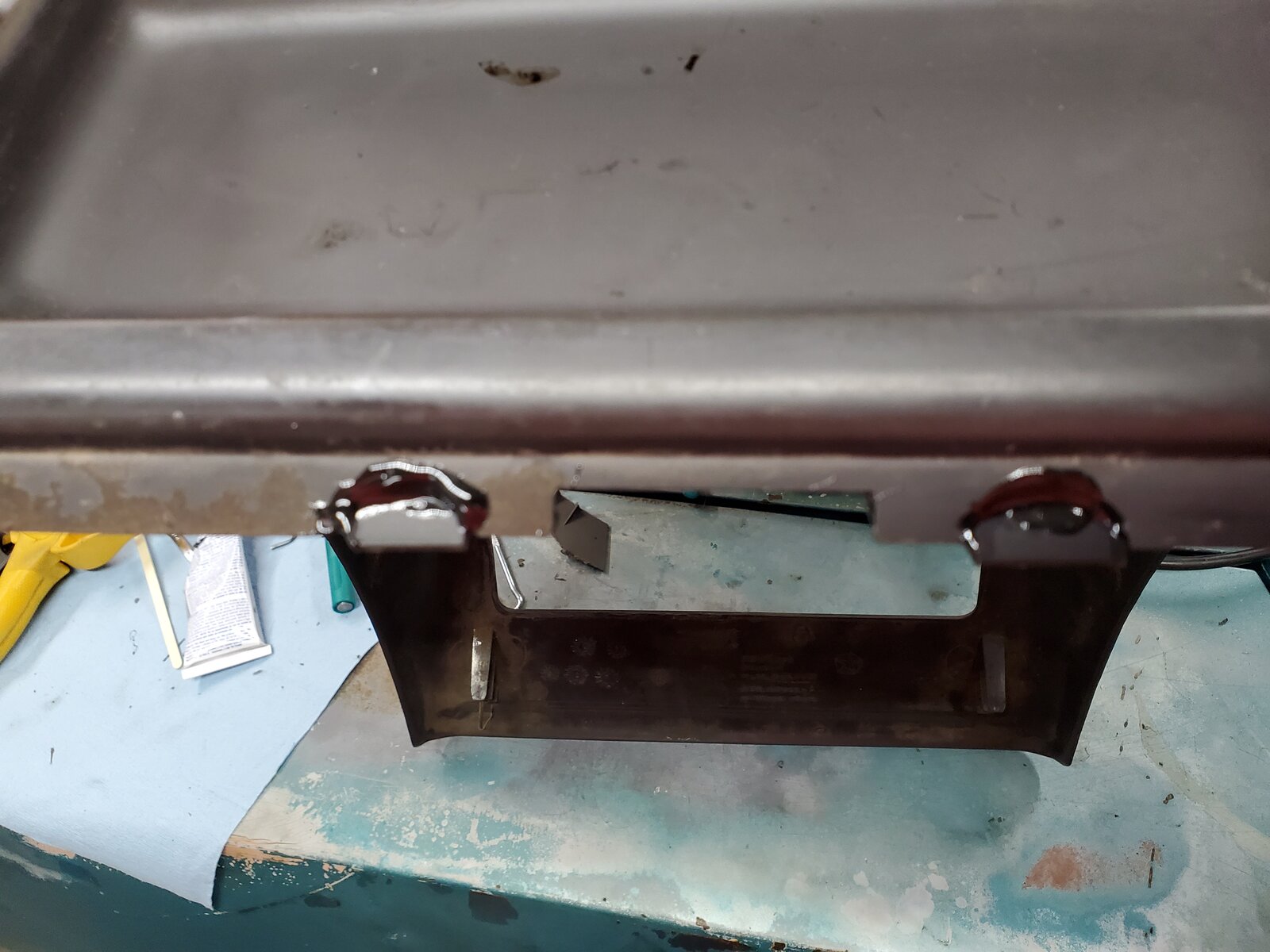

Needed to fix up some parts of the less than perfect (LOL) center bezel:
Small bits made up new tabs. A bit short, but just long enough to reach the screw hole:

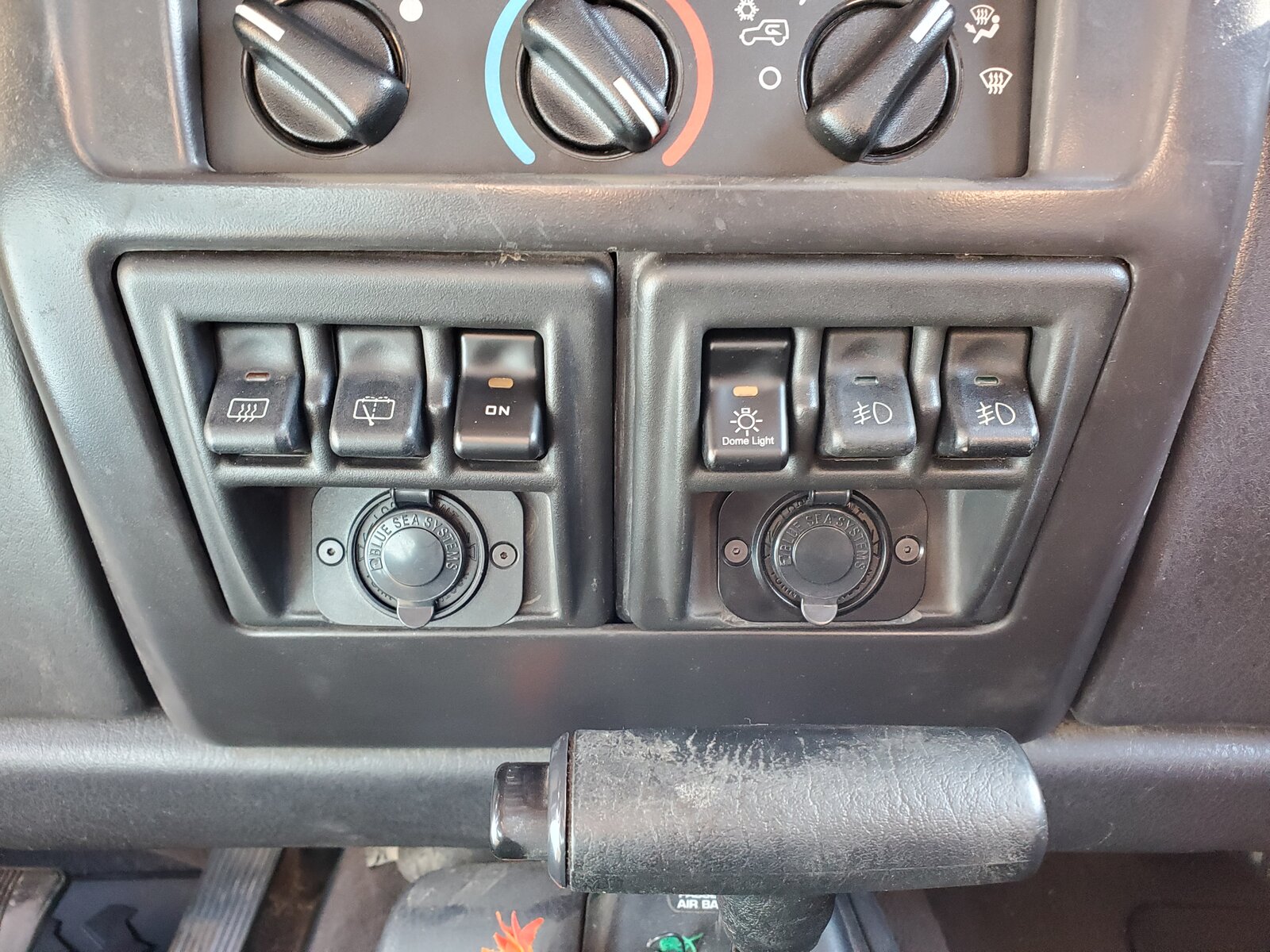

Pods joined at the hip:

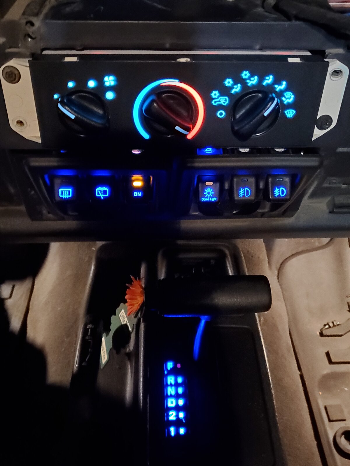

When I put LEDs in the a/c panel last year, I must have had the lights on when installing/removing the LEDs for polarity and burnt one of the tracers on the printed circuit inside the panel. I rinky dinked a fix by soldering a leader on the backside of the LED bulbs to provide power to the 3 bulbs. Worked, but somewhat fragile. Picked up a used panel off the forum here from mjtjnj. Swapped the printed circuit into my panel (saved my other mods that way) and installed new LEDs. Also picked up a couple OEM switches, swapped the aftermarket "ON" and "Dome Light" rockers onto the OEM switches, so now all are backlit at night.

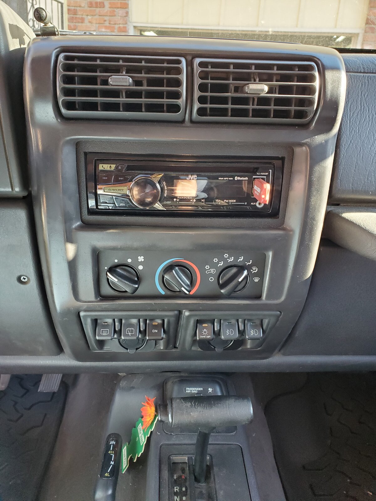

I'm digging it. Bummed to find out the cigarette circuit is only hot with the key on, so I'll have to rectify that on at least one of the power sockets the next time I have it all apart. So far, the JB plastic bonded fixes are holding, but time will tell.
Glad it's done.
Glad it's done.
Glad it's done.

What switches are you using I like that they light up at night I have oem it’s like brail at night

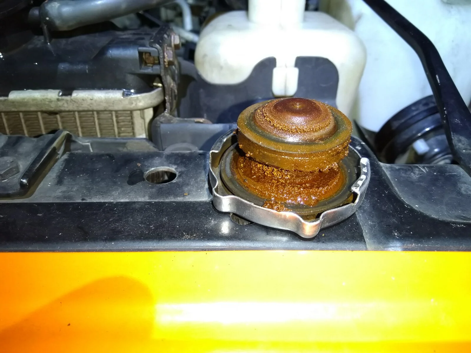

Changed thermostat and seal. Seal was leaking and i got tired of adding coolant constantly.
New radiator cap came with the set and i changed that also. Old cap was covered with this rough/hard brown thing. Is this something to worry about? To me it looks like rust. I dont think it has anything to do with oil in coolant, but i may be wrong :)
New radiator cap came with the set and i changed that also. Old cap was covered with this rough/hard brown thing. Is this something to worry about? To me it looks like rust. I dont think it has anything to do with oil in coolant, but i may be wrong :)View attachment 207951
When was the last time you used a chemical flush on your cooling system?

I have owned this vehicle for 2 years now and have no clue if flush have ever been done.
I think ill do that asap.
That's a great idea, especially from looking at that cap. I think it costs me around $25 for everything (antifreeze, flush). Mine was done by the PO several times and I did it anyway. I do mine every 2-3 years because it's WAY cheaper than replacing a clogged heater core. Mine now runs at 205 instead of the 210 that is normal.
The icon on the OEM switches should light up when you turn your lights on. If not, a bulb may be blown like someone else mentioned. The little orange indicator above the icon only lights up when the switch is ”ON”.
There is a couple company’s that make OEM style switches, but the icons don’t light up. But, you can make them light up...
