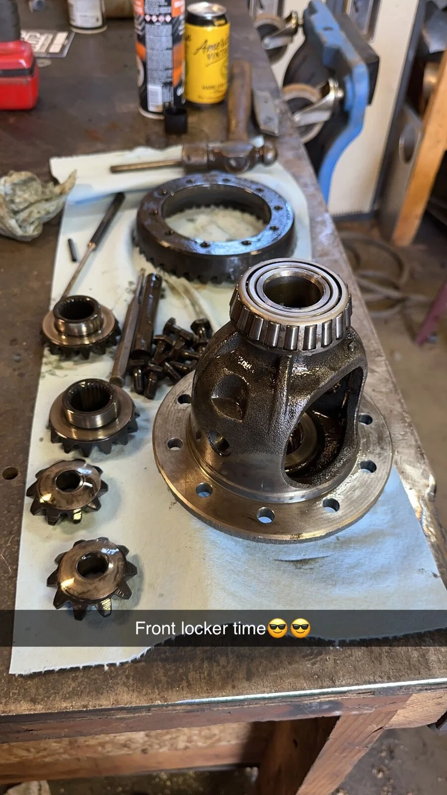

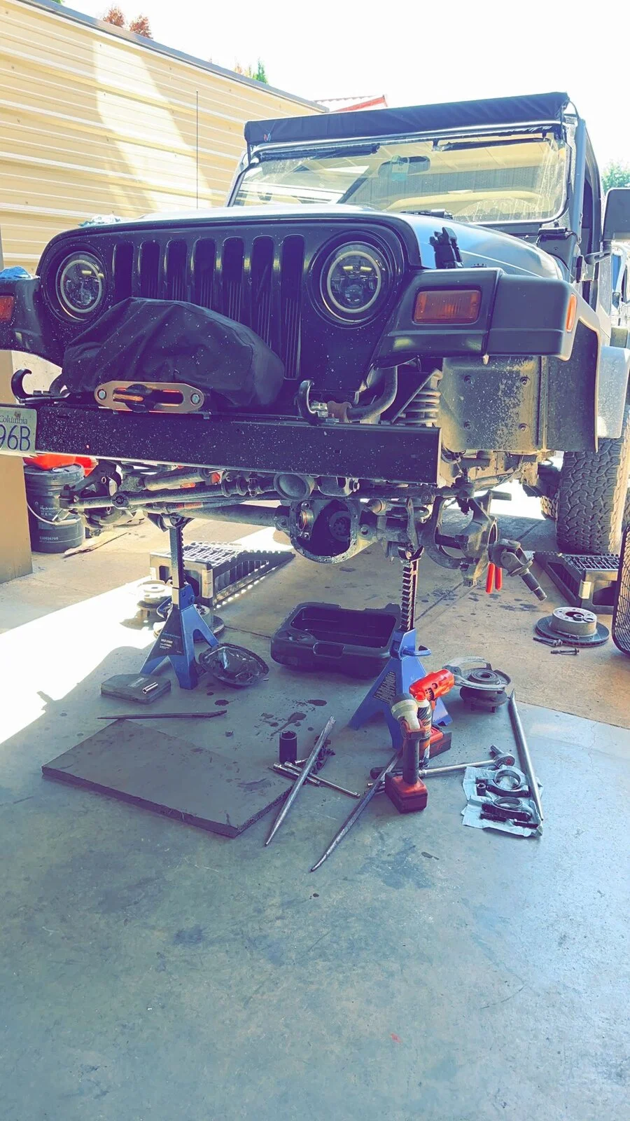

Slapped in a Powertrax No-Slip "drop in" locker.....
It was anything but "drop in" but with cold beer and some pizza we made it happen. Instruction book was for a Dana 30 rear so that made it interesting trying to guess what we were missing.
I haven't really had the chance to really test it out yet in some loose gravel/sand or how it behaves in a tight and twisty trail.
Definitely wasn't excited about pulling the carrier to get this thing installed but that's the way she goes sometimes.

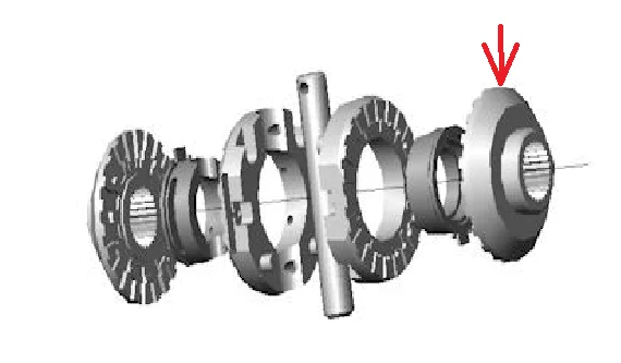

It seems to be OK on the street, near silent when turning to the left but clunks a bit turning right. Not really happy with the final fitment of the new part despite having installed it just like the install manual explained. Both outer pieces shown in the image below seemed to have a bit more play than expected despite being installed correctly so that may be why.
Never got a picture of the locker once it was in unfortunately, summer heat and greasy hands was the cause🥵🥵

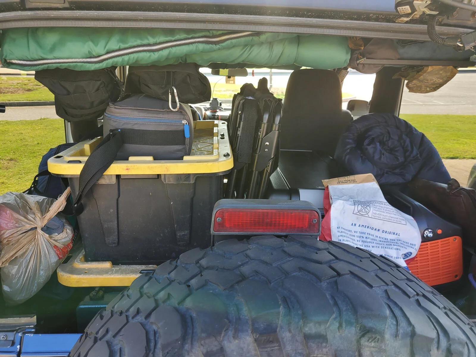

Loaded it up last night for a quick overnight camping trip. Gonna take my future son in law hiking. I remembered to adjust the rear shocks so I could gauge the ride on my way to work. These shocks are awesome. They handle this extra weight like a boss. It'll be cool to see how they do off road this afternoon.

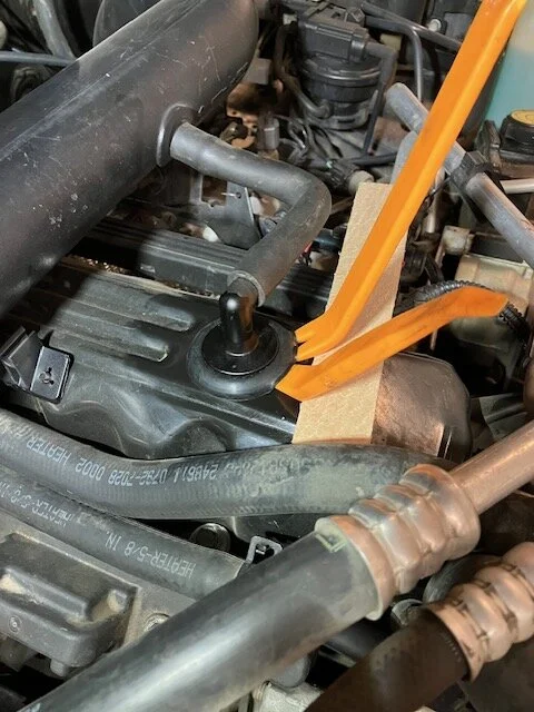

Got any tips for this job? I have the parts to do it but haven't had the motivation to get it started yet.
The plastic is most likely brittle and there is a good chance it will crack into the top of the engine if you try and remove with the valve cover on.
Pull the valve cover so you can push them out ( or pick up the shattered pieces) Also a good opportunity to replace the valve cover gasket.
They've been shipping the wrong manual with it for some time - #8221003A is the one you need. I think you can download it from their website.
Ahhhh, do you like your future son-in-law???
That’s why he is taking him hiking, see if he can find his way back 😂
Yes, we like him very much. He is very intelligent and a positive and calming influence on our daughter. But yes, he has been dealing with all kinds of jokes since we made these plans.
"One way hike . . ."
"Remember to leave a bread crumb trail . . ."
etc.
Plus some not G rated jokes as well.
Taking the valve cover off would be easiest, of course one of the first things I did when I got the Jeep was change the VC gasket, wish I had known about replacing the grommets then. Decided to roll the dice and try to get them out in place. I don't think there's any way you can pull the inlet elbow or PCV elbow out of the grommets, the rubber inside the cover is too hard. I used the stoutest plastic trim removal tool with a bend that I have and a tiny little pry bar under the lip of the grommet. Had to place a 1/4" thick piece of wood on the VC to pry against to give more leverage to the pry tools. It's fussy but with steady pressure and both tools prying side by side the grommet finally slipped out and didn't lose a bit. It was impossible to get the elbows out without cutting the old grommets. The PCV valve flows air but I'll replace it. If your VC gasket is leaking it makes sense to take it off and get 2 things done. I used Dorman grommets and the fit is good and snug, I expect them to last longer than I'll own the Jeep.
