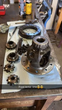

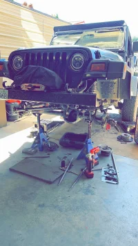

Slapped in a Powertrax No-Slip "drop in" locker.....
It was anything but "drop in" but with cold beer and some pizza we made it happen. Instruction book was for a Dana 30 rear so that made it interesting trying to guess what we were missing.
I haven't really had the chance to really test it out yet in some loose gravel/sand or how it behaves in a tight and twisty trail.
Definitely wasn't excited about pulling the carrier to get this thing installed but that's the way she goes sometimes.
It seems to be OK on the street, near silent when turning to the left but clunks a bit turning right. Not really happy with the final fitment of the new part despite having installed it just like the install manual explained. Both outer pieces shown in the image below seemed to have a bit more play than expected despite being installed correctly so that may be why.
