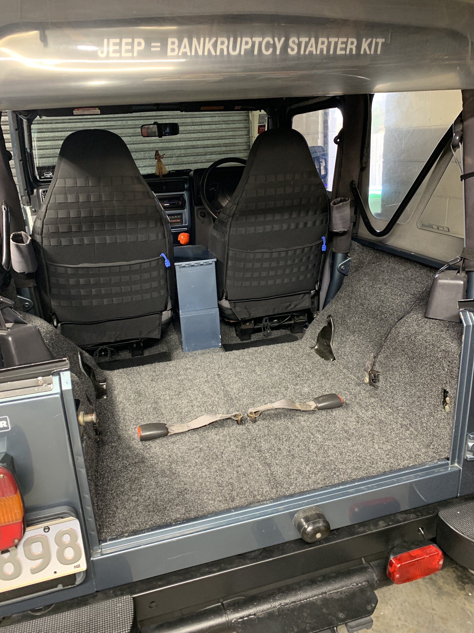

Dug out the control cable for the CD changer, and all the other factory brackets and fasteners … hopefully reinstall will be a breeze for @Mike Z !
Looks like the cable had extra length in it for LJ installs. 👍
