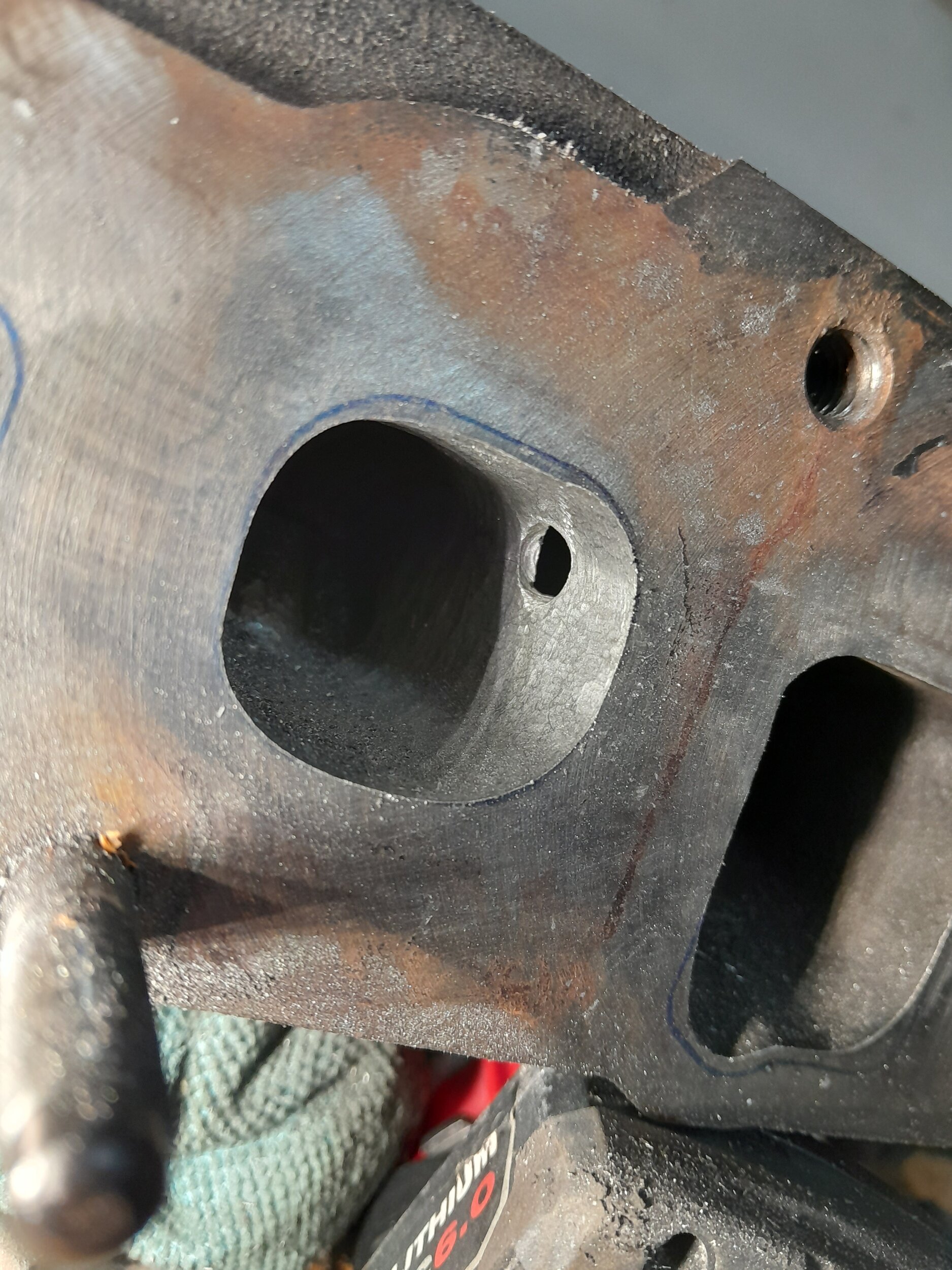

Well I learned a new lesson
2 cylinders in from the front of the jeep there's about 3mm of cast iron there 🙃before you get to the water jacket
So yeeah....880$ Clearwater head going to the dump.....I may try and tig it and repair it but my cast iron welding abilities aren't the best for cylinder heads.....due to them being a Giant heatsink aaand it's the exhaust side so it's gonna very hot and I don't know if a weld would last very long for me...
Edit- if you don't know I'm porting my head....more powaa
Luckily I have the head that came with the jeep...
Edit#2 To mention my die grinder jumped aaround due to my lack of skill and off chipped off part of the head ,luckily the wall isn't to thin....atleast I think It's about and 1/8 thick after porting
Got my mini ball burr and checked it out!
Preheat 500-1000°
Nickel 55 rod
Post heat 1 hour per inch of thickness

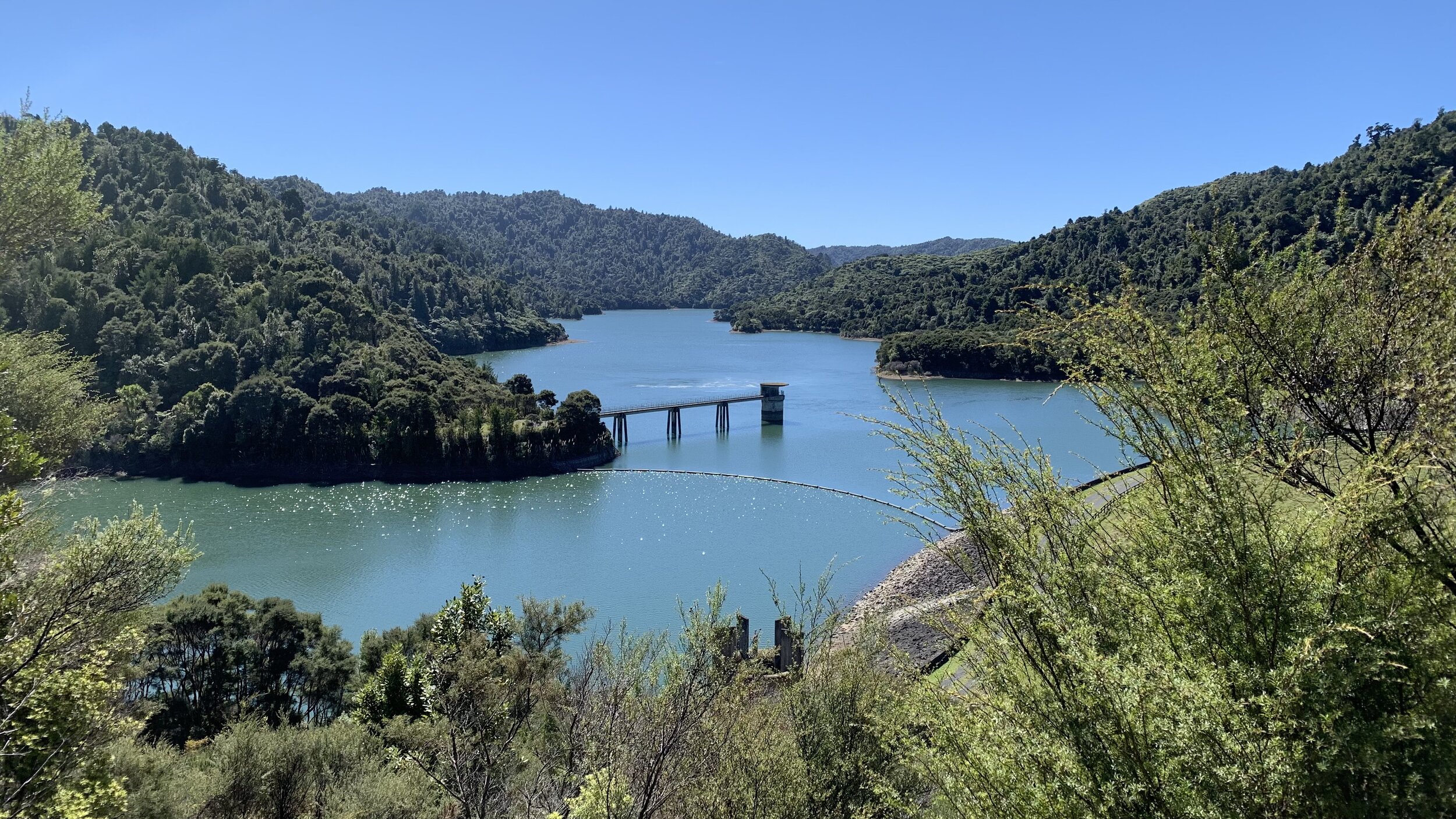

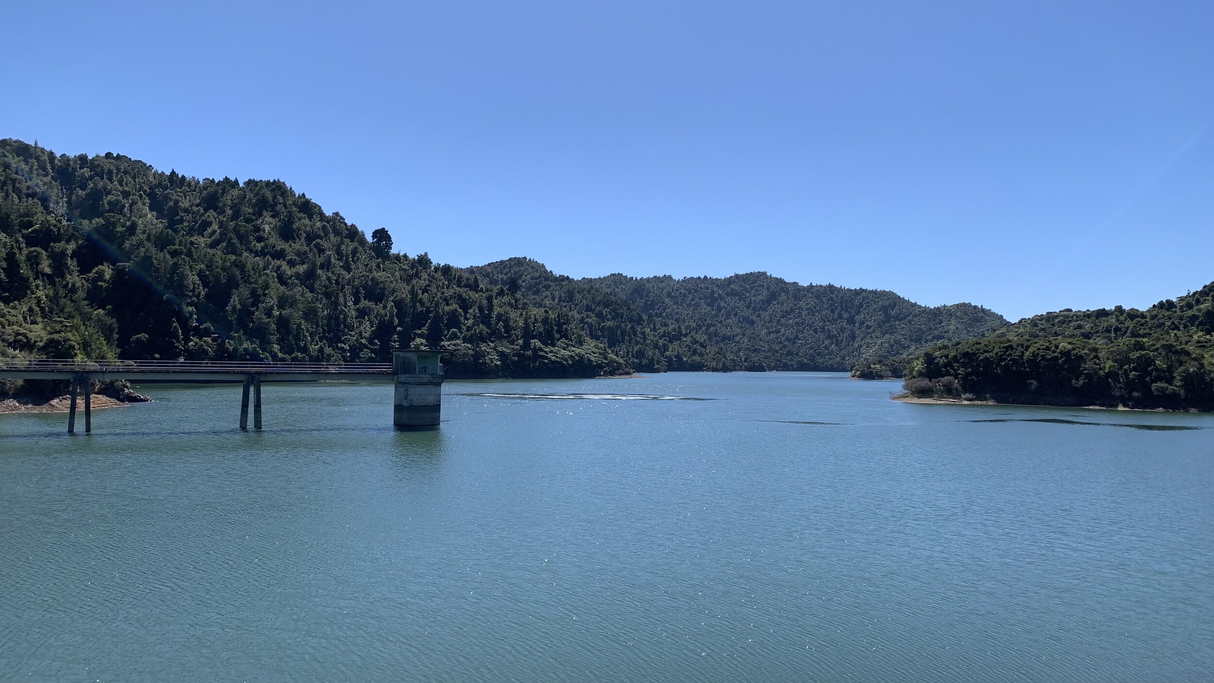

Curious- what kind of fish are in those waters?
Thanks for that .. not being born here I really do appreciate New Zealand… I’m very lucky to live here.
No fish in those waters as it’s part of a water treatment facility.

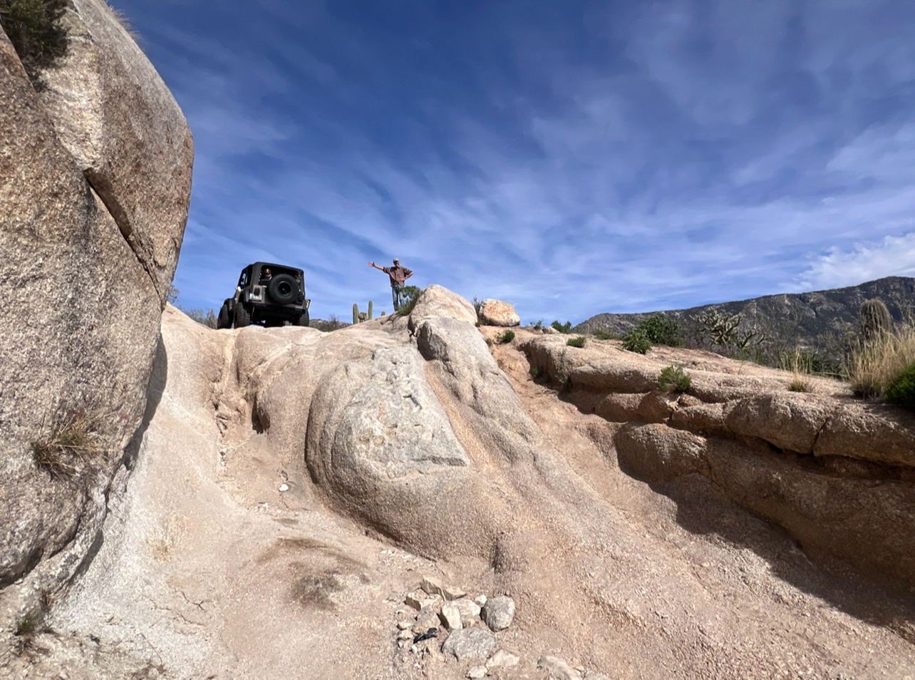

Got up kissing rock where I leaned the Jeep against the wall last summer. For fun, I tried to get over the boulders next to the drop off but didn’t make it.
