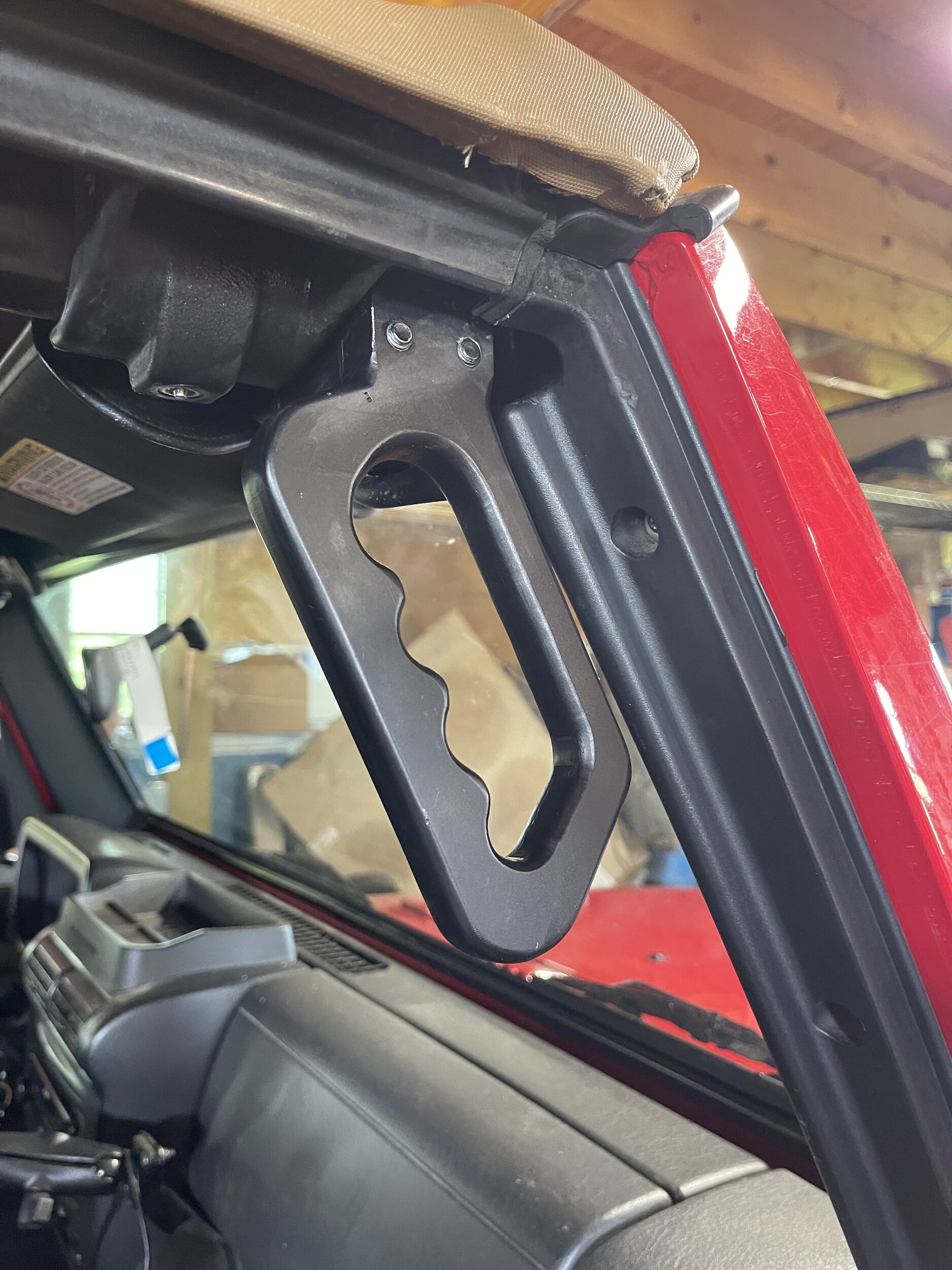

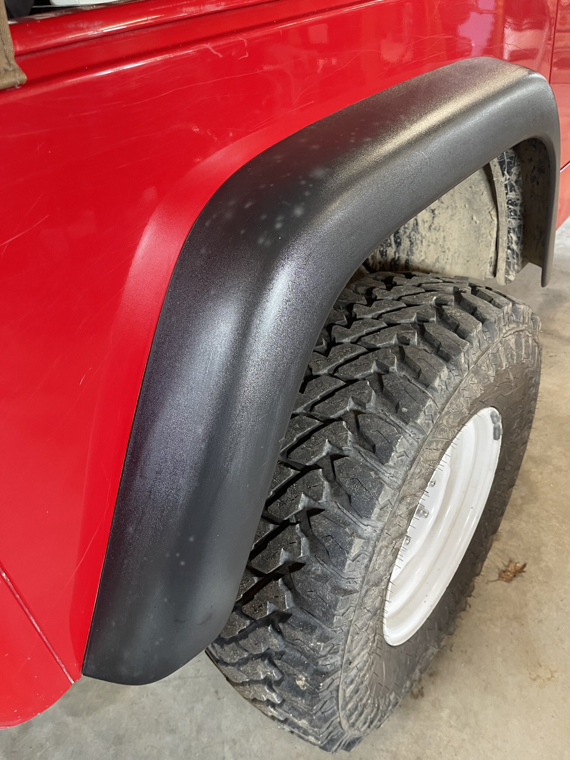

Made some grab handles and put some Cerakote on my fender flares.

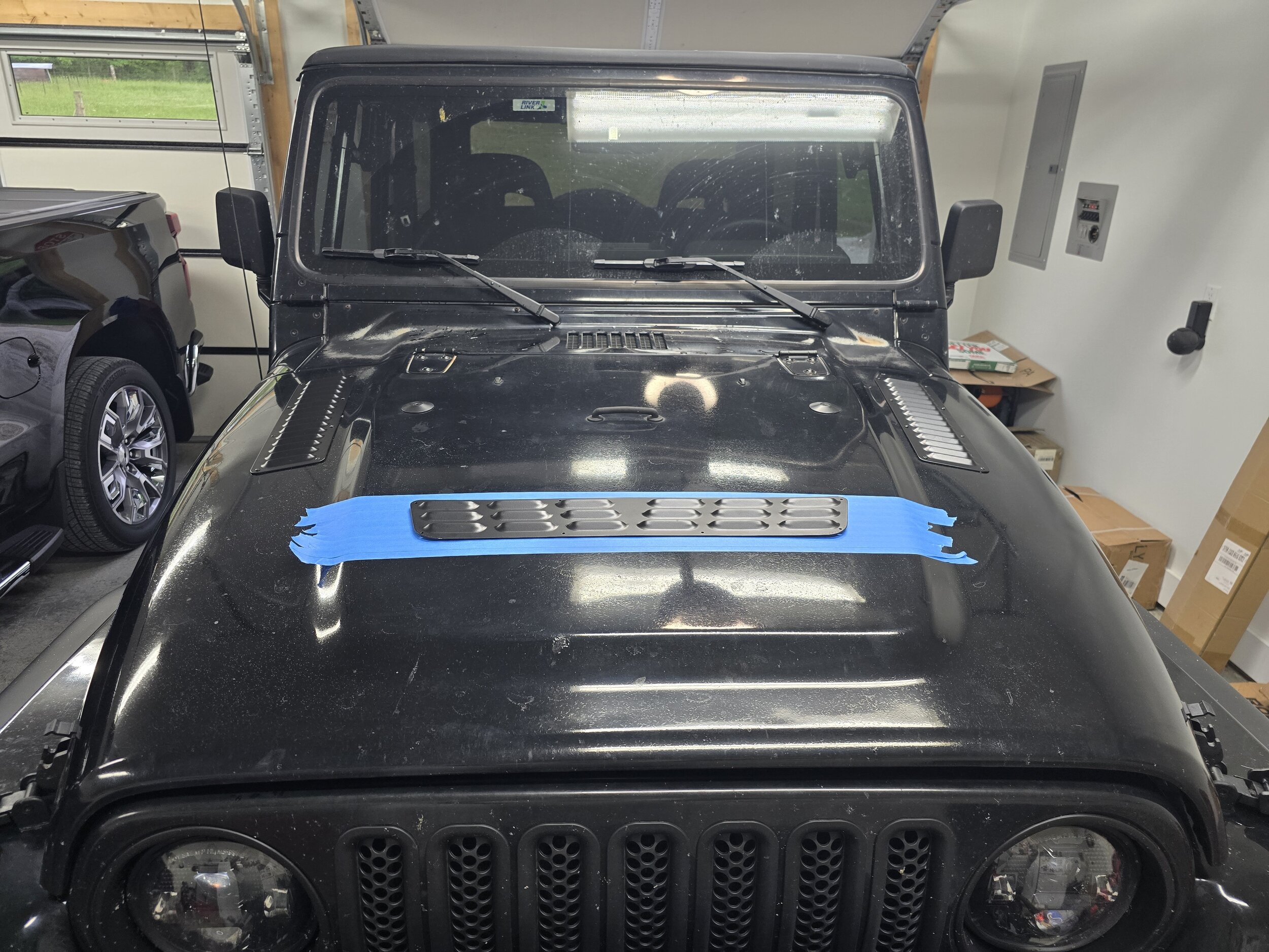

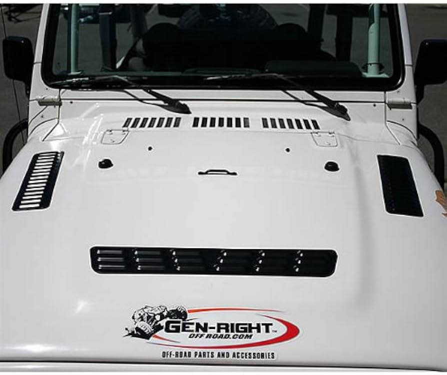

Trying to decide where exactly to put the front vent. The picture on my Jeep has the vent setting 1" behind the fan shroud. The one from Genright (white TJ) shows it a lot closer to the core support. In my mind, behind the fan shroud would be best so the air comes through the radiator and then put the vent.
Anyone have an opinion?
I think you need to be careful about water dripping on your alternator, ps pump, and a/c compressor. I know that they can get wet during normal usage, but I think they are not supposed to be drenched. Maybe you could get some small, 12VDC fans to mount under the vents to blow the air up?
I think it would take a direct spray into the back of the vents to drench anything on the front of the engine. That is something to think about too.
They get drenched during water crossings. 🤫
