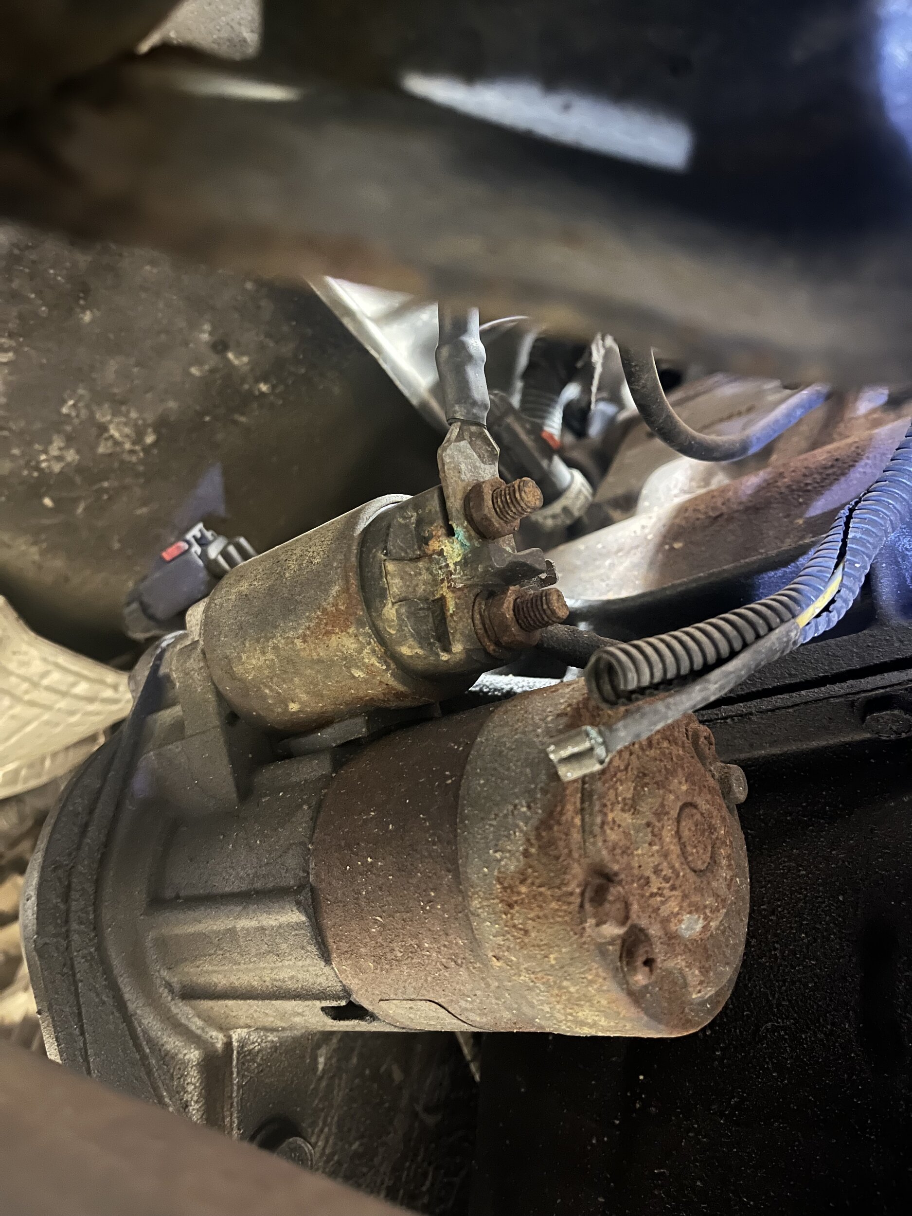

Well I had a good laugh today. My Jeep wouldn’t start and was exhibiting the signs of a broken ignition switch and/or ignition actuator, as detailed in this excellent video:
So I got the parts and swapped them out. Easy job, although it still wouldn’t start (and I miss the feel of the detents in the OEM switch; might need to put that back in!)
So I went to troubleshoot the starter and lo and behold, somehow the ignition control wire had popped right off its post! It was just dangling there as shown in the pic. So the starter wasn’t getting the signal to operate from the ignition.
I dont know how that happened but I squeezed it back on there with some pliers and she turned right over. Good one Jeep!! What shenanigans will you bring into my life next?!

Had that happen to me on my old sport. I replaced the starter and saw the wire hanging. Meant to fix it permanently, but sold it.
Stopped by the new owners and he wanted to know where I bought the starter, when I asked why I felt bad, got under Sport hooked the wire back up and told him how to permanently fix it.

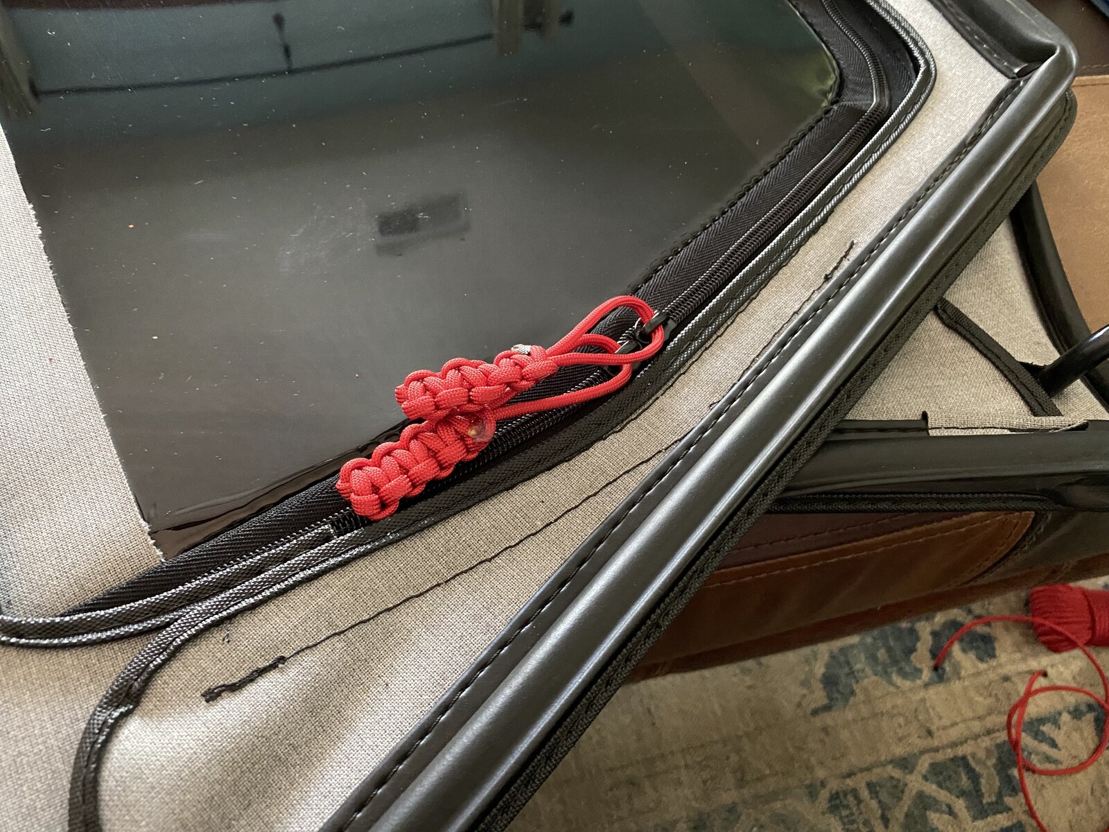

Everyone talks about how noisy the zipper pulls can be. They are, VERY! So I cut some 550 cord to make some zipper pull silencers. I used clip-on ends leftover from a previous project. No zipper rattle now.
On the first door I cut different lengths because I wanted to see what each looked like. The top one is 10" the bottom 12".

I went with 10" for the remaining pulls.
I added some 550 with similar ends but I cut the factory pull tab off and just threaded the 550 through the zipper body..

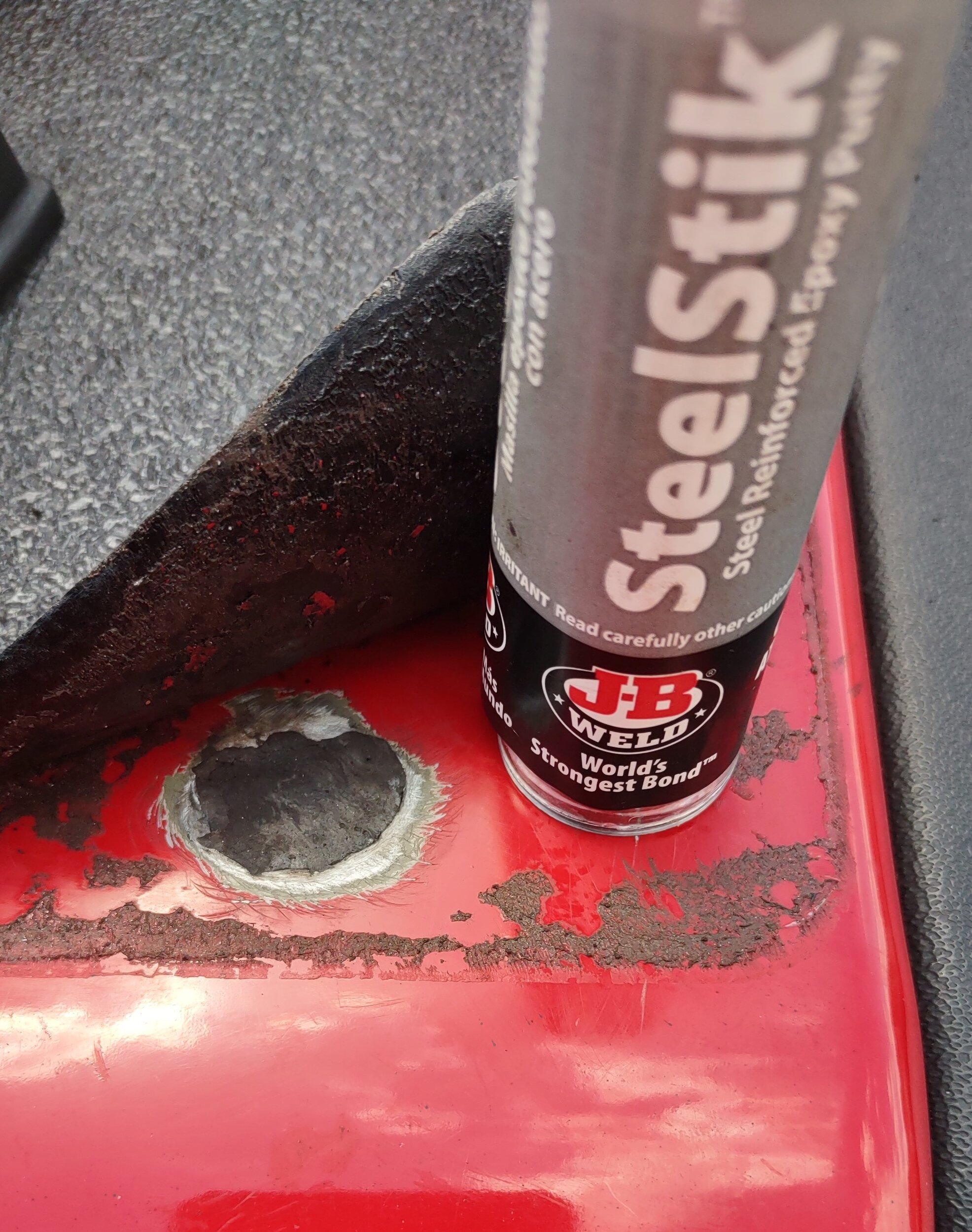

Fixed a rust spot under my fender "tool holder" today. I should have done it 5 years ago. I ground it down all the way through the fender to the metal brace underneath. The insulation was missing on this fender at the brace. It ended up being about the size of a finger tip when I was done. Filled it with some stuff I had laying around. Hopefully it works. Sand and paint after it completely dries.
