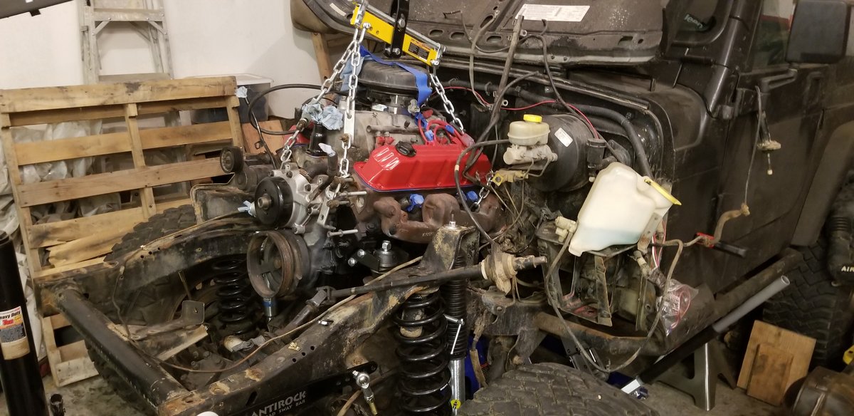

I like to keep things tidy. Nothing worse than rolling around on the creeper and getting stuck on random debris.
Usually I'm much better about it. But I was kinda forced into my engine swap because my 2.5 crapped out. So tearing everything down for that and accumulating parts for the V8 to go in. Plus a transmission swap, plus having to get parts to adapt that to the V8. Then I opted to do the rear axle because the Dana 35 has breakage issues with the 4.0, a V8 would guarantee to break it. Then I decided to do a new suspension while it was all tore out. Then sway bars. And the vortex continues. Plus I'm in the 3rd bay of my parent's garage since I don't have a garage at my place, so not tons of room to begin with.
Today I attempted to get the V8, transmission, and transfer case somewhat set into place. Hoping to have that finalized and begin welding the engine mounts in by the end of this week.
Sounds like you've quite the project going on. I've been there. I made it a point to do a cleanup and organizing at the end of each work period. I say work period because sometimes I've been known to go up to15hrs at a stretch. Enjoy your build.
I'm enjoying it, but ready to have it all done so I can enjoy it on the road and trails!! Sometimes my work sessions are only 30 mins at a time. So I'd spend just as much time cleaning up as I would working. Other times I'm able to spend 12+ hours on it. And those are the days I tidy up afterwards.
