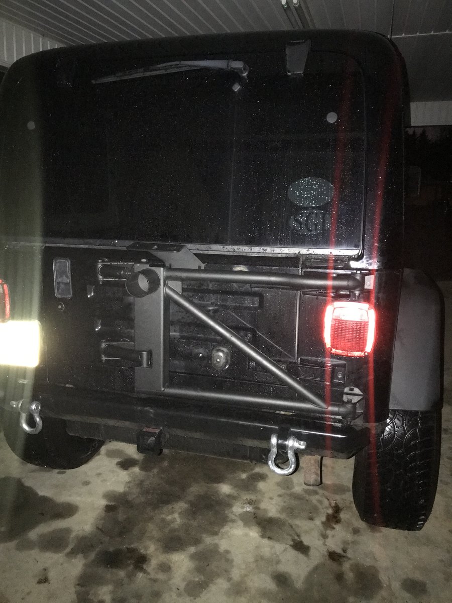

Finally installed my bestop tire carrier

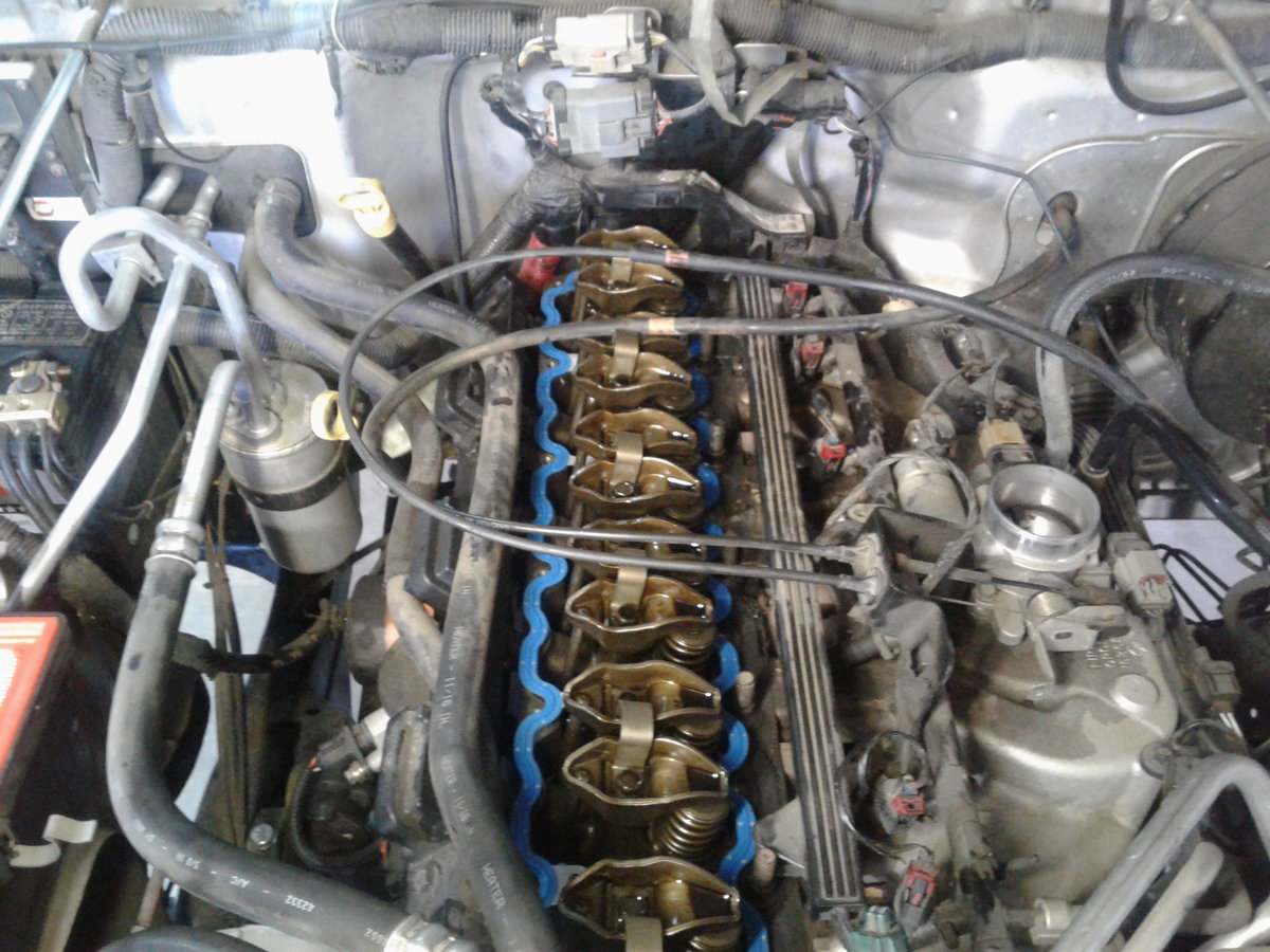

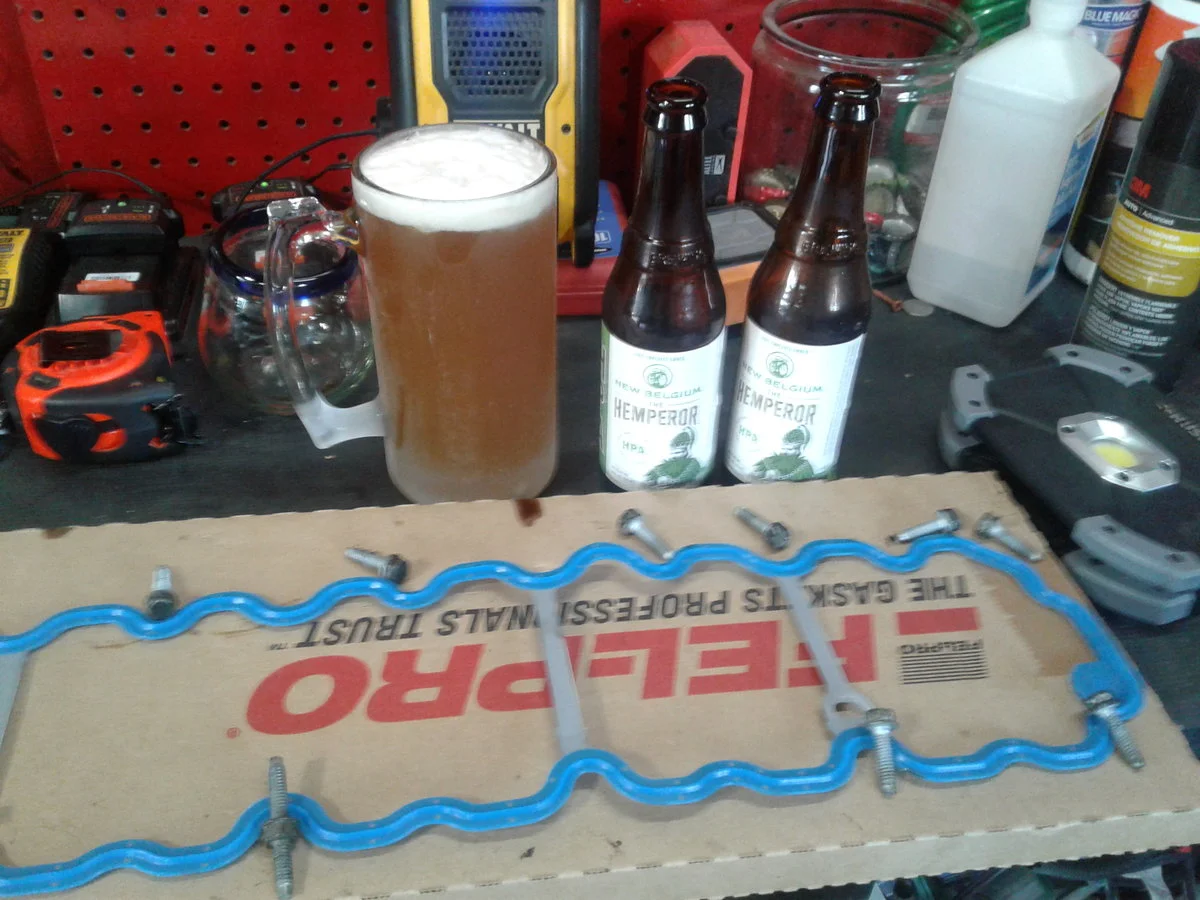

YEAH! Got the same gasket waiting for a nice day to install...How long did this one actually take ya?
It probably took 3 hours, start to finish. That was working slowly, taking my time and doing a lot of cleaning in and around the area. The wiring harness is a bit of a pain to get off and out of the way. It has 3 legs that it mounts on. I modified it and cut off 2 of the legs, so it will be much easier to get off and on in the future. The upper radiator hose, heater hoses, and AC lines are in the way, but you can work around them without removing or disconnecting them.

I found the wiring harness on the firewall end of the valve cover to be a huge pain in the ass in getting the valve cover off.
x2! I replaced mine a couple of weeks ago. Man, that wiring harness bridge will make a preacher cuss. I'm pretty sure I spent far more time fiddling and snatching on that than I did on the gasket replacement. By far the worst.

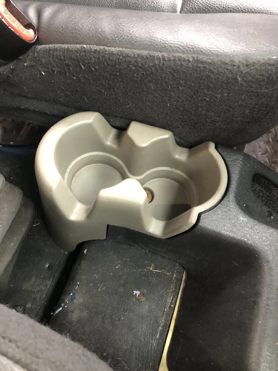

This looks like it might fit down into what you have and be a cheap fix to the cupholder problem. You could always get some SEM adhesion promoter and paint in your color and paint it to match.
https://rover.ebay.com/rover/1/711-...0001&campid=5337789113&icep_item=323884776758
Or this for a lot more, and you'd need the rubber sup holder insert too.
https://rover.ebay.com/rover/1/711-...0001&campid=5337789113&icep_item=123771298012
Tom, you rock!! I got the cup holder version and it’s perfect. It’s not the right color but I couldn’t care less. Best of all, now my wife is happy with the Jeep again. She can bring her Diet Coke with her, LOL!
Awesome! Happy wife, happy life!
SEM makes some good interior paint if you do decide to paint it to match.
Reactions: Kiwi TJ and Fonz54
Thanks, but I think it’s just fine the way it is. There’s something pretty about the ugly, if you know what I mean. I just showed it to my wife and she’s over the moon about it. $35 for her to have her cup holder? Yeah, she’s a happy camper. ;)
Thanks again. I owe you one.
