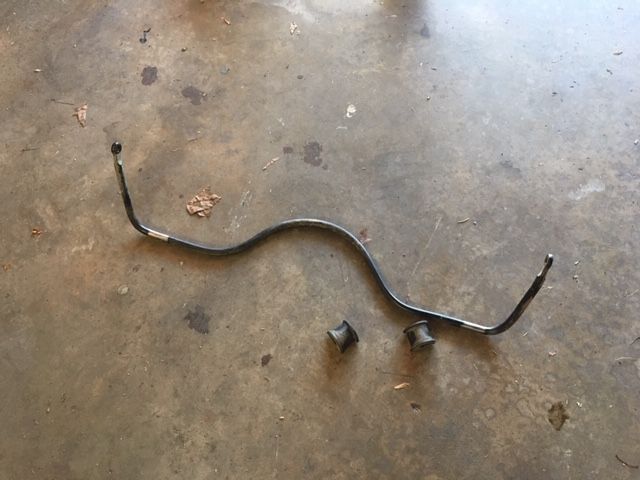

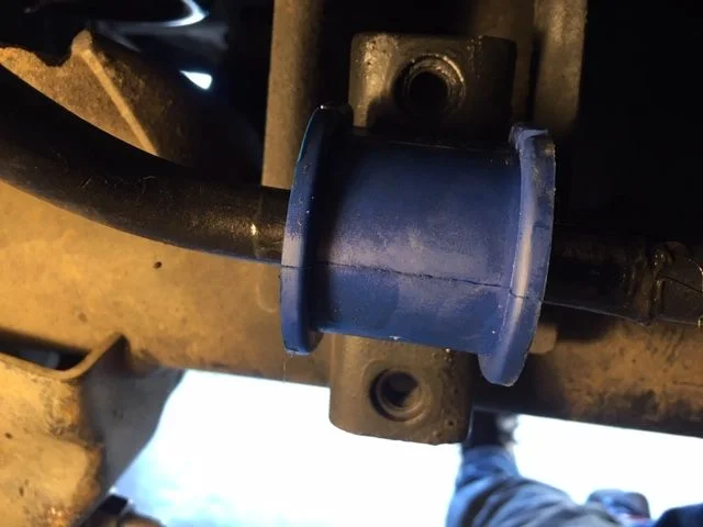

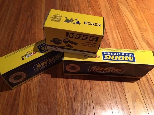

Took the TJ to my mechanic this week for its annual inspection & he pointed out that my rear sway bar links & bushings were shot, there was a ton of play going on. I had noticed this before but always ignored it, these bushings are probably the last part of the suspension that remained from the prior owner if not the factory.

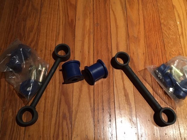

Picked up everything from Rock Auto, $48.00; ordered it Tuesday & it arrived Thursday, love that place:

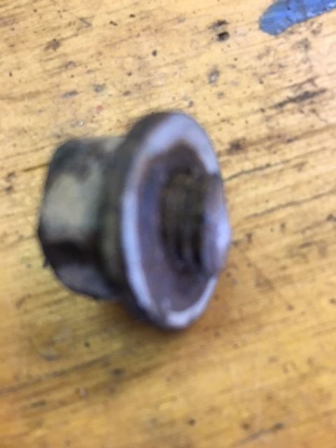

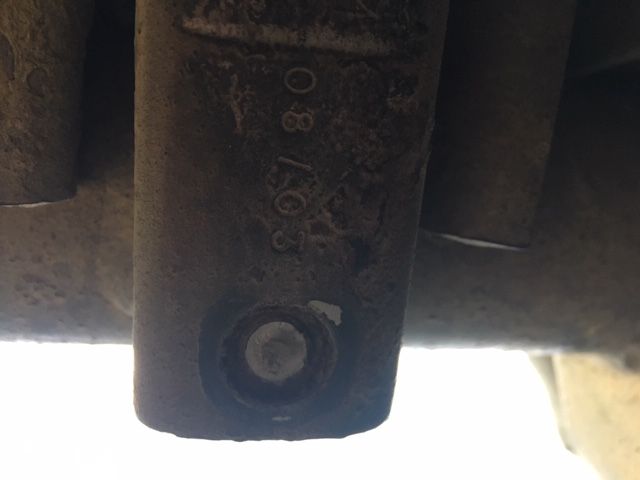

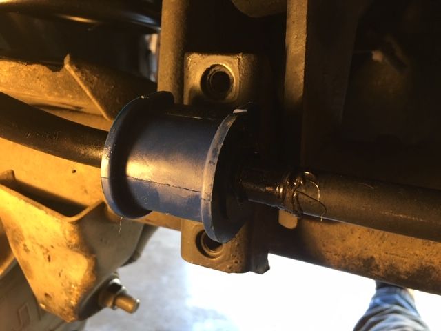

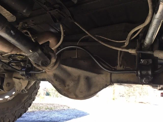

Saturday morning & time to "pop in the new parts". This started off as another “easy 30 minute job” that turned into a complete pain in the balls, there are a total of 8 bolts that have to be removed to pull the links & bushings out, 7 of which of course came out without an issue while 1 snapped the bolt head off leaving the rest of it completely intact. There is zero room to work the other end sticking out of the nut that’s welded to the mount so rather than making some lame attempt at getting this thing out (been there done that & it aint worth the agg), I tapped out & drove it over to my mechanic’s house & he coaxed it out.
Since I couldn’t finish right away I took the opportunity to clean up & paint the bar & the bushing brackets.
a couple hours later I Ubered over & picked up the rig, sans stuck bolt. One thing I noticed driving it there & back without the rear sway bar, I noticed zero difference. Wasn't sure if it was because the one on there was useless due to the worn bushings or they're just not all that useful. Anyway, I left it until this morning allowing the painted parts to dry. Went out about an hour ago & reassembled everything, new stock length links/bushings and new axle mount bushings:
Took it out for a test drive, felt great, maybe tighter in the rear, took some corners at speed & everything feels great; not sure if it's all in my head but it does feel tighter overall. This vehicle surprises me the longer I own it, it handles amazingly well. Maybe my expectations are low, I don't know, but I push it more & more the longer I drive it & it never gives me the feeling like it's going to let go. While I don't push it through turns as I do my Subaru I've gotta say it's not all that far off.
View attachment 141877View attachment 141878View attachment 141879

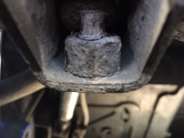

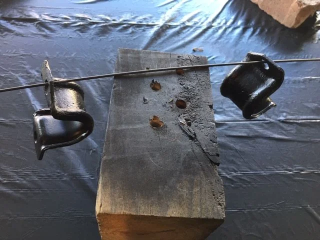

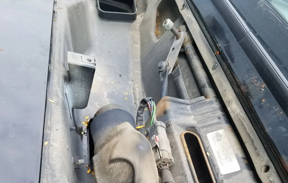

I went out to change the trans lube with Redline MT-90, but found the drivers side floor mat covered in water from the rain in Phoenix last night. So I pulled the cowling off to look for clogs. It looked okay but I cleaned it anyway
and replaced some stripped speed nuts, then I noticed the one of the POs removed the cabin air filter for some reason. Is that why we call them POs? Now I have to find one of those...

Do you have issues seeing out the rear view?
I went out to change the trans lube with Redline MT-90, but found the drivers side floor mat covered in water from the rain in Phoenix last night. So I pulled the cowling off to look for clogs. It looked okay but I cleaned it anyway View attachment 142060and replaced some stripped speed nuts, then I noticed the one of the POs removed the cabin air filter for some reason. Is that why we call them POs? Now I have to find one of those...
I didn't know we had a cabin air filter. Where does that go? And how do you check it?
I just opened my cowl an hour ago to clean the sand out from yesterday's run. I have a different plastic box inside than you do, but it doesn't have an air filter. I've owned my 2004 since 2007. Any idea where the big o-rings in the foreground of the cowl pic go?
