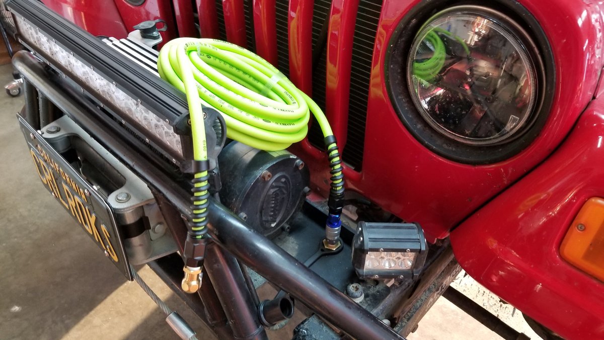

I did a thing. Mostly. Still have a little wiring left to do. I'll update my build thread tomorrow. Aired up my tires and it works great. The air lines hold air great but the hose/ coupler has a tiny leak and cycles the compressor after a few minutes, totally acceptable in my book.

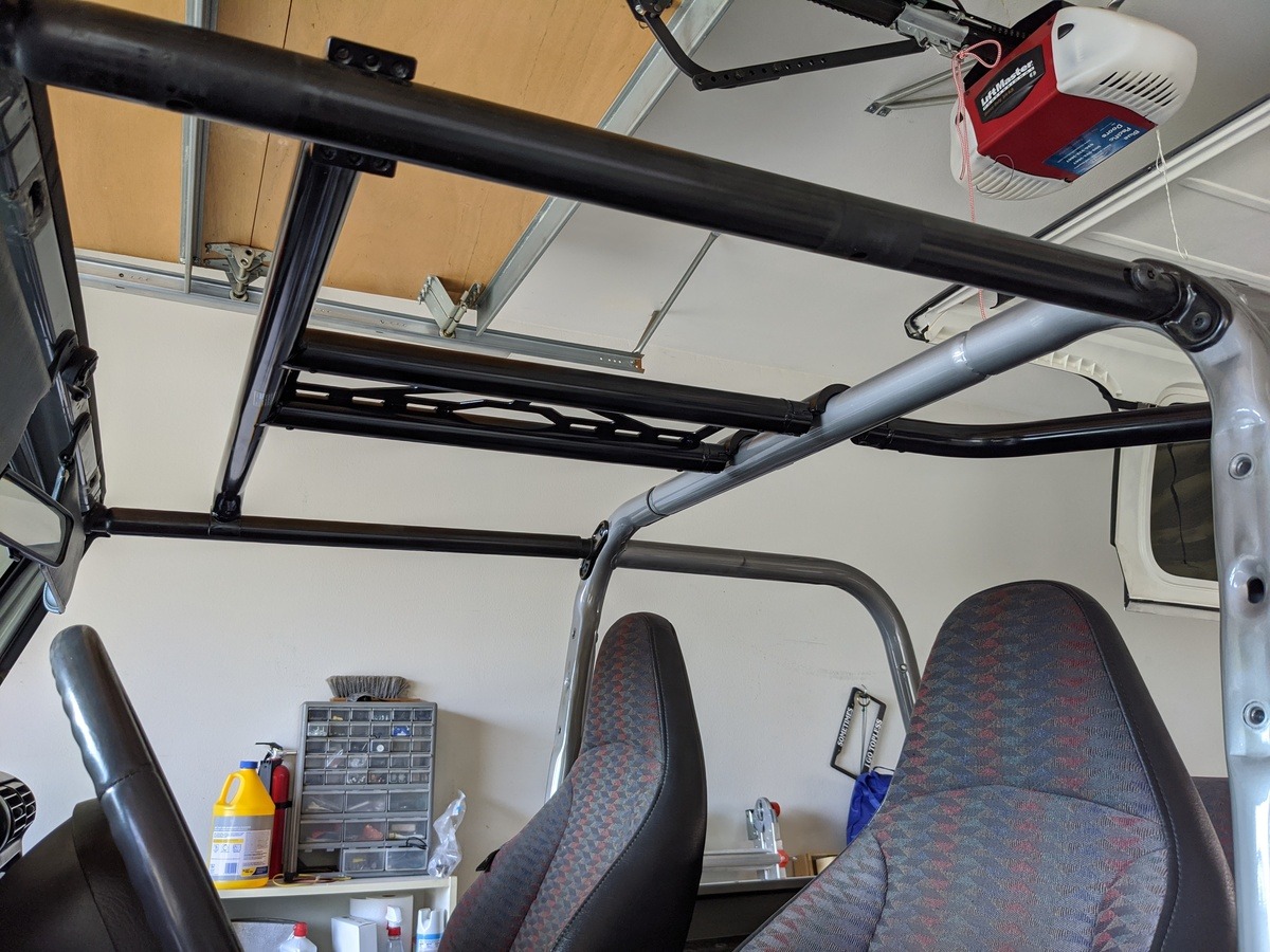

I installed the smittybilt bolt in roll cage reinforcement. I know smittybilt has a lot of haters. But when I received it I was pleasantly surprised with the quality (although the packaging had me worried about damage to the product.. thankfully it was fine). I can't complain after paying $567.16 for the kit on Amazon (it costs $1281 from ExtremeTerrain).
I laid in the first few pieces to help me decide where to cut into my soundbar. TJs with a soundbar require modification to fit the rear bars.
I used a mini sawzall and some aviation snips to cut the soundbar. I just rolled in the remaining metal since it was hard to get a flush cut.
The rest just took some finessing and squeezing with a ratchet strap to get everything lined up. Now it is in, feels like a huge improvement to the overall structural integrity of the cage. For $570 I'm happy.

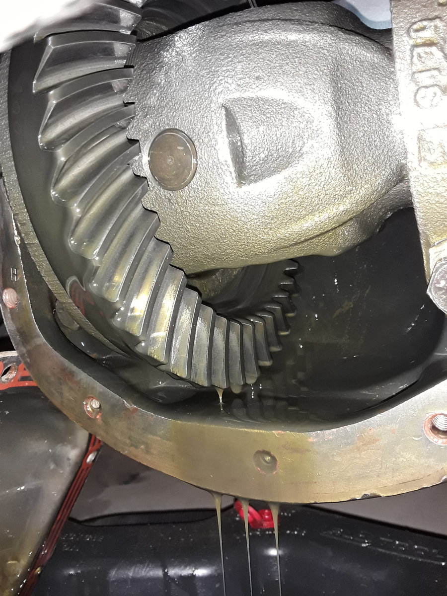

did my break-in gear oil change for the 4.56's I had installed back in August. I'm a couple hundred miles late, but the Jeep has been parked while I slowly worked through an SYE an hour at a time. There was less metal on the magnetic fill plugs than I expected.
It's the first time I've ever drained 85W140...holy moly that stuff is thick. No wonder it takes so long to squeeze it out of the bottle. Being in the 40s in my garage didn't help, I'm sure. It was everything I could do not to spray it out with brake cleaner, but the FSM is pretty clear about not using solvents like gasoline or kerosene so I flushed it out with some 5W40 I had left from a European car I sold awhile back.
