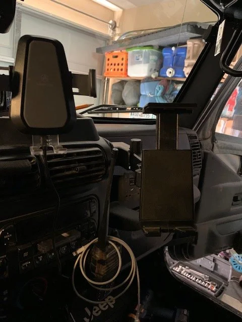

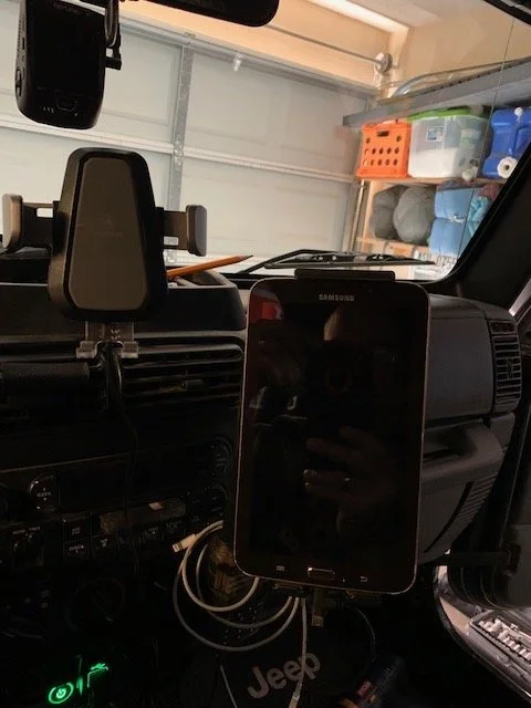

Will today I received my wireless charger and it came with a bracket so I used the bracket to hold my tablet makes it easier to see the map while I'm on the trails.

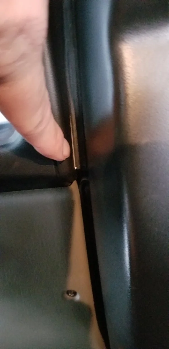

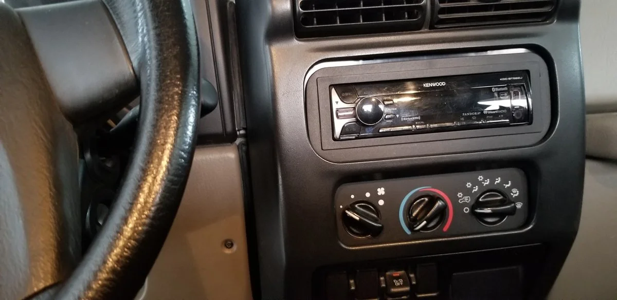

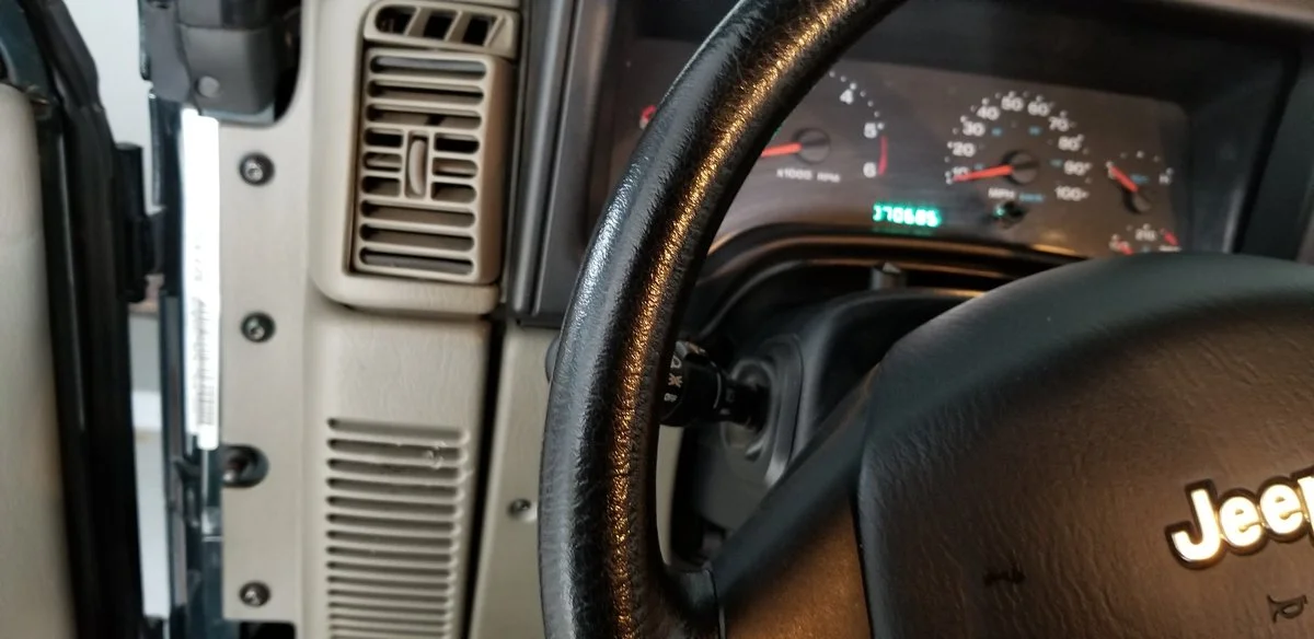

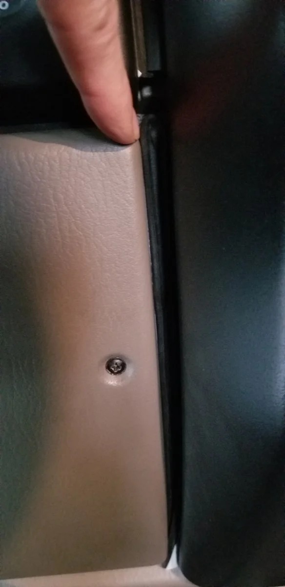

Got tired of putting up with the incessant squeaking dash. All the screws that attach the panels are present and they're nice and snug, but the dash squeaks constantly. I tried lubricating all points of contact, and that stopped the noise for a day or two, but it came right back.
It seems like the panels just need to be a bit tighter because if even a tiny bit of pressure is applied to the dash while driving, the squeaks disappear.

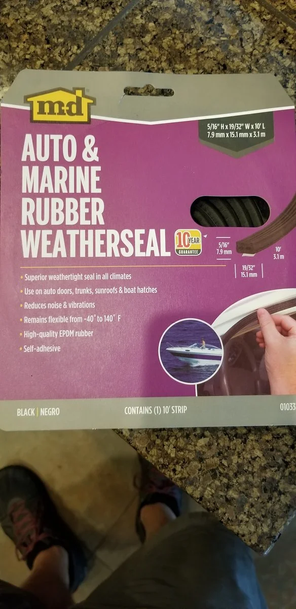

Last weekend I grabbed some auto and marine weatherstrip, cut a couple pieces to size, and wedged two widths of the stuff between the dash panels on either side of the instrument cluster.
One week and a couple hundred miles later and no squeaks yet. Best $3.88 I've spent in a long time!

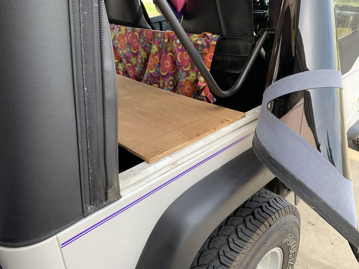

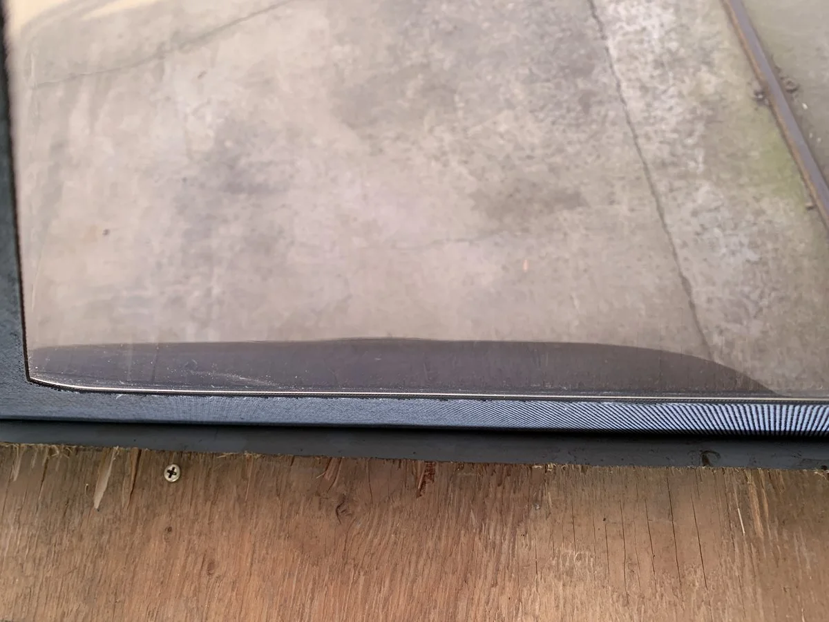

Made me a platform so I can throw my uppers in the back and still be able to pull my drawer in and out. :D
Not the prettiest but the cheapest. Just took a old piece of plywood we had laying around and cut it to fit. Then drilled 2 small holes in it and put a couple screws to keep it from sliding around. The screws just go through the hole that is already in the tub. Figured this way I could always just lift it back out easily.
Someday I want to make a better one that covers the whole back, but for now this will do. Needed something fast because I'm going offroad tomorrow and may want to take the uppers off while we are out there. :D
I'm hoping I left enough space so when the windows suck in, the sides won't hit the plywood.

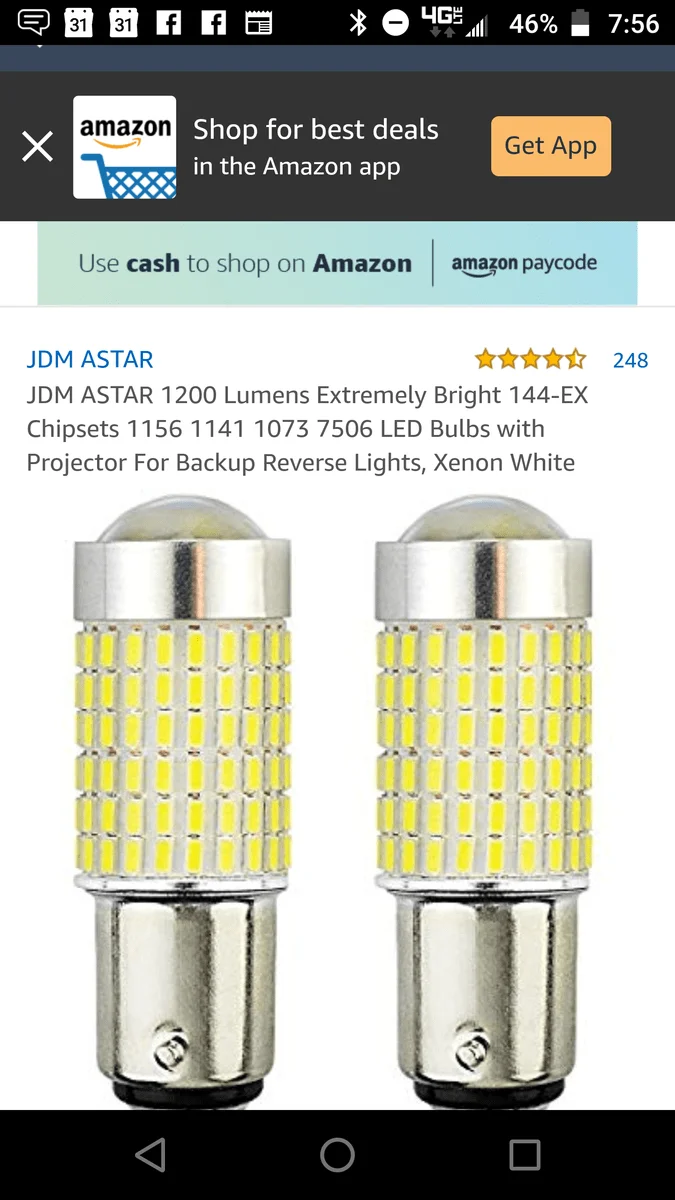

I got some 1200 lumen 1156 type rear back up light bulbs off amazon ..holy cow . Each bulb has about 130 leds plus the end is illuminated so it shoots straight back.

Got a link to the bulbs??
