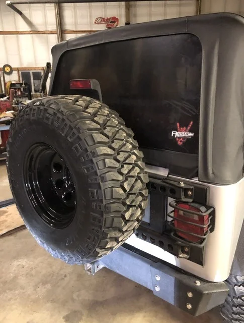

If you zoom in at the first pic. You can see the blue wire tap in line with the OE red power wire to the stock light. I tapped into the red wire and bolted the ground on the hood bumper bolt you see on the hood itself.
No fuse or battery cable was removed other than the physical oe light. Easy mod.

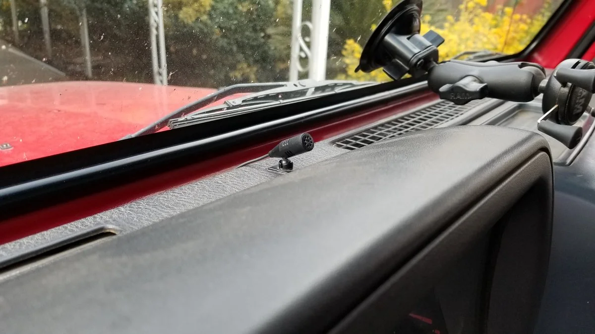

Finished up my air compressor install with the switch, added some poly fill behind the front speakers, and installed the mic for my head unit I left out originally. Also rescued my wife and sister in law who went out for a hike and overheated her Toyota Sequoia. Poor thing was out of coolant.
Airing back up is going to be so much nicer now.

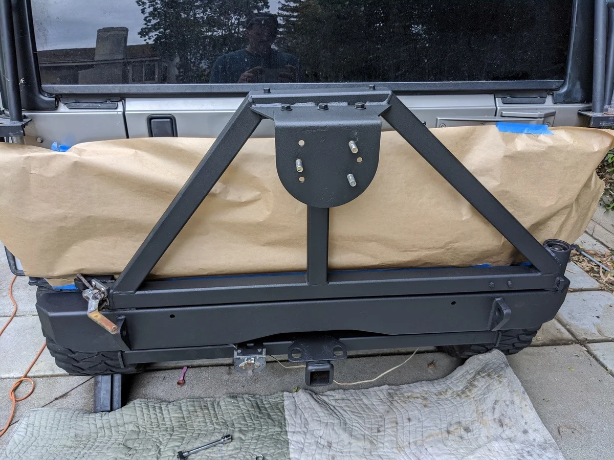

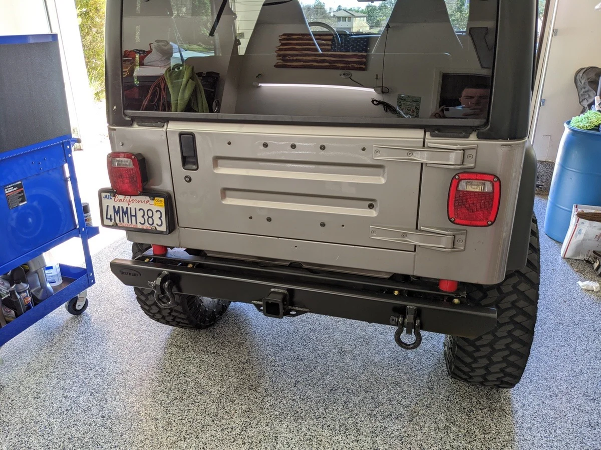

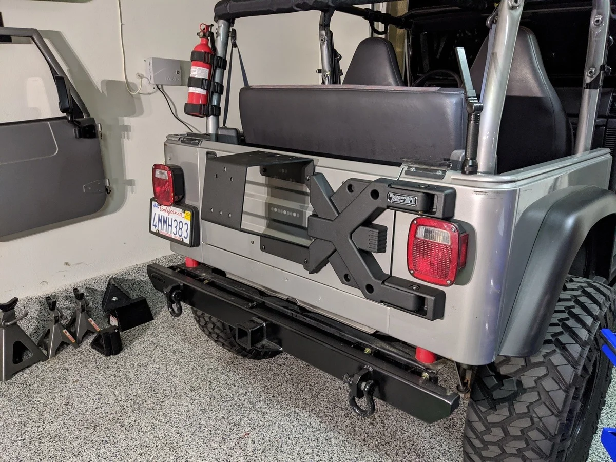

Today I installed the Rugged Ridge Sparticus Tire Carrier. It consists of replacement hinges for the tailgate and a beefy steel mounting plate to replace the factory one.
When I bought my TJ, it had a cheap tire carrier bumper from amazon. I am not a fan of tire carrier bumpers because of the extra work required to access the trunk. Even so, I initially repainted the bumper because I though I'd keep it, shown below.
But that didn't last long. Recently I changed the bumper out for a Dirtworx bumper I rattle canned. I ran the Jeep without a tire carrier for a while like below. Love the Dirtworx bumper (haven't really used it yet though). I like that it has additional bolts in the rear crossmember.
A lot of people on this forum recommend the Exogate for a door mounted tire carrier. The Exogate uses the factory tire carrier, which I didn't have. I'm also not really a fan of how it looks. For the same price, I found the Rugged Ridge Sparticus, which includes a tire carrier. I decided to go that route because I like how it looks and reviews suggested it was pretty well made. I got the tire carrier today while I was replacing my leaking trans pan gasket. Once I wrapped that up I started work on the tire carrier.
That's when the nightmare began.

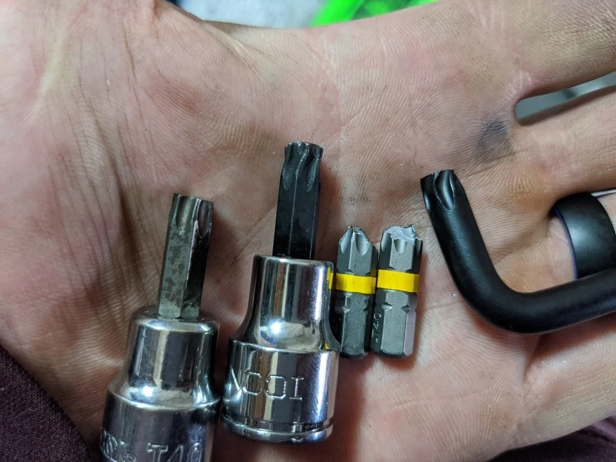

The torx bolts holding down the factory hinges are practically welded to the door. There is some chemical process that occurs between the bolt head and the countersunk surface of the hinge (outlined by another member here) which seizes the bolt head. I basically destroyed every torx head that I had, then went to home depot and bought some impact torx bits, broke both of those with my 1/4" impact and still had 2 of 6 bolts left to remove. I went back to home depot and bought a hardened 5/16ths drill bit and drilled out the bolts. What a headache. The picture below gives you a good idea. With the heads of the bolts removed, the shaft was easily removed with pliers. The head of the bolt is the part that seizes.

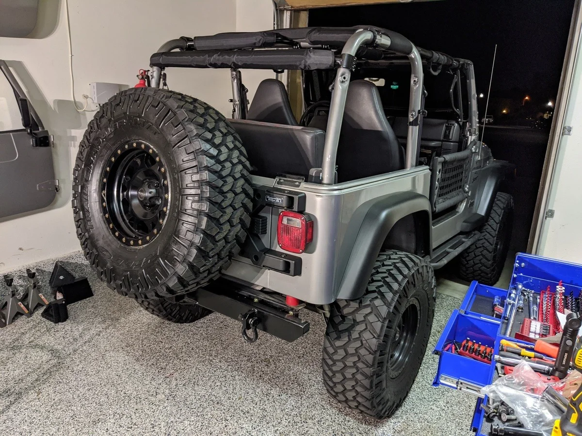

ANYWAYS, once I finally got them out, the hinges and carrier installed with ease. Below you can see it installed without the tire.
And with the tire.
I think it looks SWEET. I am super happy with how it looks and I'm happy to have it installed as things were looking pretty grim earlier in the day. I will be heading back to Harbor Freight to replace my ICON Torx Sockets. Interestingly enough, the ICON socket didn't shear, but bent. I guess it's softer, not sure if I applied more or less torque with it before failure compared to the other stuff.
